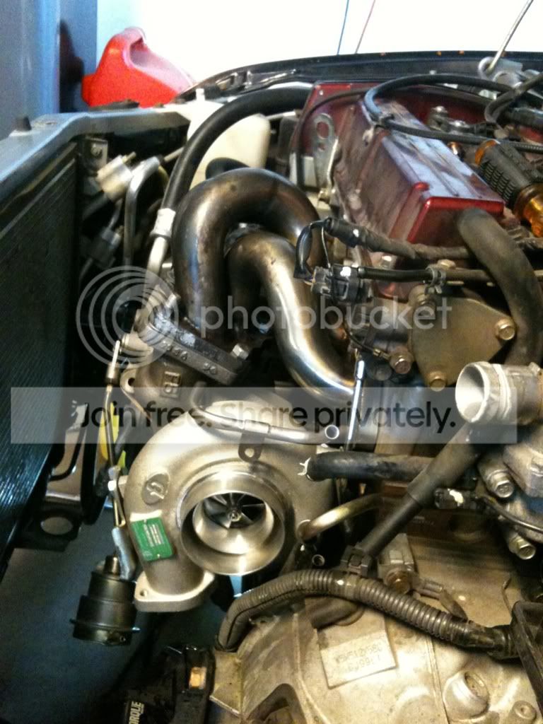

i started modding it quickly as i added injectors, mbc and wally and e85. made 350/380 at 30psi. i kept it like that for about a year when my pump went out and started throwing around the idea of making more power. i decided to go with this setup.
August 2011
125k miles
original stock block(did a compression test today and it was 160 150 160 160)
original stock clutch
fp 73hta green 84mm cover
fp 25psi wg
gsc s2 cams with arp hs
map o2 dump
ebay tubular manifold
fic 1450 injectors
dw 300 fuel pump
omni 4 bar map and iat with spoolin up pnp harness
upper and lower intercooler piping
agp fmic
65mm mil.spec throttle body
spoolin up cop

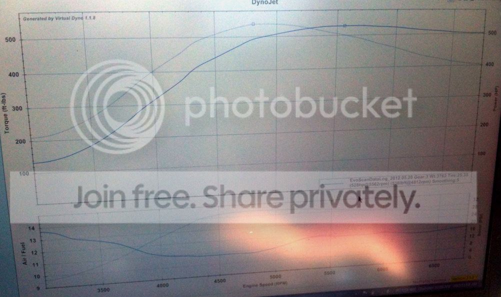

tuned on speed density by phoung at Wingz Performance
30psi on E85
104 degrees, 5% correction, smoothing 0
the red is at 32psi
the green is at 40psi- over boosted due to mbc error

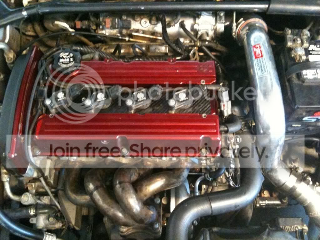

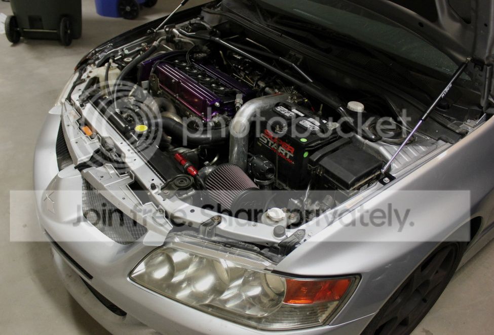

so the build began! i decided to go with a 2.3 as i want the heart of a evo but with a twist.
March 2012
2.3l 9.0:1
wiseco pistons .020 over
eagle rods
oem 4g64 crank
acl bearings
exedy twin disc
arp l19 headstuds
egr block off plate
ferrea +1mm oversized valves
kiggly springs and retainers
ported intake mani
ported hotside
wingz double pumper with dw300 and wally 255 as back up

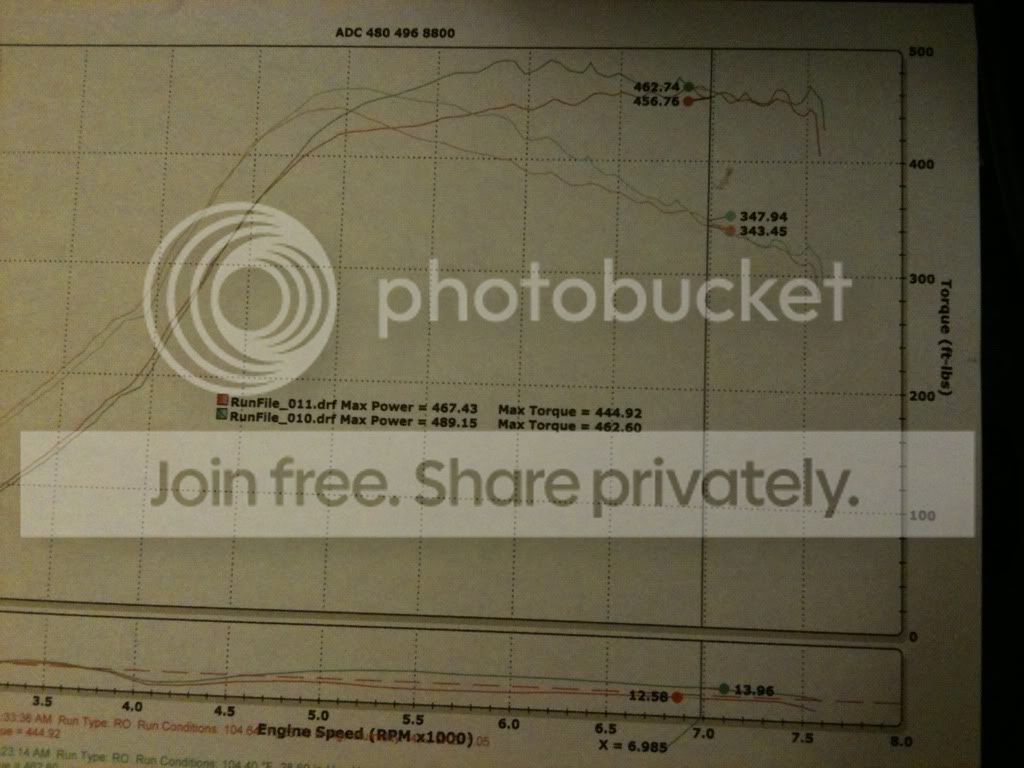

32psi on e85
32psi and dropping to 28 by redline.
took the car to the track and the first time launching it last summer. Aug 2012
Took the car to speedworld again in october 2012 where i ran a little faster at 11.7 @124. Also dynoed the week after where i put down 495/483 at 32psi. Id say 2012 was good and cant wait to see what this year has in store!!

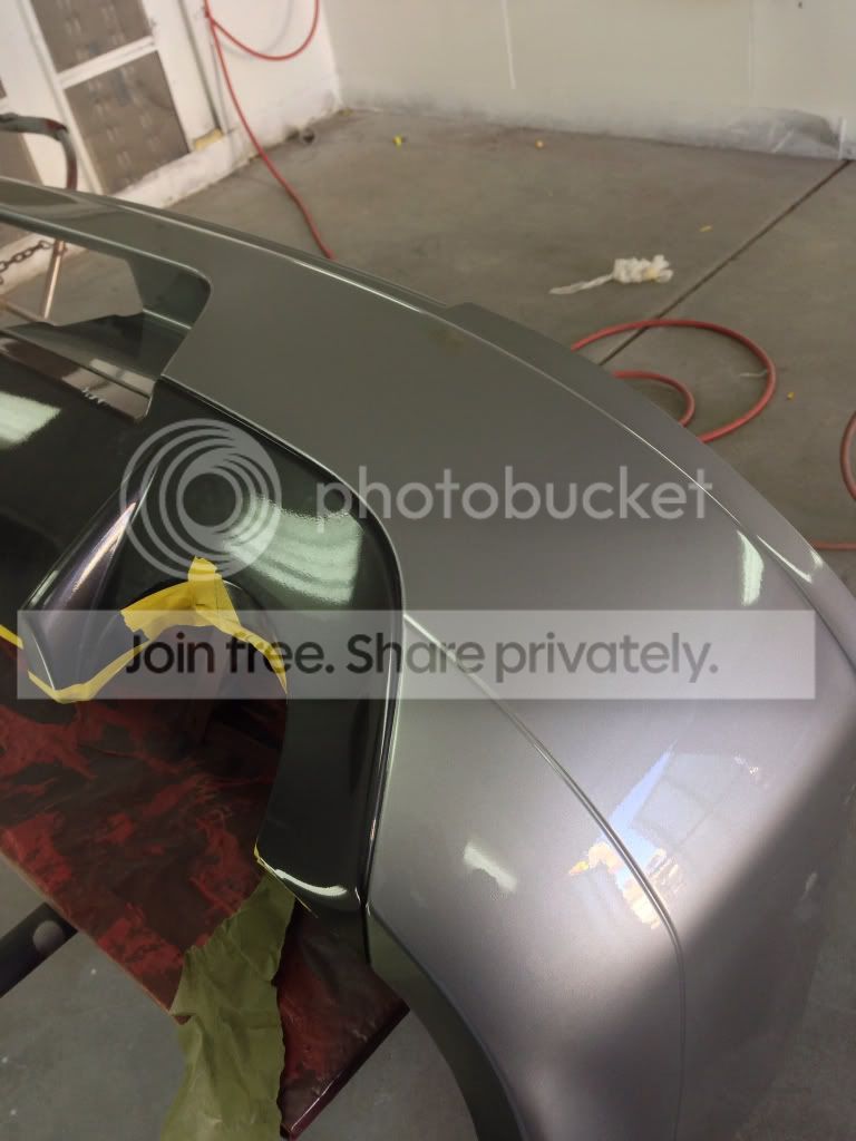

Jan 2013 i finally had the car painted and body work done.
The color ill be going with is a mixture of a bunch of silvers. Car will get a few coats of paint and plenty coats of clear. The pic doesnt do justice of the color

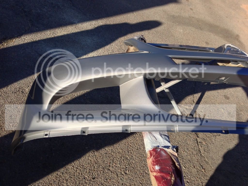

during the painting
decided to put the works on silver car.

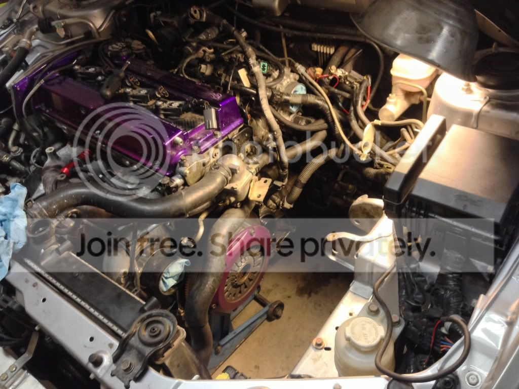

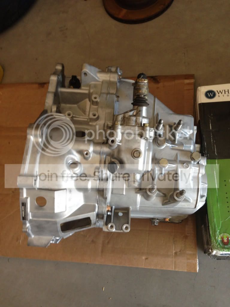

well the last time i was at the track( back in oct) i started having problems with my clutch not wanting to go into first or reverse and couldn't figure out why so i started pullling the car apart in prep of ugrading a lot of things. Never found out why either
tranny was rebuilt
Qm race 8 leg with street version flywheel

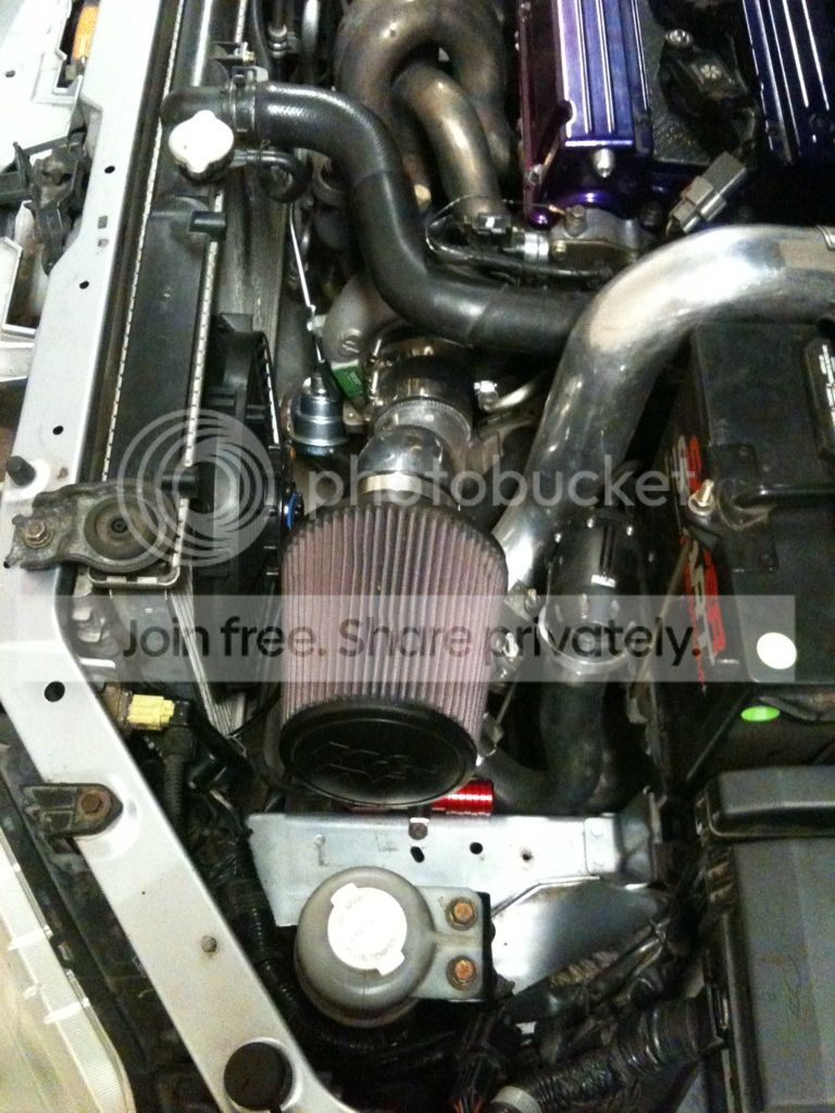

Finally removed egr, evap, fpr soleniod and cleaned up intake manifold
Bought some braided sleeving to clean up the engine bay along with snap on injector connectors

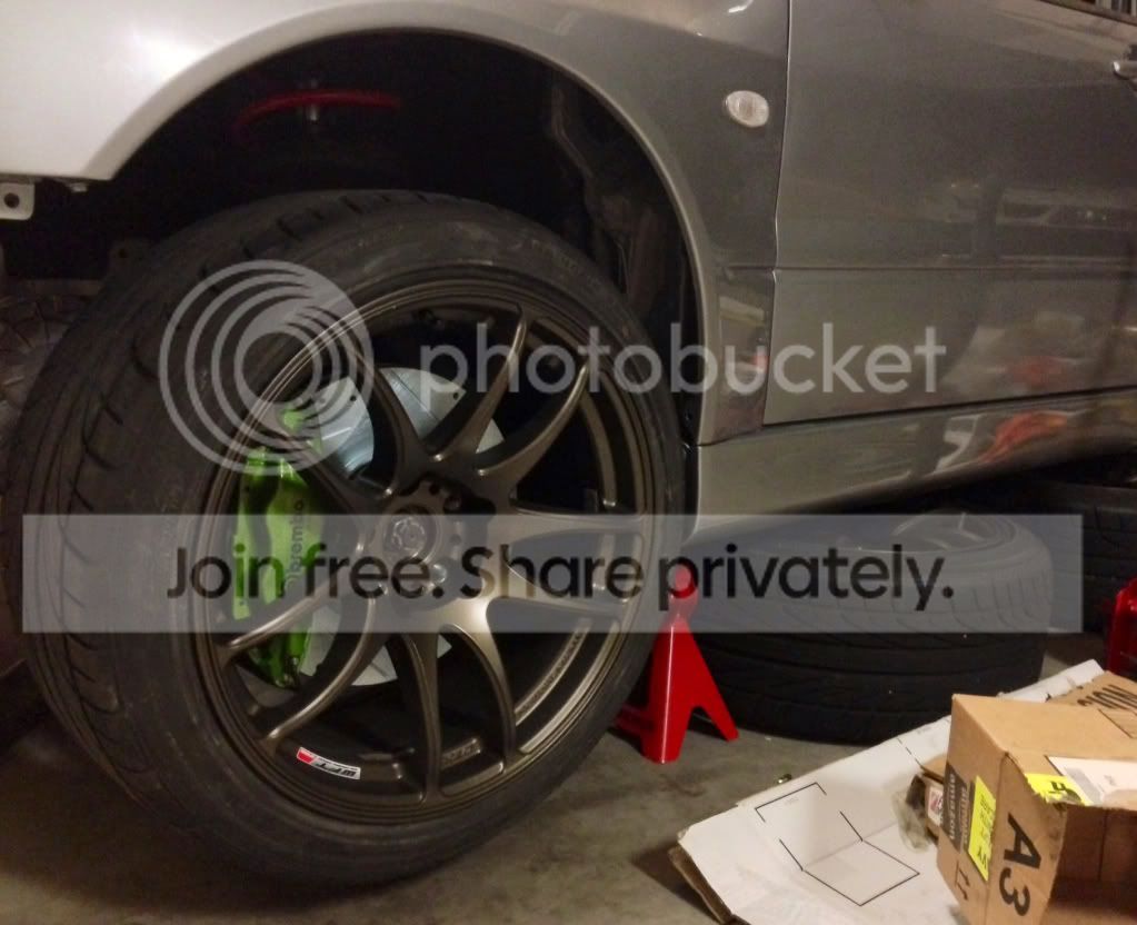

New brakes along with powdercoating calipers(new dustboots and seals also) and valve cover golden granny smith

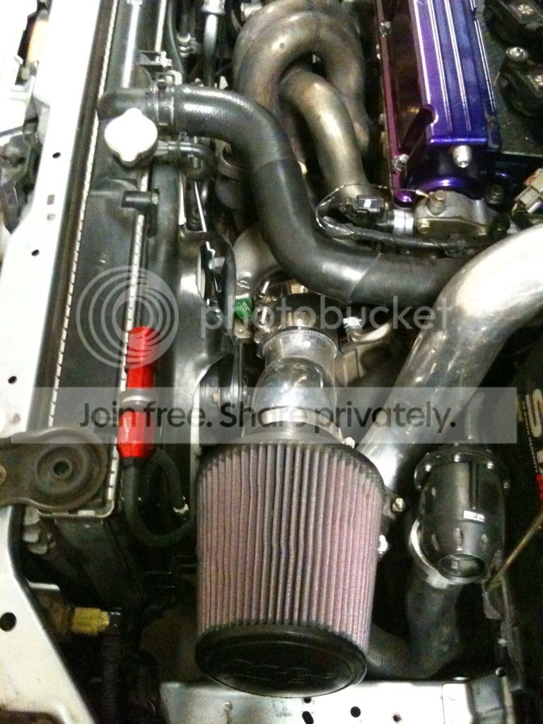

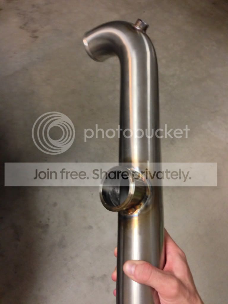

Got my ets pipe welded along with my new tial bov thanks to jdl auto design!
April 2013 this is how the car sits as of now. i have everything to put it back together, just been slow as i had soulder surgery so i can only do so much at a time. i hope to have it running in 2 weeks and then i'll be heading to the track to hopefully break into the 10's.

Just need to connect the harness, install brakes, put the radiator and piping back on and should have it fired up this week. Waiting on my catch can still.

Clutch is loud and chatters worse than a exedy but i am really liking the hydraulic throw out bearing on it. Pedal feels like stock and is very streetable besides the noise. We'll see how it holds at the track. Not much to say on the tranny yet.

well i've put well over 500 miles on the new tranny and clutch. today we had a dyno day and i got the chance to strap it down to see where the car was at. results were impressive as my last dyno which is i have to compare with was in the low 80's. today it was 107 so i had a huge leak somewhere and most likely was from my hks bov. this was on the same tune and same boost level. only thing changed was leaning out afr's as it was really rich on the first few pulls.
