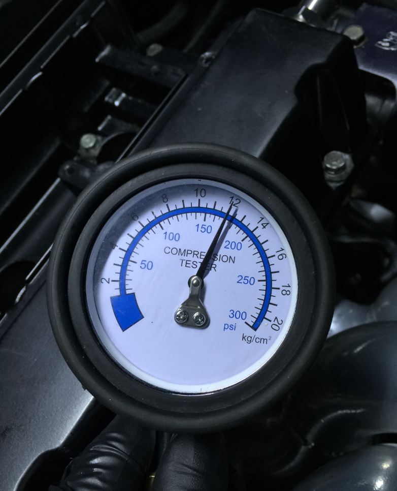

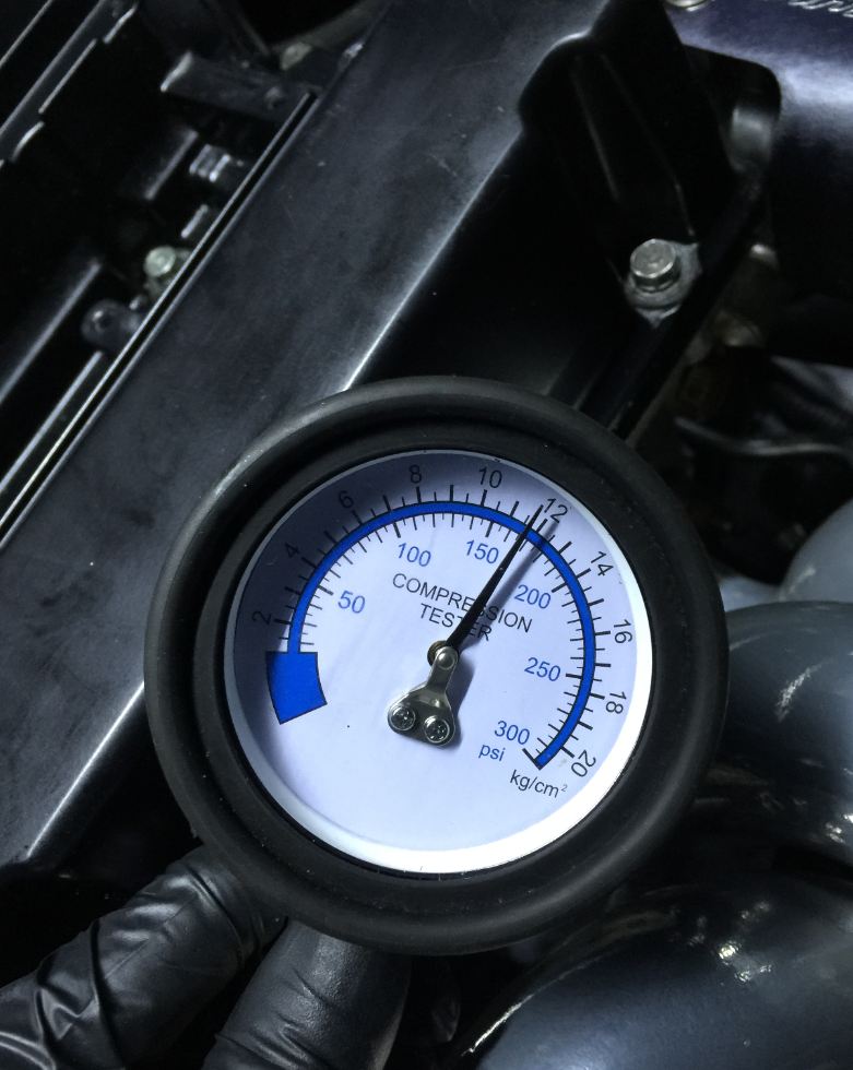

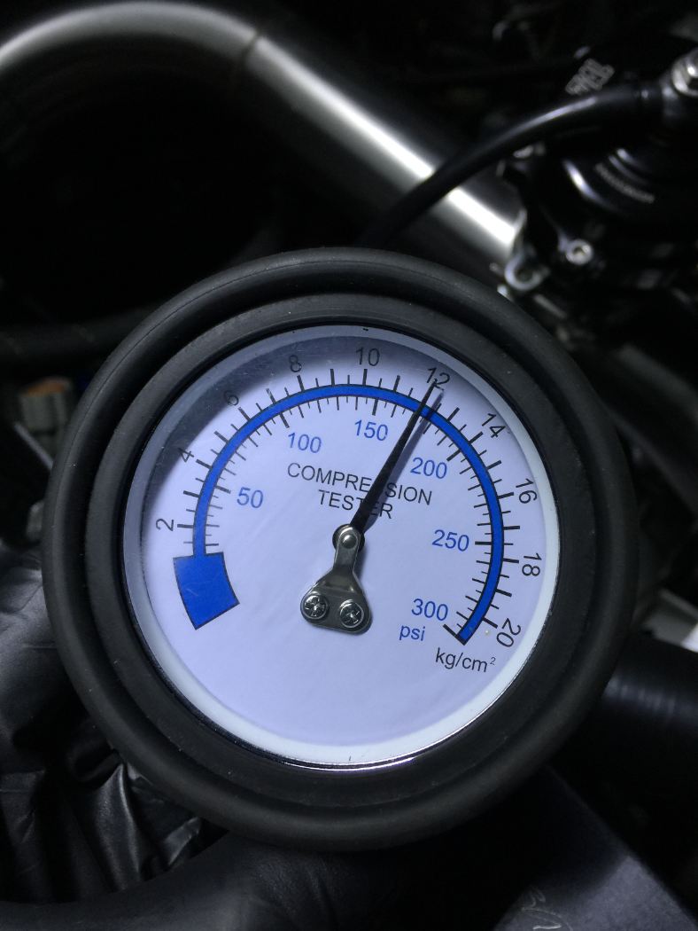

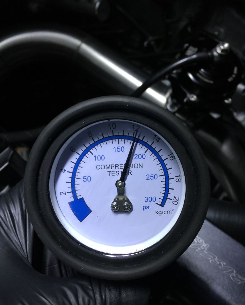

Now I have blew out my spark. Hopefully new plugs fix it or I guess its time for a CDI box. I didnt think the non CDI would ever give me trouble based on how long I've had it and how well its been all these years. I never had misfire issues since the day I bought this product.
Having blowing out spark / misfiring motivated me to check the compression also since I was pulling the plugs anyways.
Compression was really good, better then I expected honestly from a very cold engine sitting in 45F.
Heres what it was:
cyl1
cyl2
cyl3
cyl4
