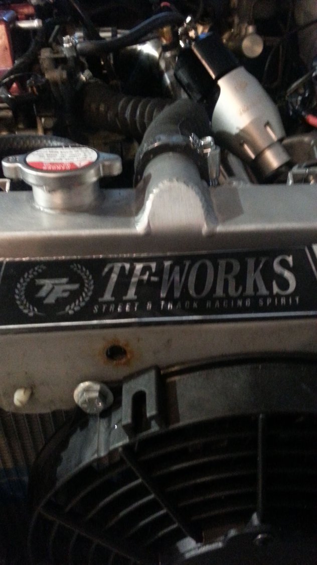

I will be putting in the koyo rad tomorrow.

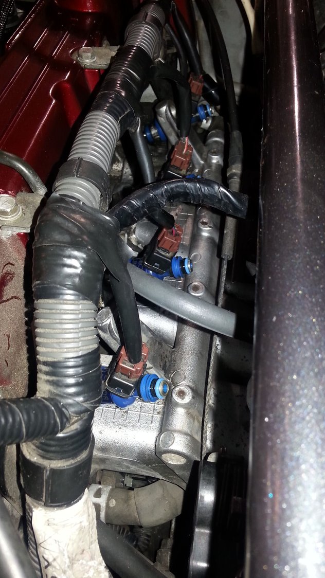

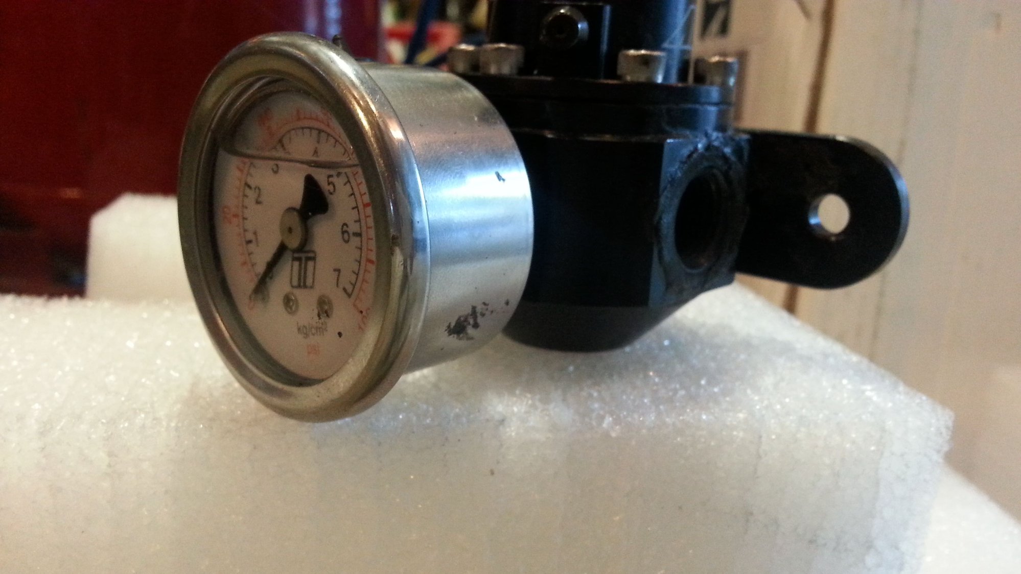

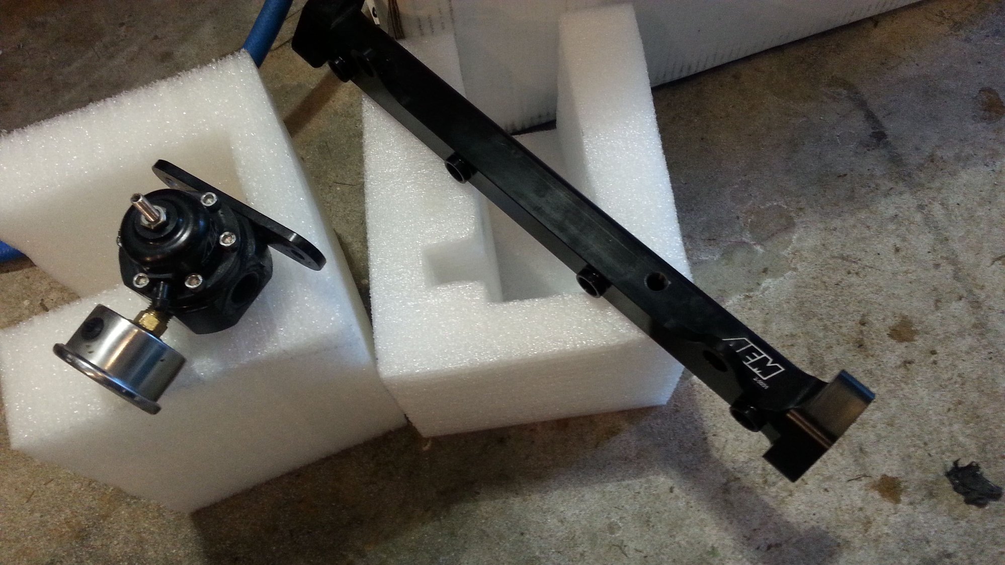

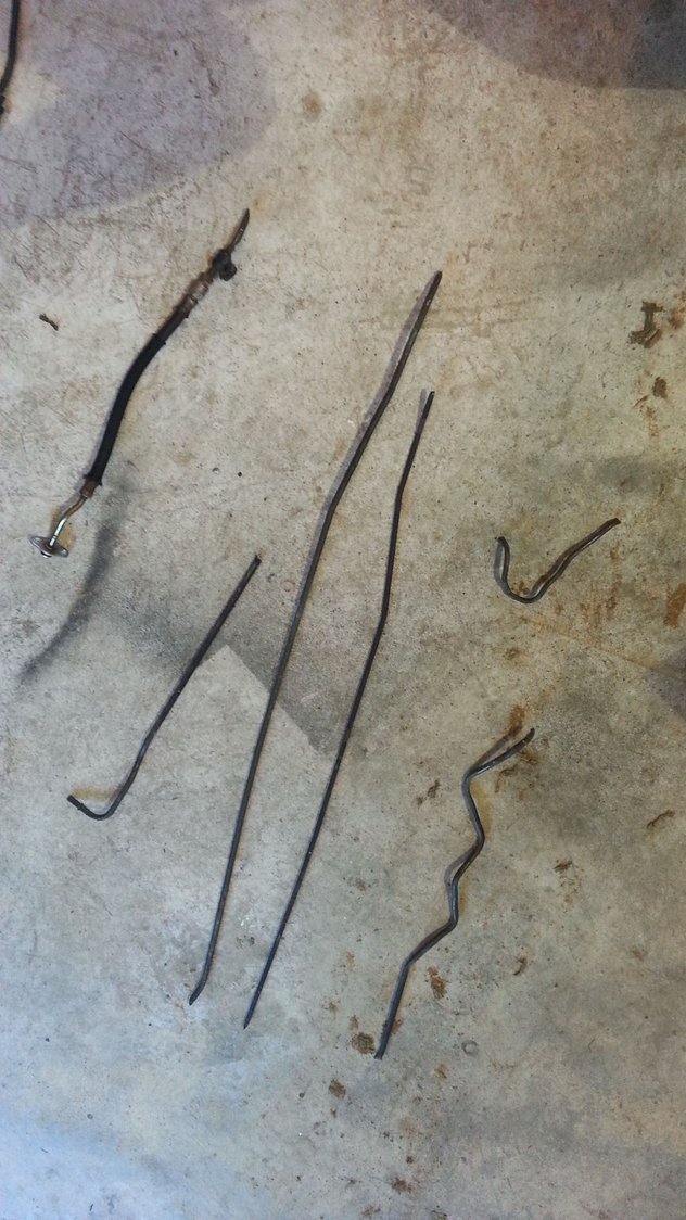

Update
The Koyo Rad is in

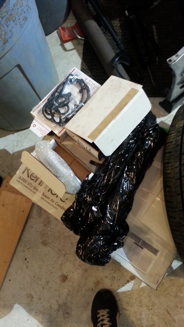

Also got the old fuel system out and a few shots of replacement parts
More in the next post!

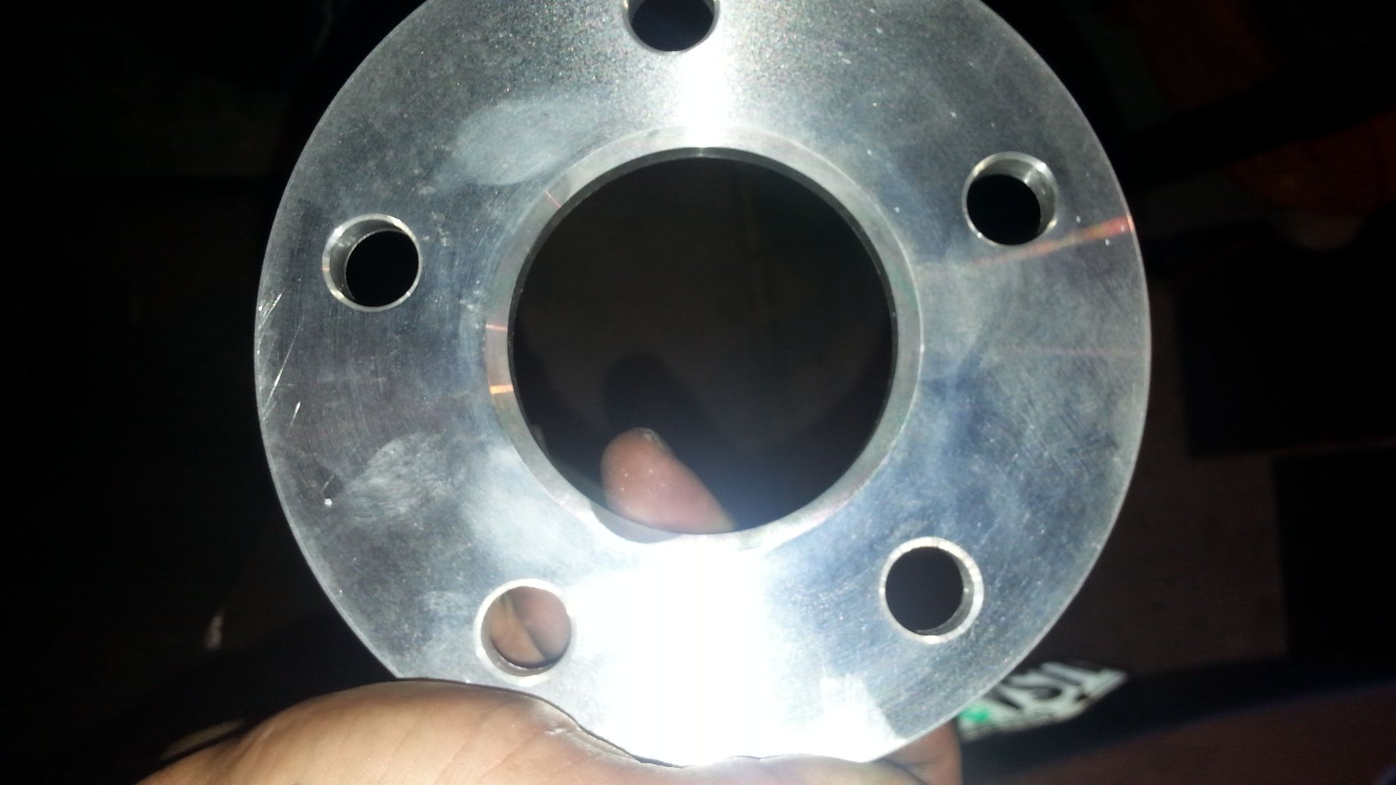

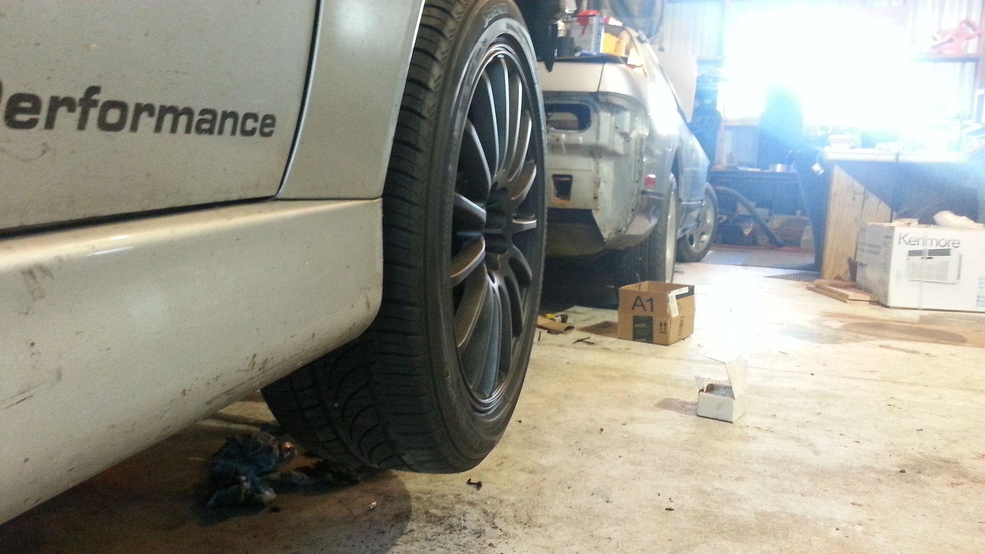

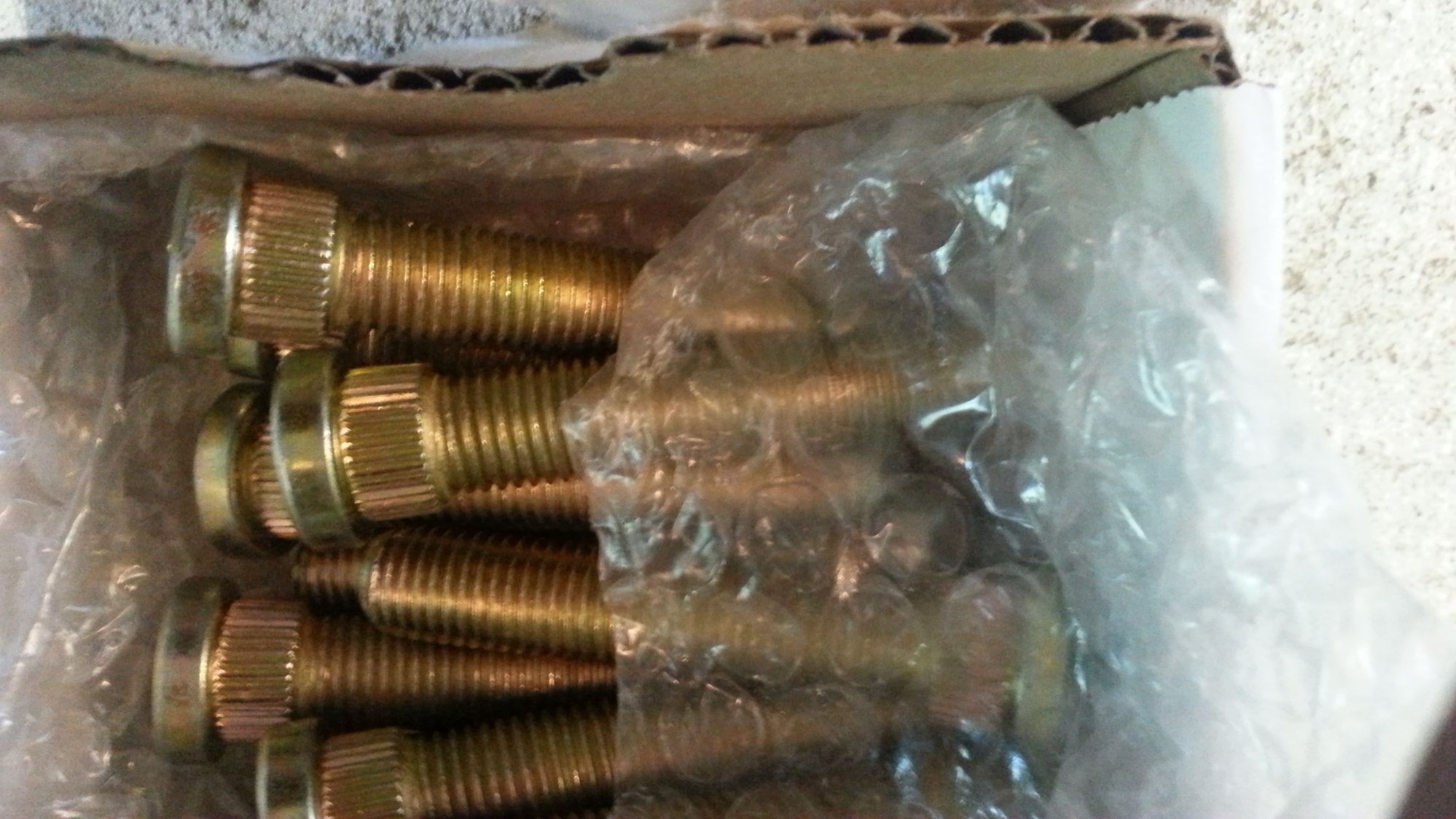

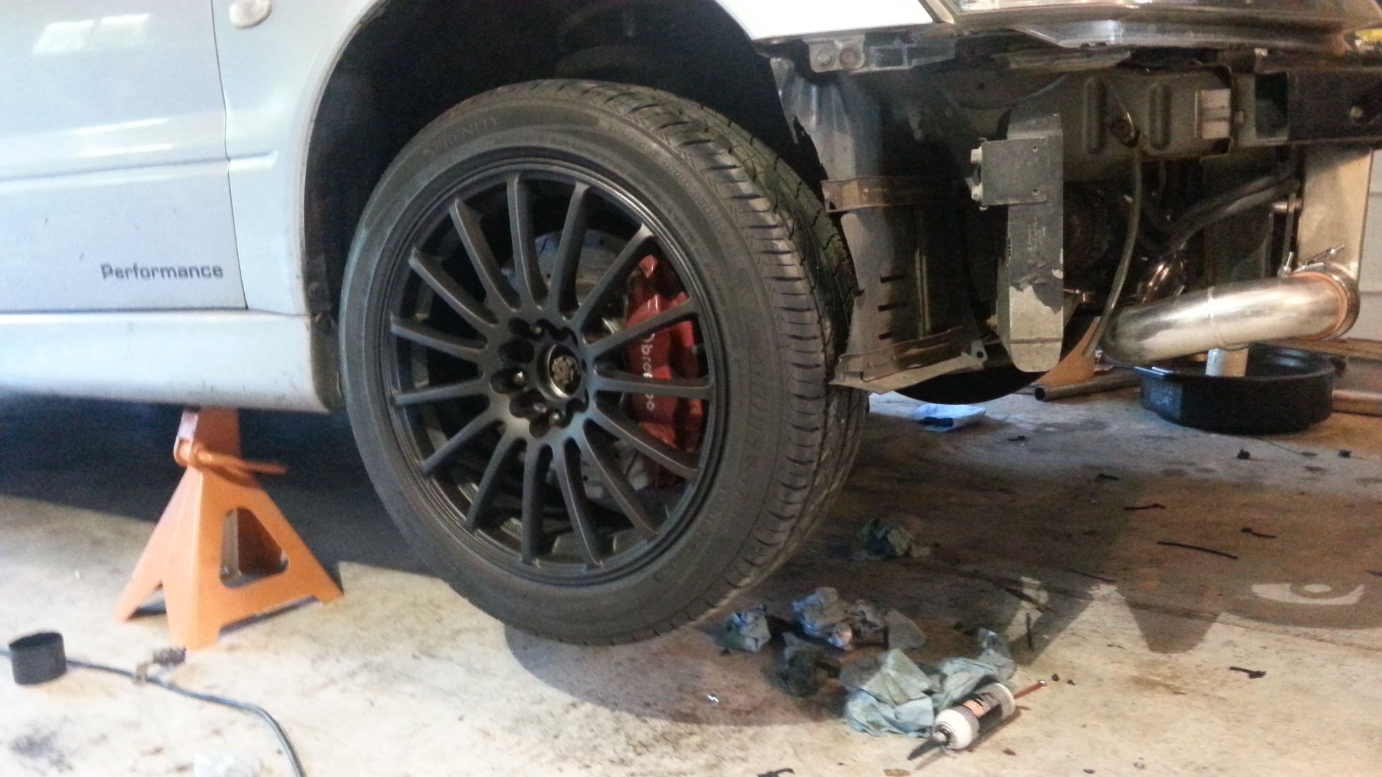

New wheels got a coat of paint
And spacers were put on.....they look extra flush!!

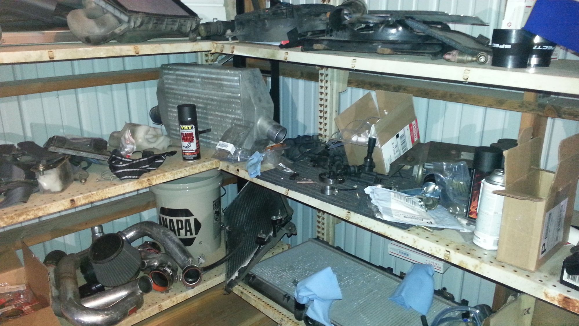

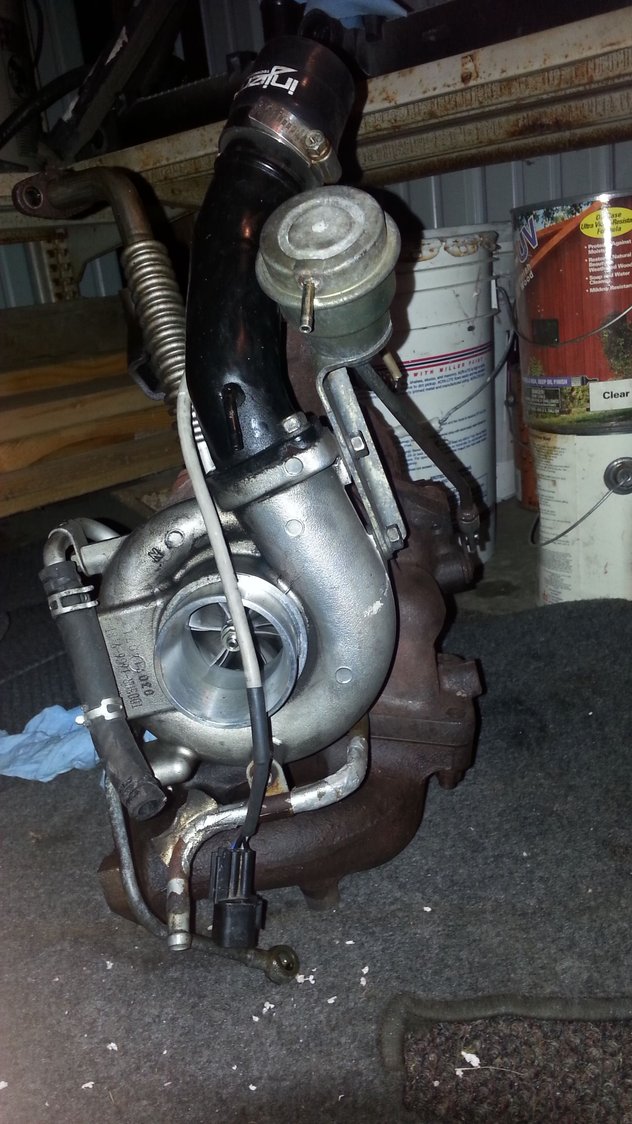

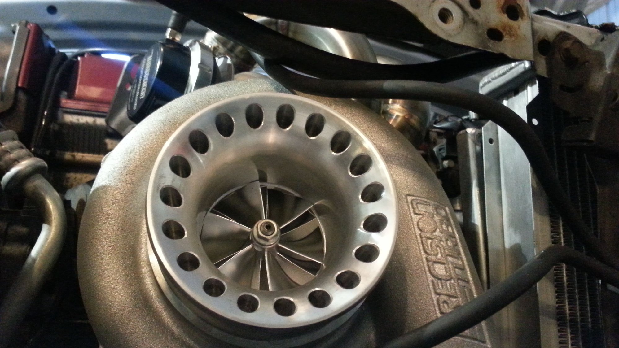

I also took some pics of the old turbo and my Evo parts shelf

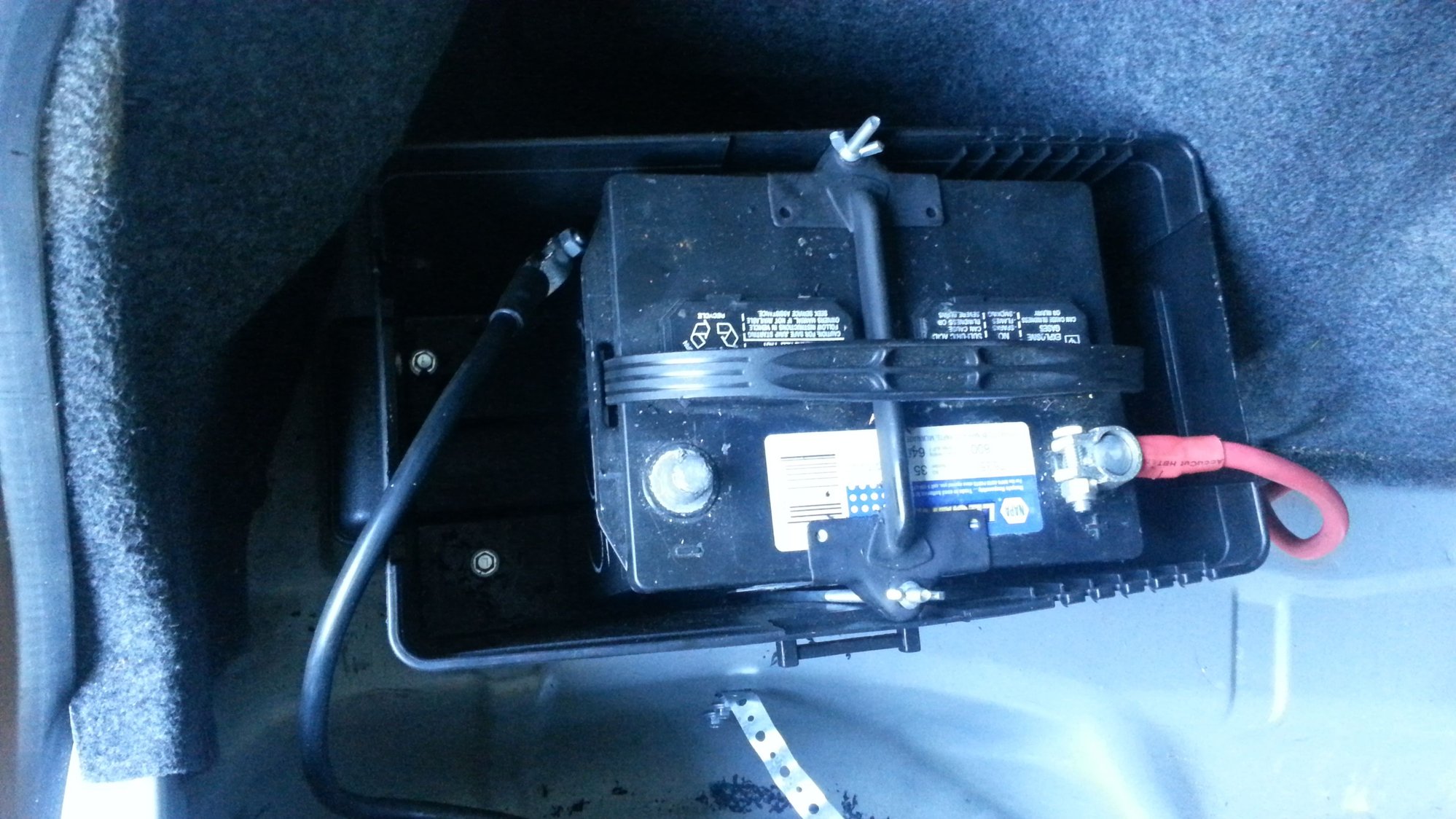

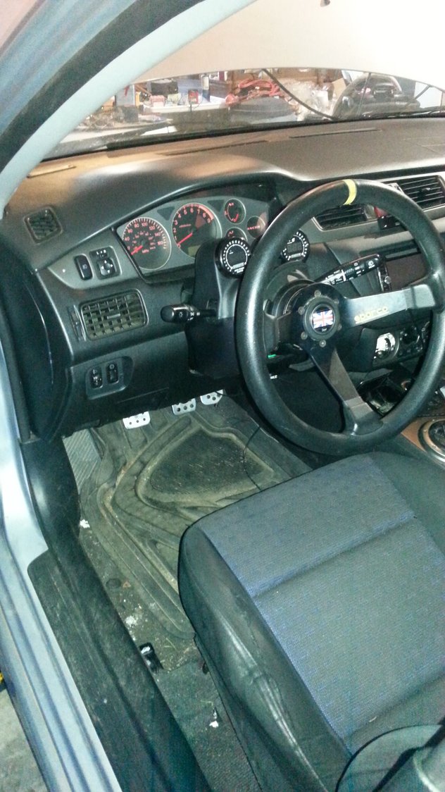

And I got some shots of the battery relocation and shifter bushings installed

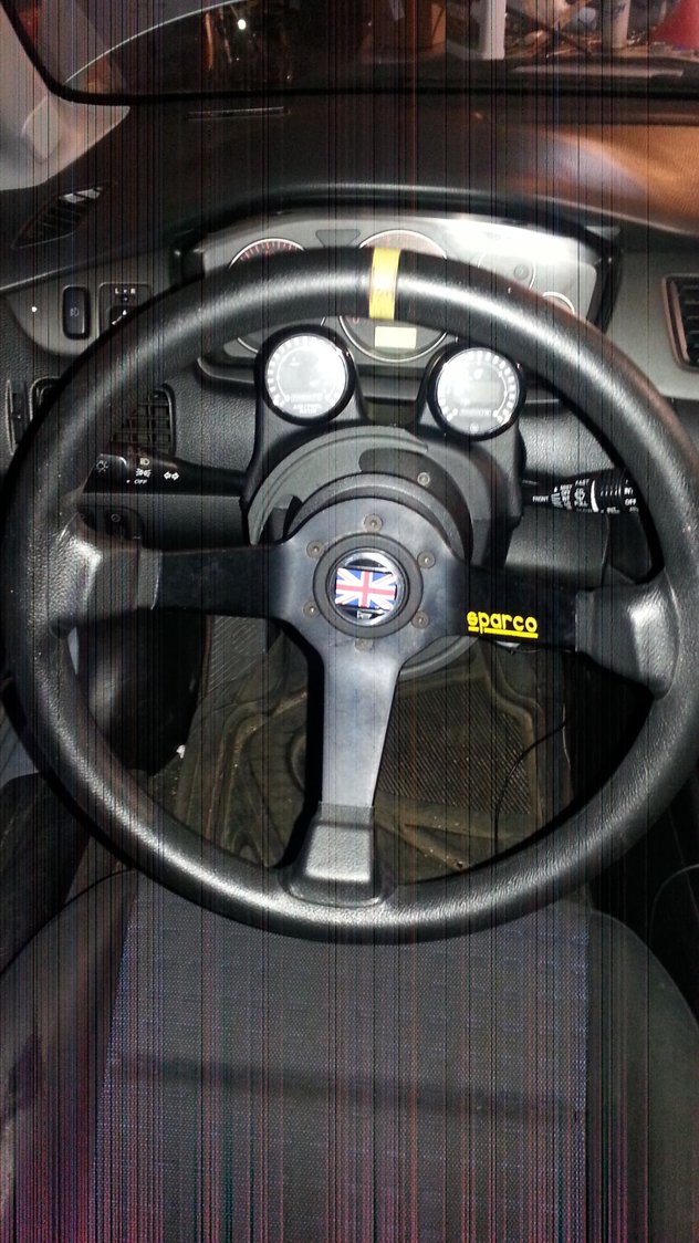

And I switched my hideous triple pod and glow shift guages for some Innovative MXTD and MXTL guages
and a tasteful twin pod

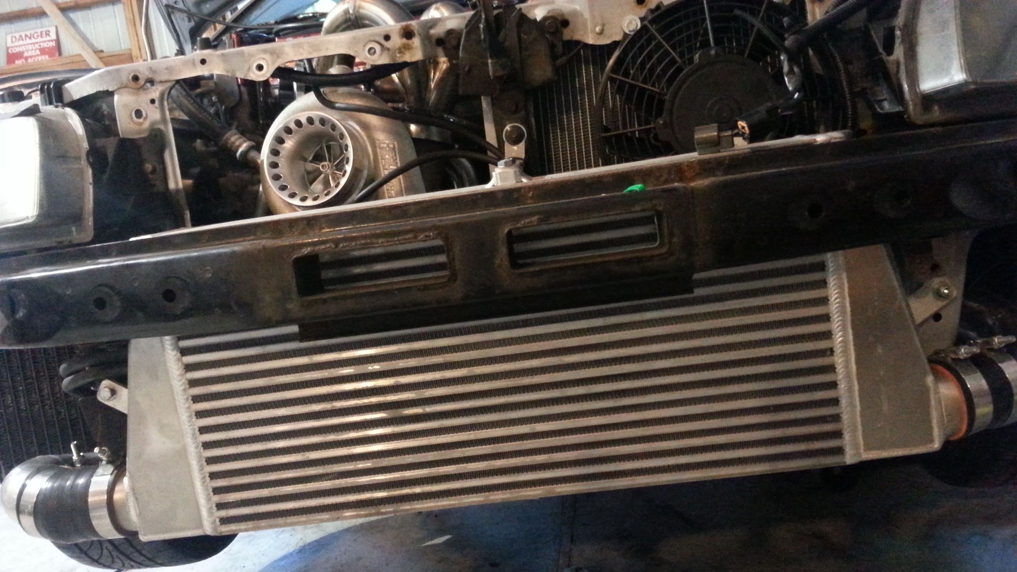

Finally more shots of the turbo setup

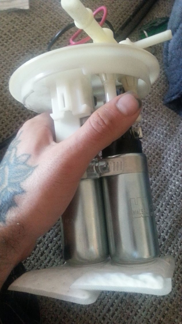

My SM double pumper arrived!
Really excited to try this and excellent quality! Thanks Strictly Modified.

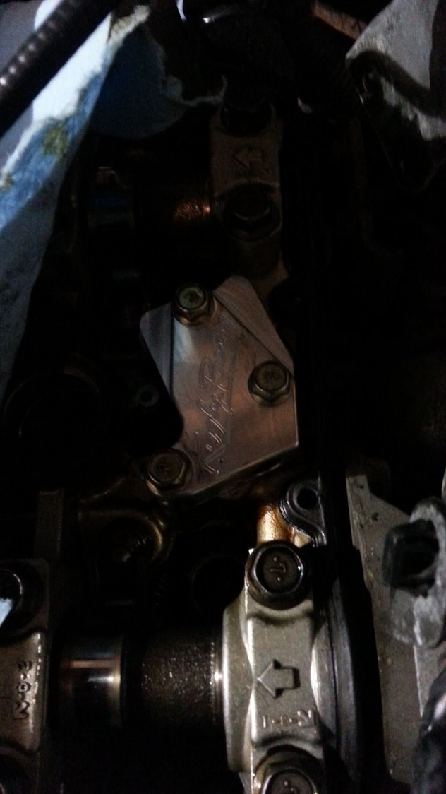

Update

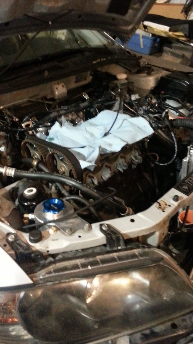

Valve cover is off and cams are underway finishing up the rest tomorrow

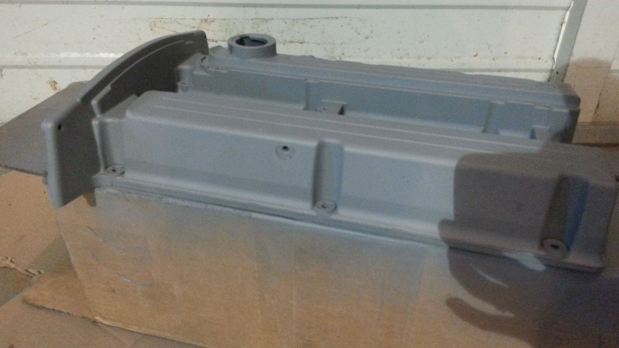

Here are some more shots ...one of the newly installed Kggly HLA
Also valve cover its being painted
Currently in primer
End result will be Wrinkle Black

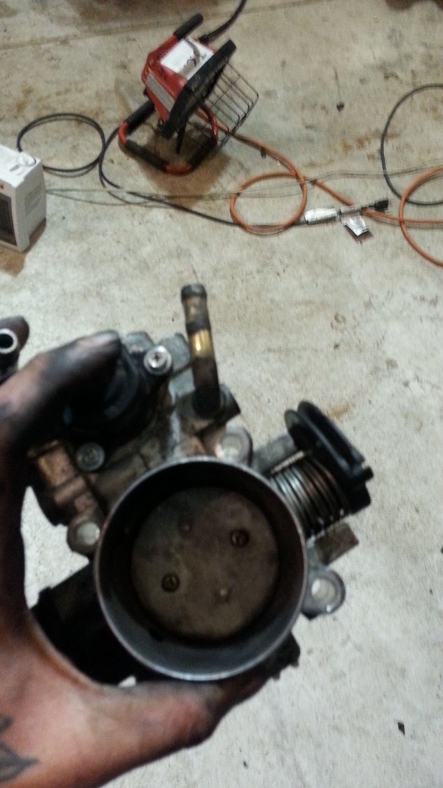

Also TB shaft seals installed
Here's a pic of me holding the TB

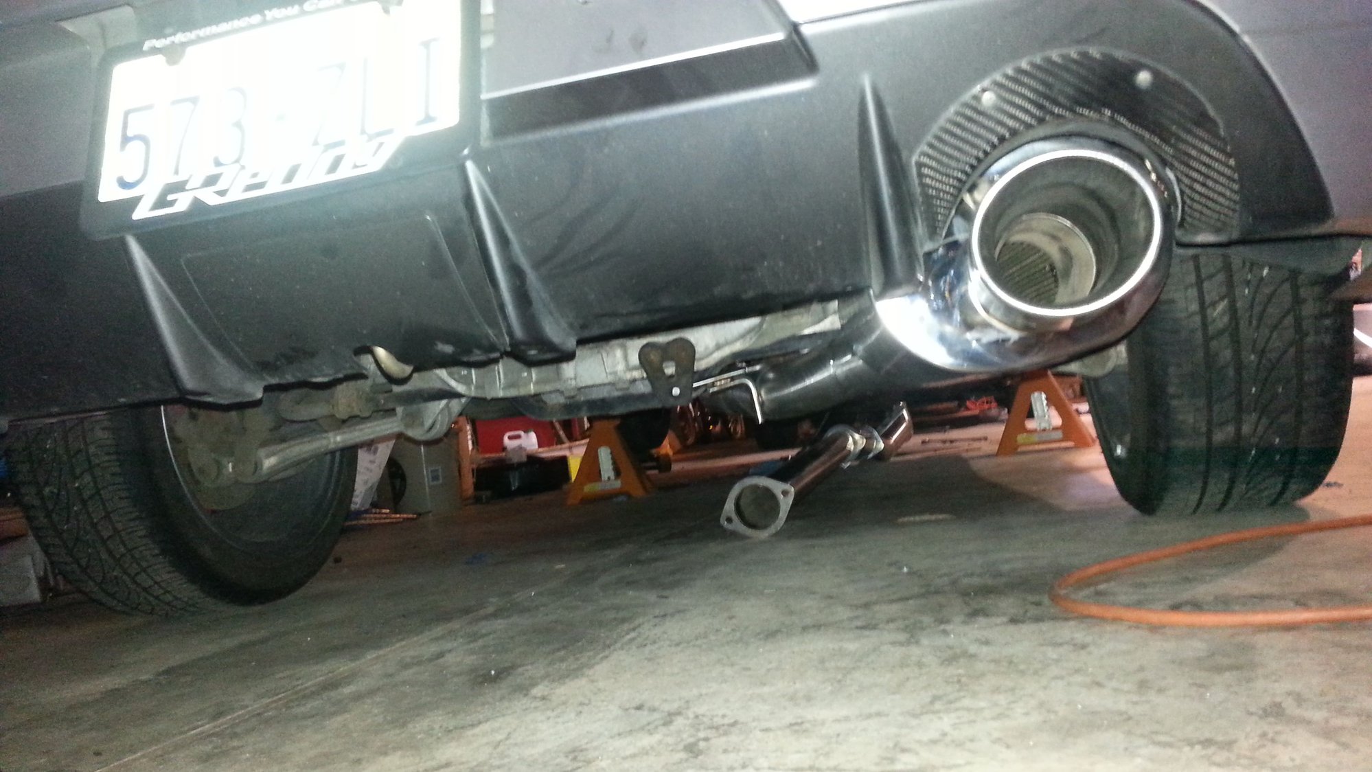

And I got my new exhaust on

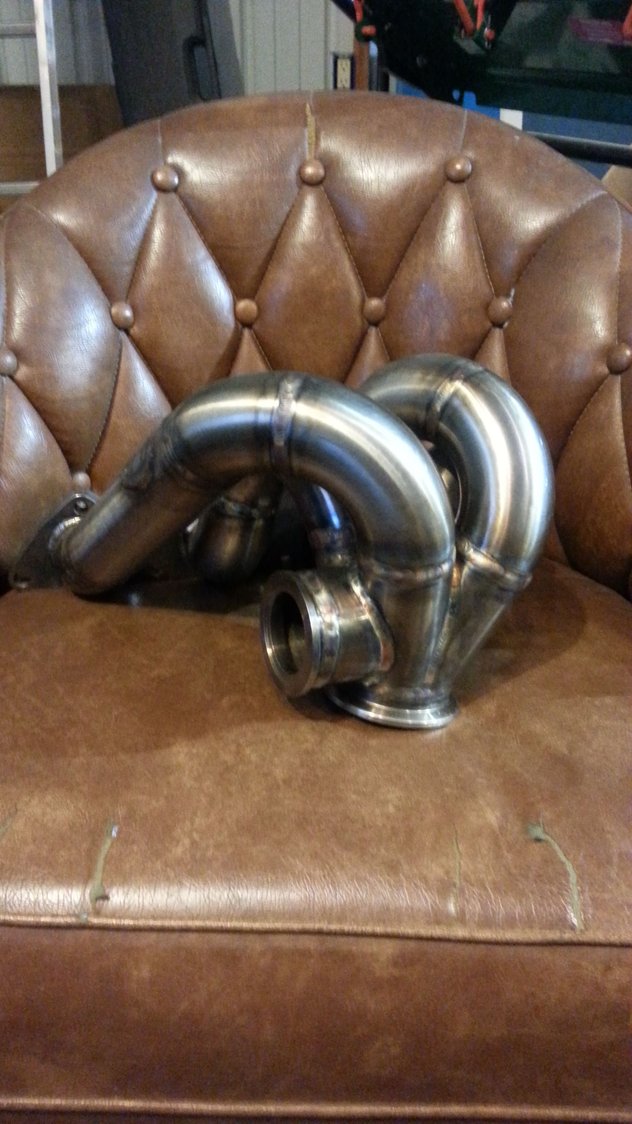

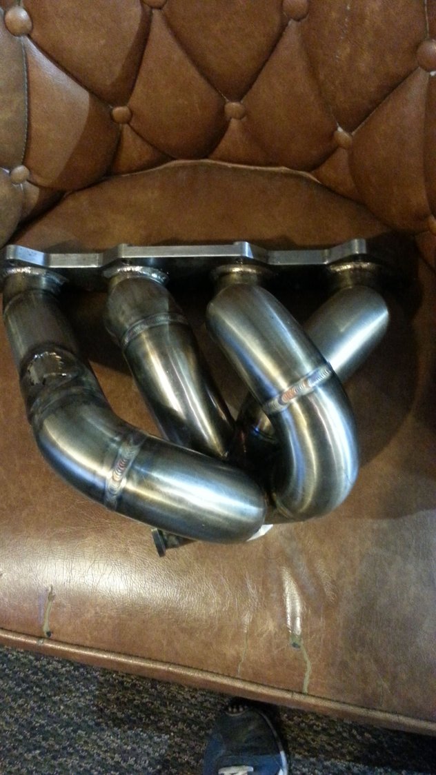

Finally here is some pics of the cams and head studs prior to install all wrapped up.....and some shots of the sheepey manifold off the car
Cuz
It's so pretty

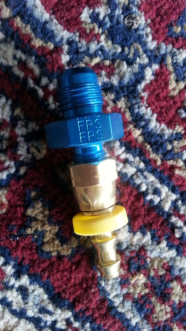

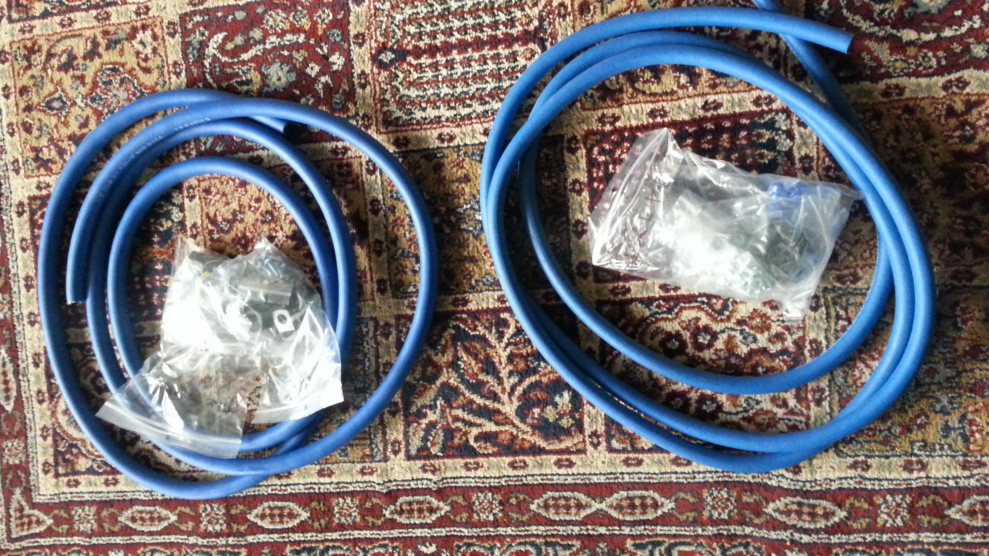

UPDATE!!!

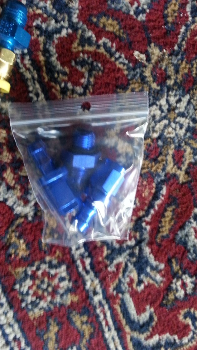

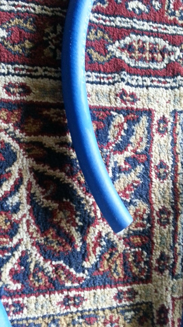

Fuel lines have arrived
The RTM kit is awesome and comes with everything you need

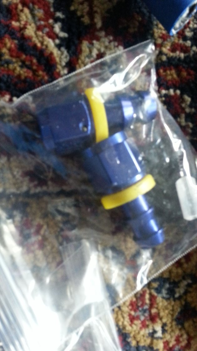

Here are some pics of the hose abd fittings
-8an Feed -6an return
However since I went for the double pump post ordering the fuel system an additional -8an to 1/2 barb adapter was necessary which Amazon is one day shipping to me.
