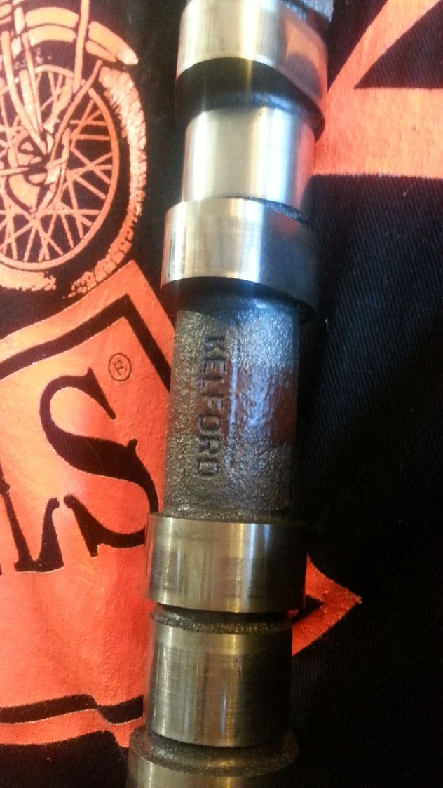

Went to finish cam install got the kelfords in and went to spin the motor slightly to get the piston back at TDC since
it had moved just a bit during the cam install.
As I get the piston close to TDC I feel a slight bind......so I look in the exhuast port #1 and sure enough the piston is hitting my valve
I was told Kelfords fit with the stock bottom end
Only things it could be if the kelfords are not wrong are..........

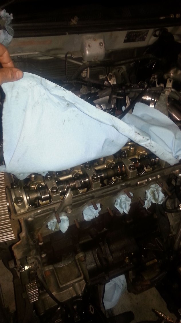

Kelfords are in! Pulled the head off clayed it and it turns out the issue was just me being overly cautions
Sorry for the no pics but I was very frustrated and determined to figure out this problem so I left my phone inside and plowed away for 14hrs total.
Only good bit of news is my local auto parts store had every gasket I needed to get me going again
I did skimp on having the head resurfaced because there were no machine dogs open yesterday and I was determined. I have the saftey of a spare motor and head that I can have ready to drop in about two weeks so im not stressed

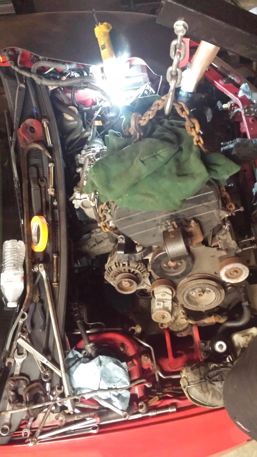

Thought I'd update today with some pics that I had on hand
TOMORROW IS WHEN THIS BUILD GOES 1080p ....sorry again for cell pics

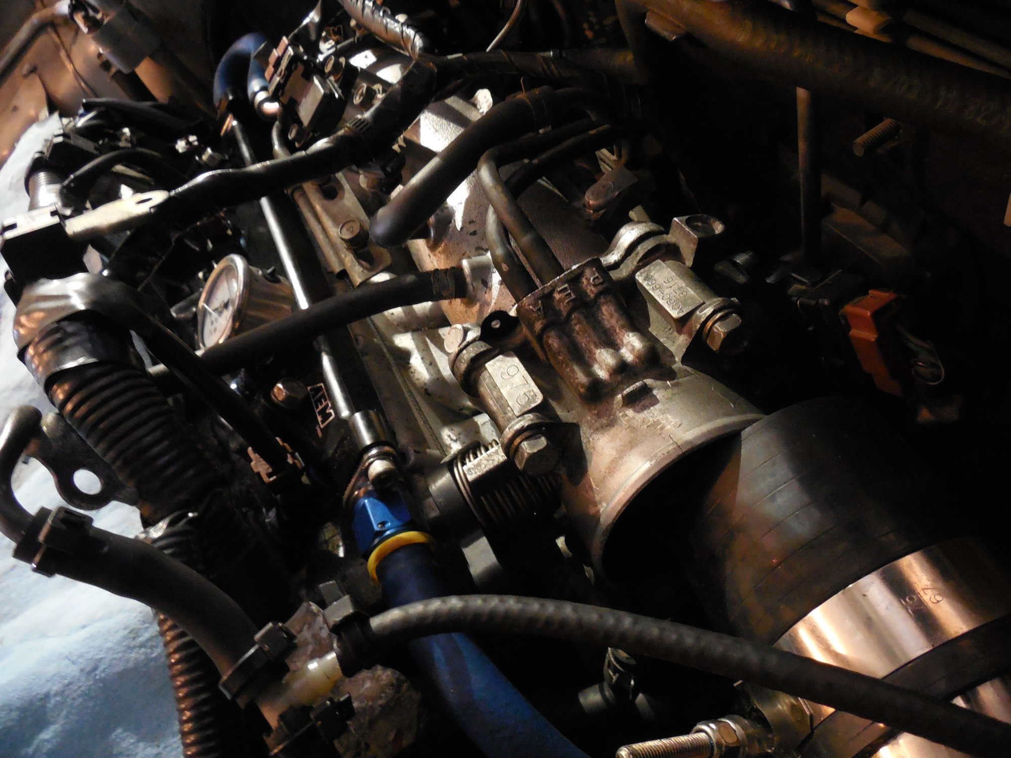

Update!
1080p !!!!!!!

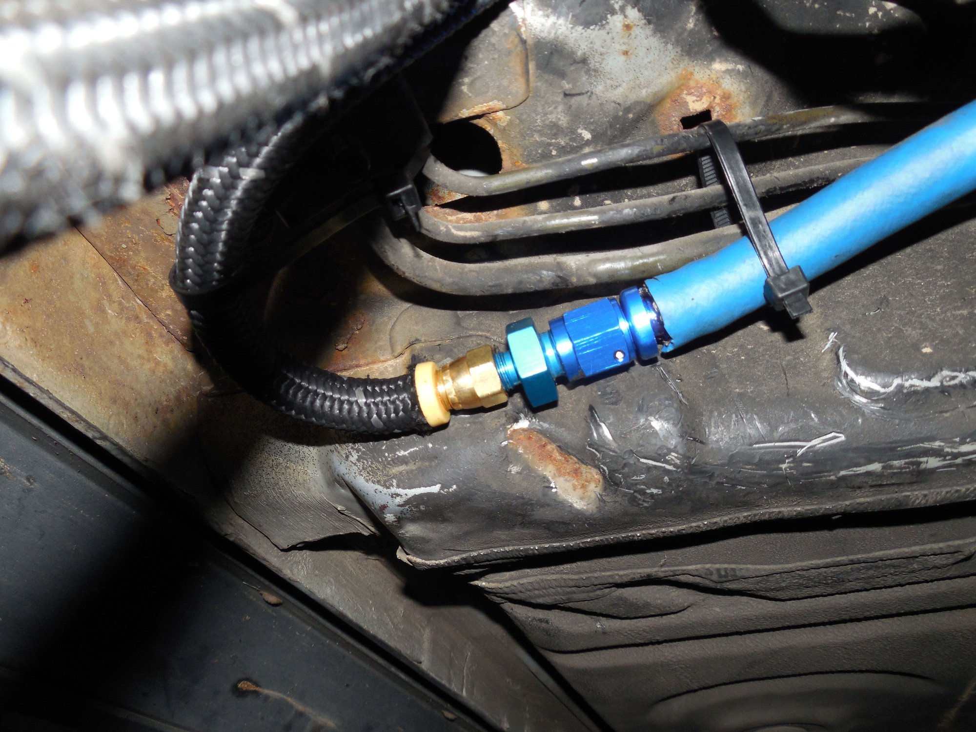

And got 99% of the fuel system in
I just need to connect post tank filter to feed
Here are some of the underside and return fitting to tank
I am using 0 factory fuel line
I still have to properly secure the return connection below but you get the idea

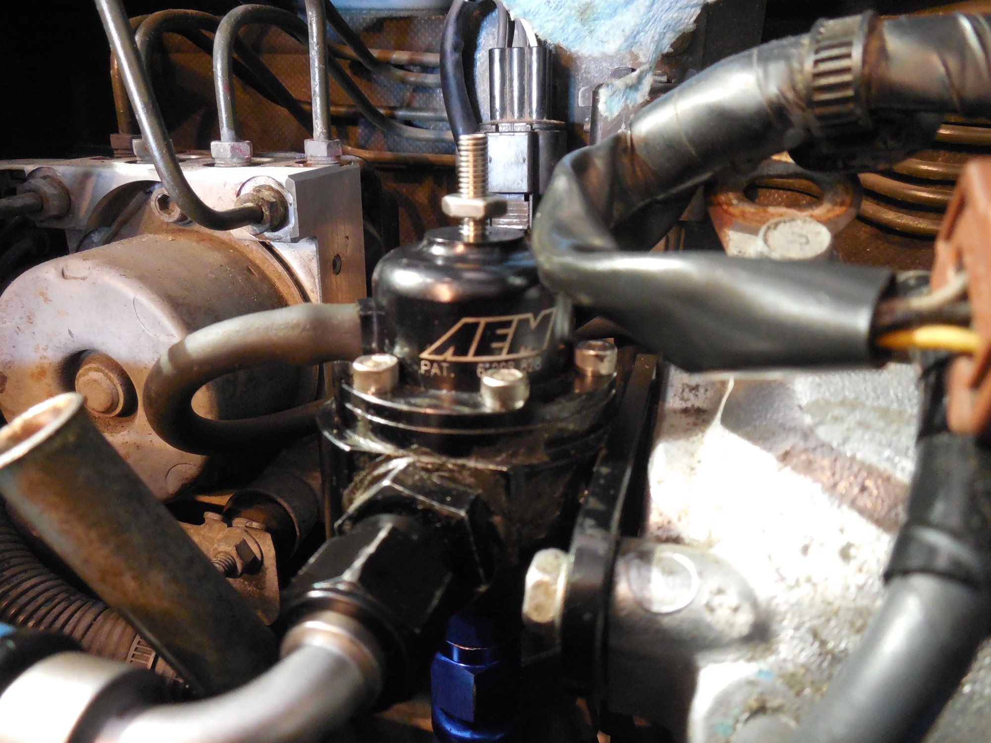

I also finished up my double pump system today
Also on a semi related note
I can't stand crimp connections
I do not feel that they are safe in any way
I solder all connections and on any fuel, ecu, or TC system
Here's a pic of the way I did the ground
More to come

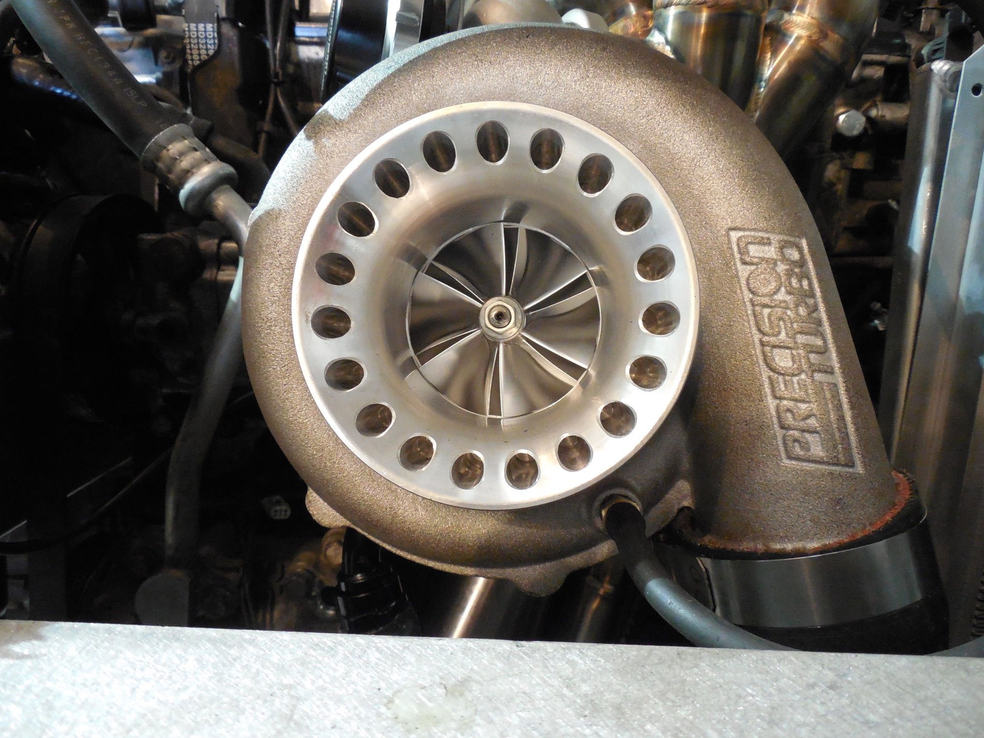

Valve cover goes on
Turbo goes back on
New OFH feed install
Then fluids and fire!

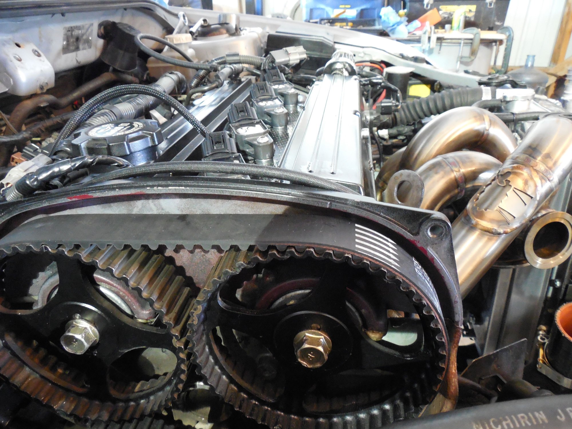

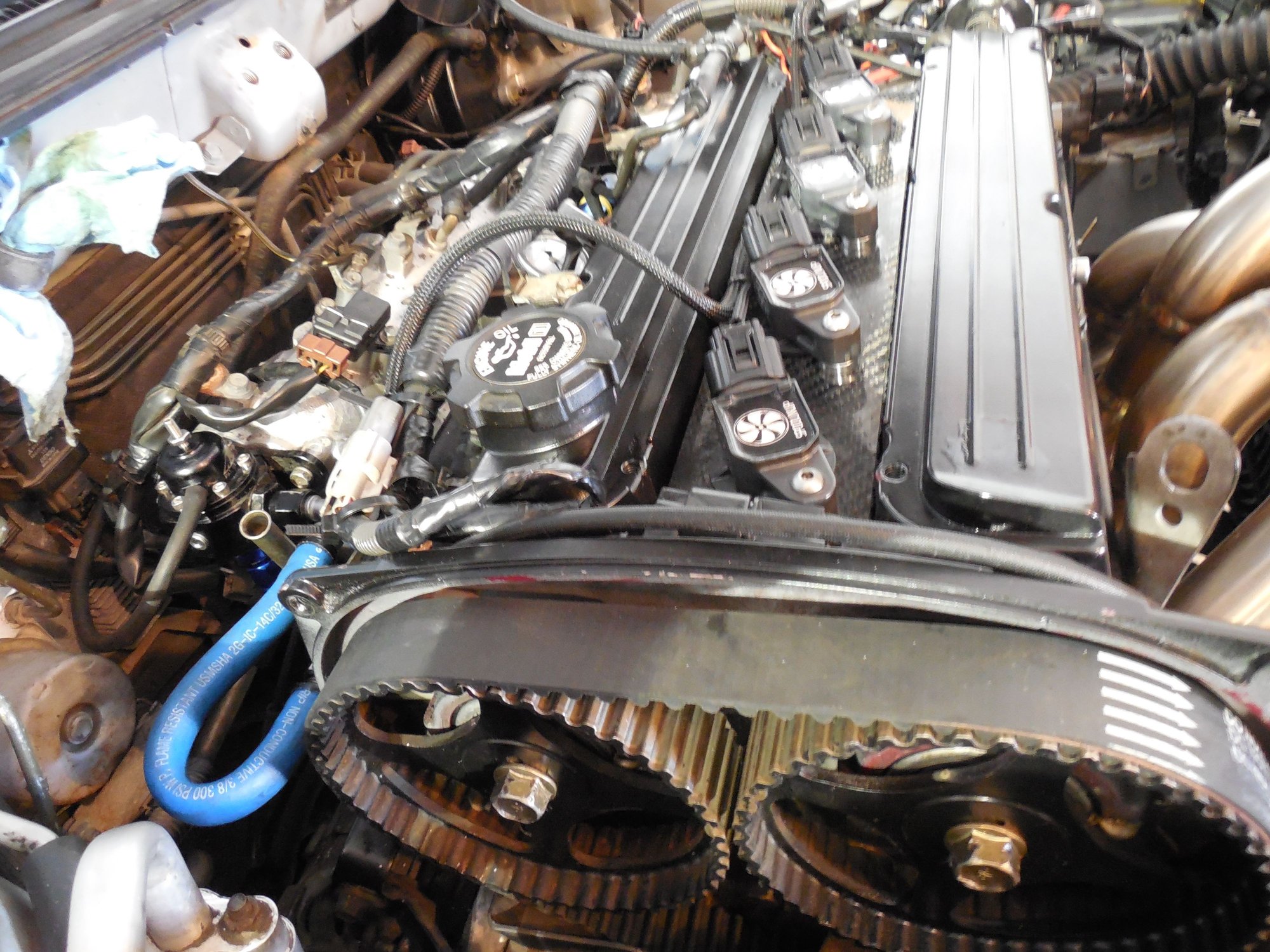

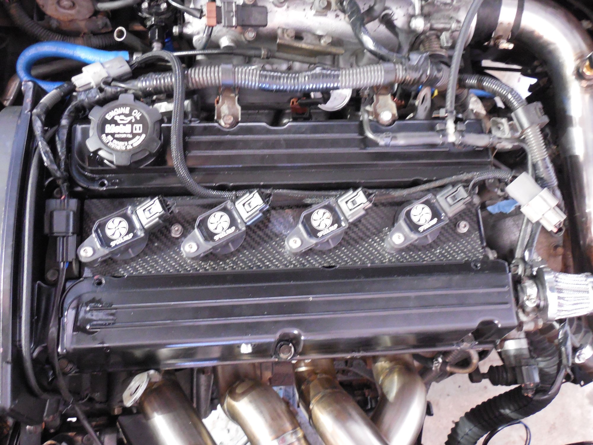

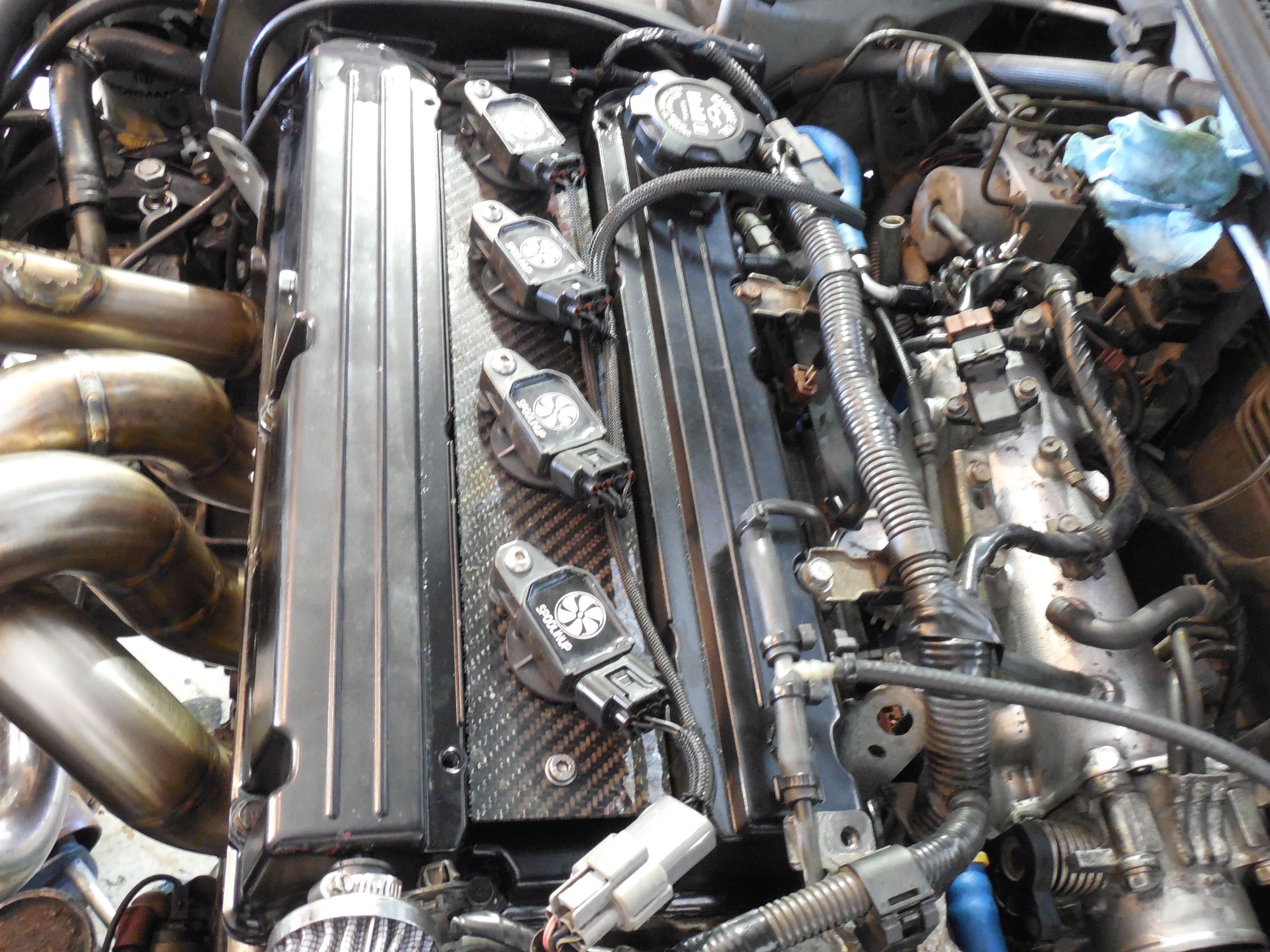

Update!!!
Timing finished and valve cover installed!!!!
also rough finish of fuel system

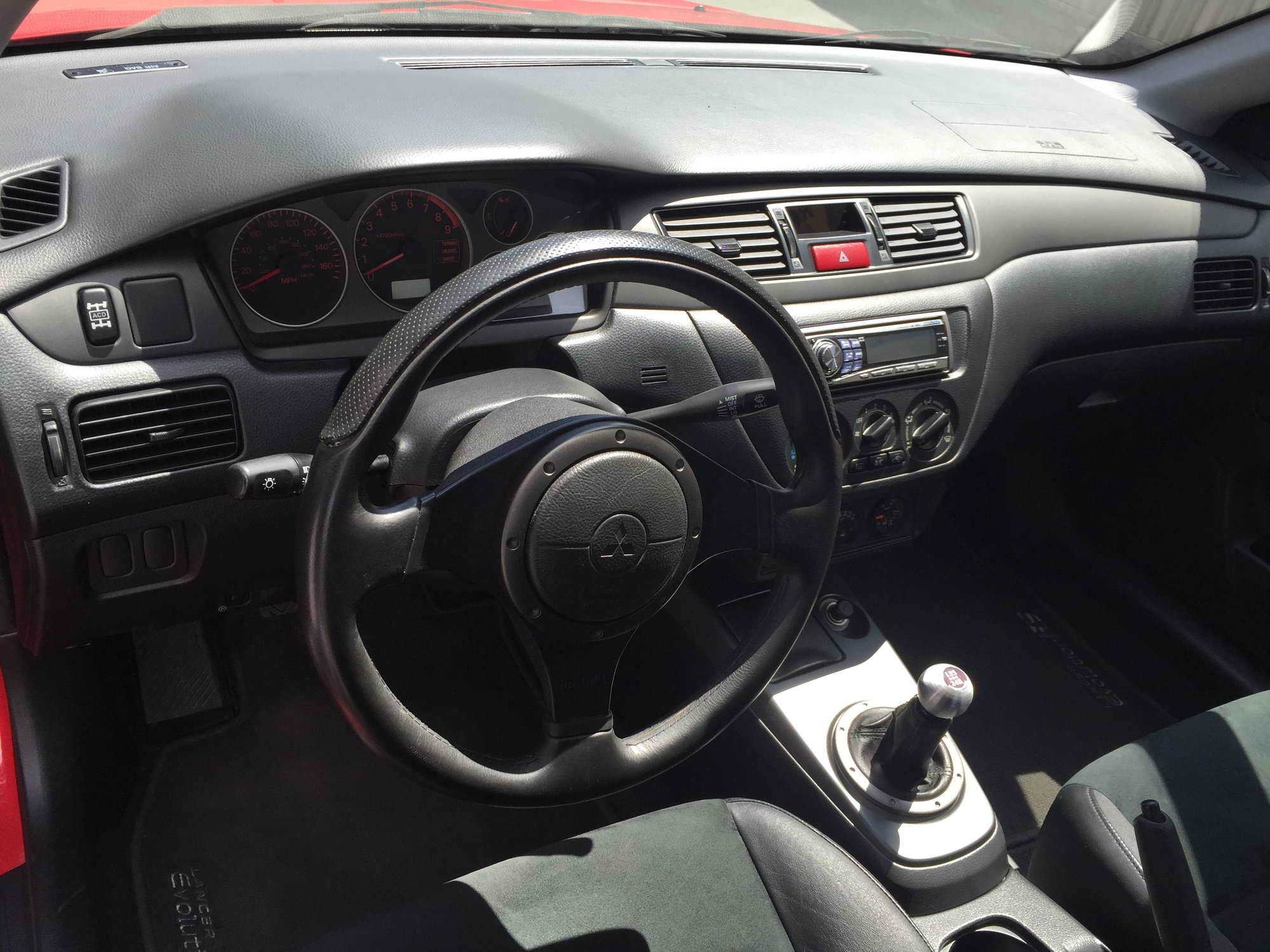

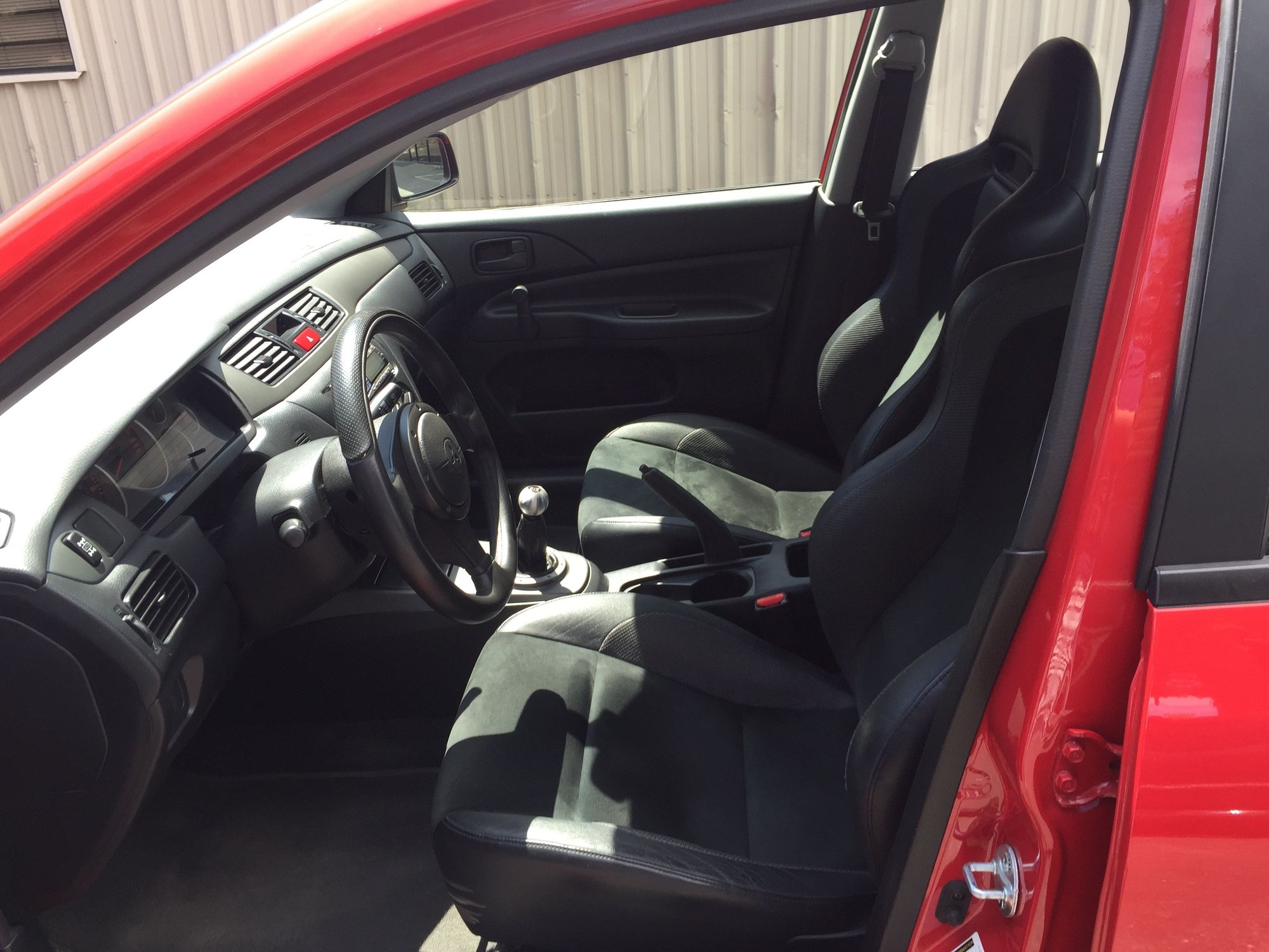

And here's a better pic of what i did with the interior
prior to this it had a triple pod.....which IMO is very rice
It also had three Glow Shift gauges that had power to get the face to light up but they were not attached to any sensing units...also very rice
and a bolt in harness bar with 4pt harnesses........very rice and useless
So I bought an OEM driver pillar and started my dream interior
its far from done but more to come on this subject next week
