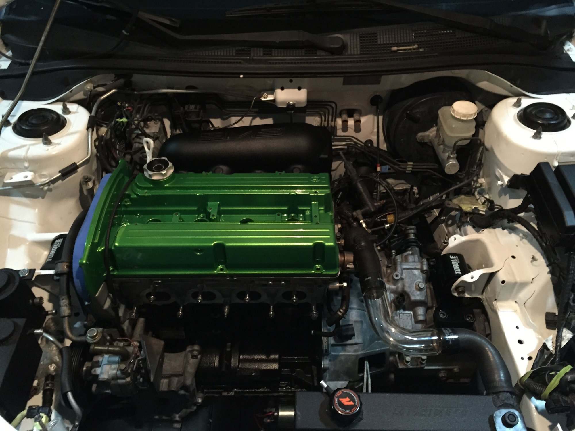

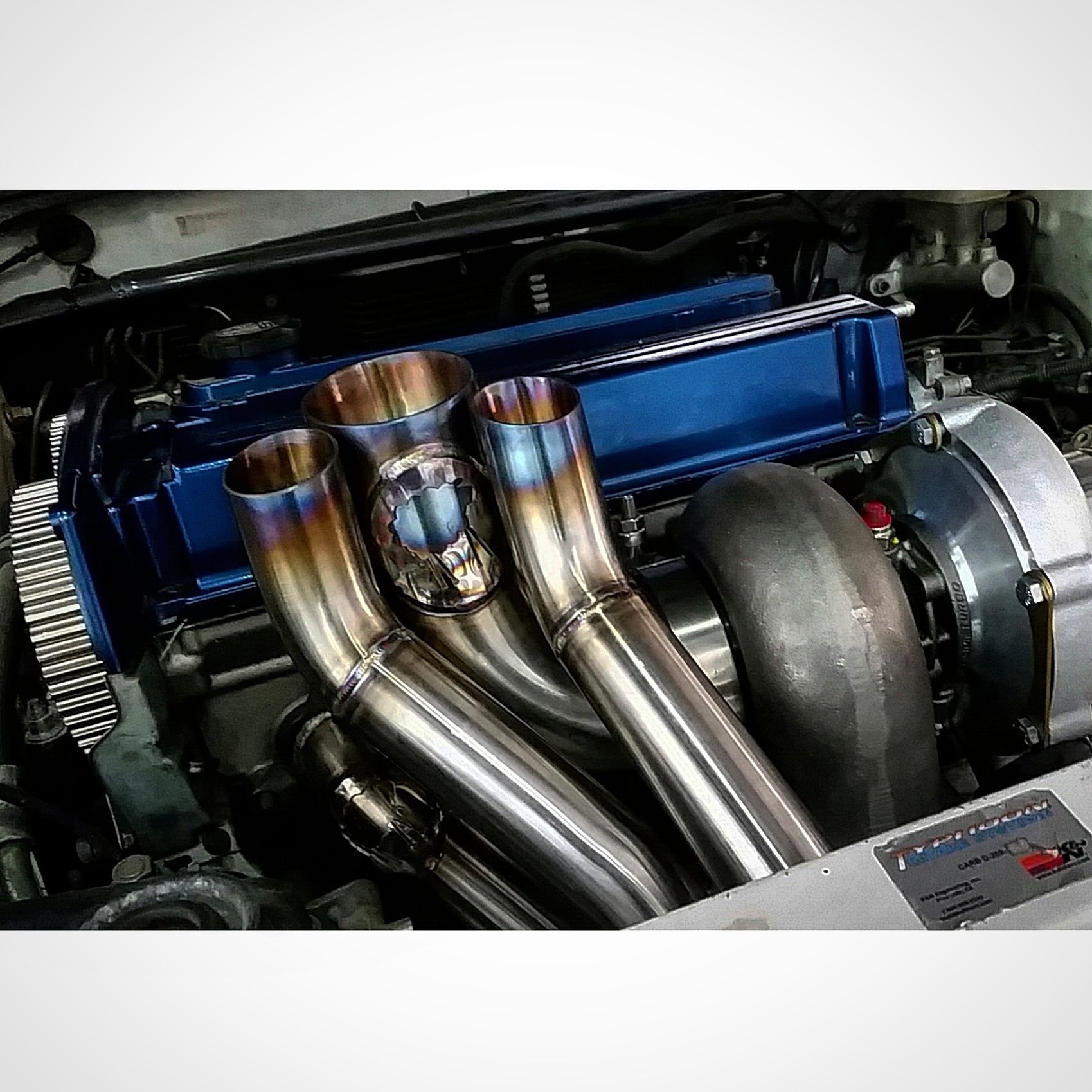

Had written a whole post but the computer froze. Will edit it and add the previous charade I had written. As of now mainly visuals and hoping for som 600whp. It is a work in progress, learning a lot and trying something wild compared to my previous cars with the built motor etc etc etc.
Mods:
2.0 L Forged Block with Je Pistons and Manley Beams
Acl Race Bearings
Arp Main Studs
6466 T4 Sheepey Top Mount Twin Scroll
Sheepey 1000hp Intercooler
GSC Beehive Springs
GSC Valves Exh and Int
Aem True Time Cam Gears
Ferrea Valve Guides
Ferrea Valve Seals
GSC S3 Cams
AMS F1 Intake with Boomba TB
Mishimoto Half Size Radiator with FAL 123
Buster Catch Can
Aem V2
Aem Water/Methanol 5 Gallon
Quarter Master Twin Plate with Hydraulic TOB
Prosport Gauges
Zeitronix ZT-3 with Hacker Gauge
What is coming to make some JAAAAM !!! =)
More progress !!!
There is more fun to come!

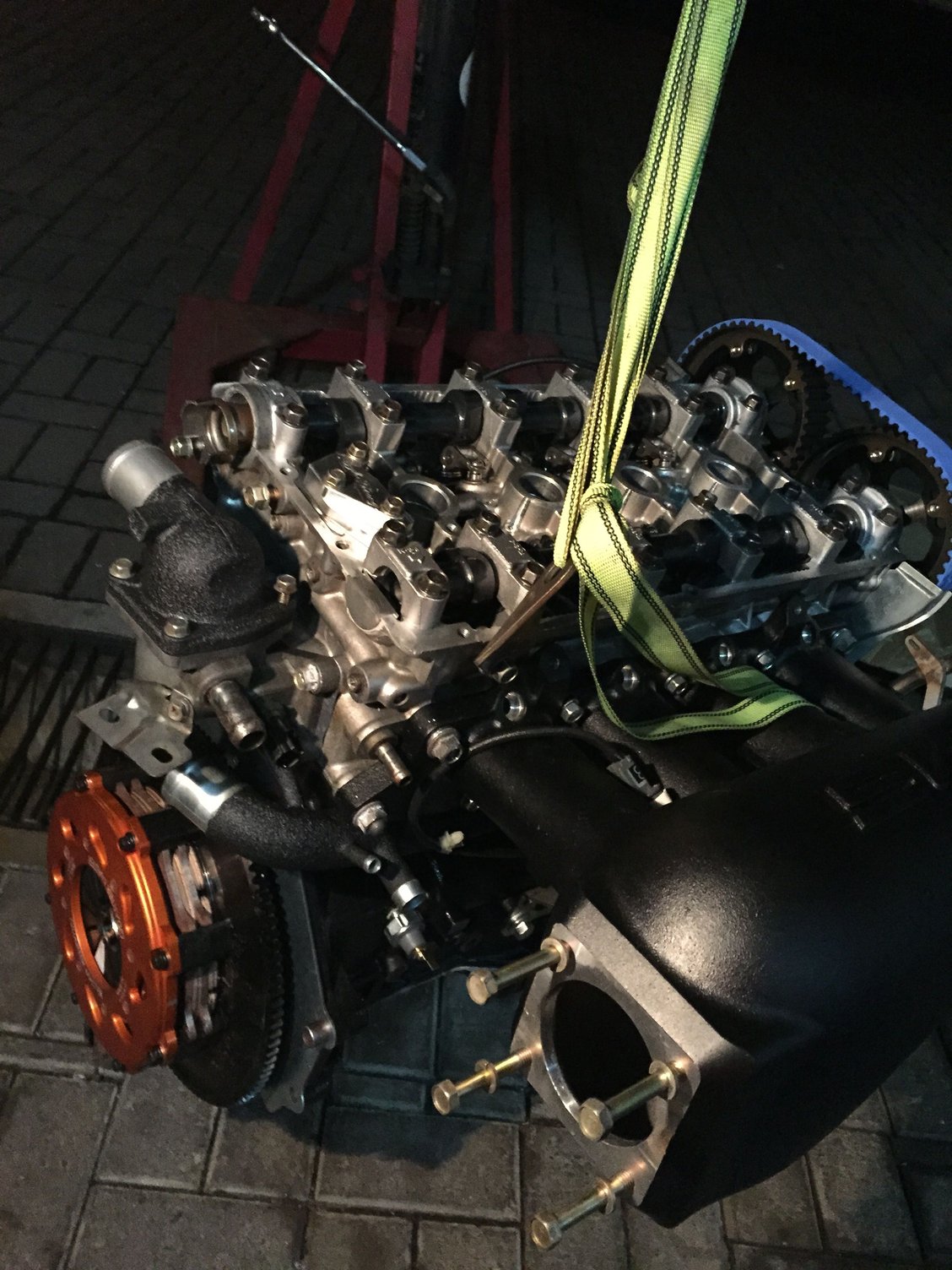

Picking her up!
All mine!
What I received!

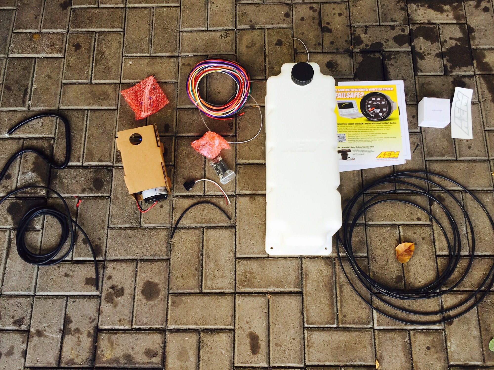

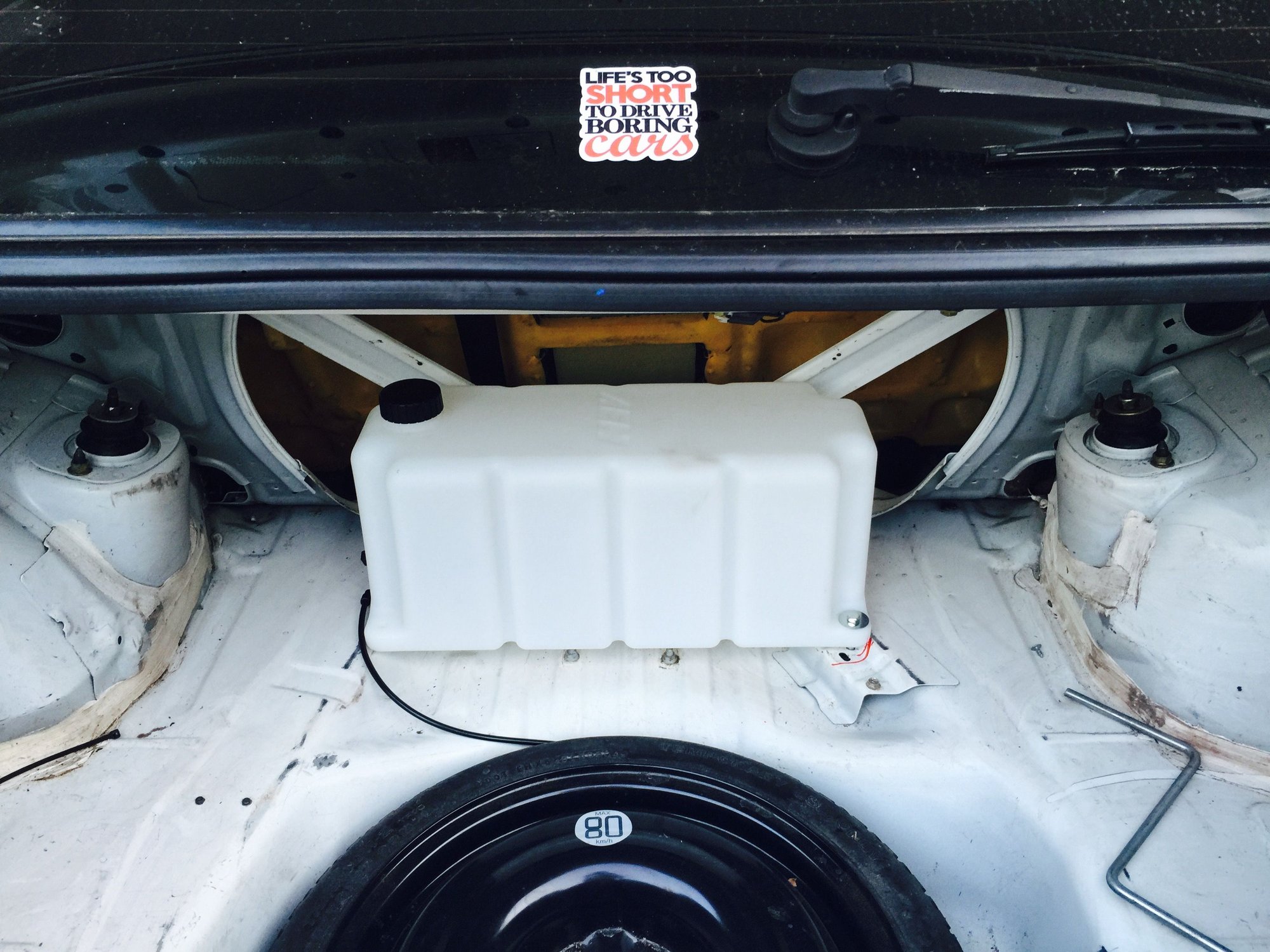

So yesterday had some time to sort some of the things out since the engine is out. I have started to install everything around that is not engine related directly. Started to do the custom AFR gauge inside the watch and installing the methanol kit in the trunk. Still needs to be wired, install the main controller. Thinking of installing it in the glove box with a nice tuck. I have never used meth injection so do not know how often you need to readjust knobs but guess I will figure that out on the process.

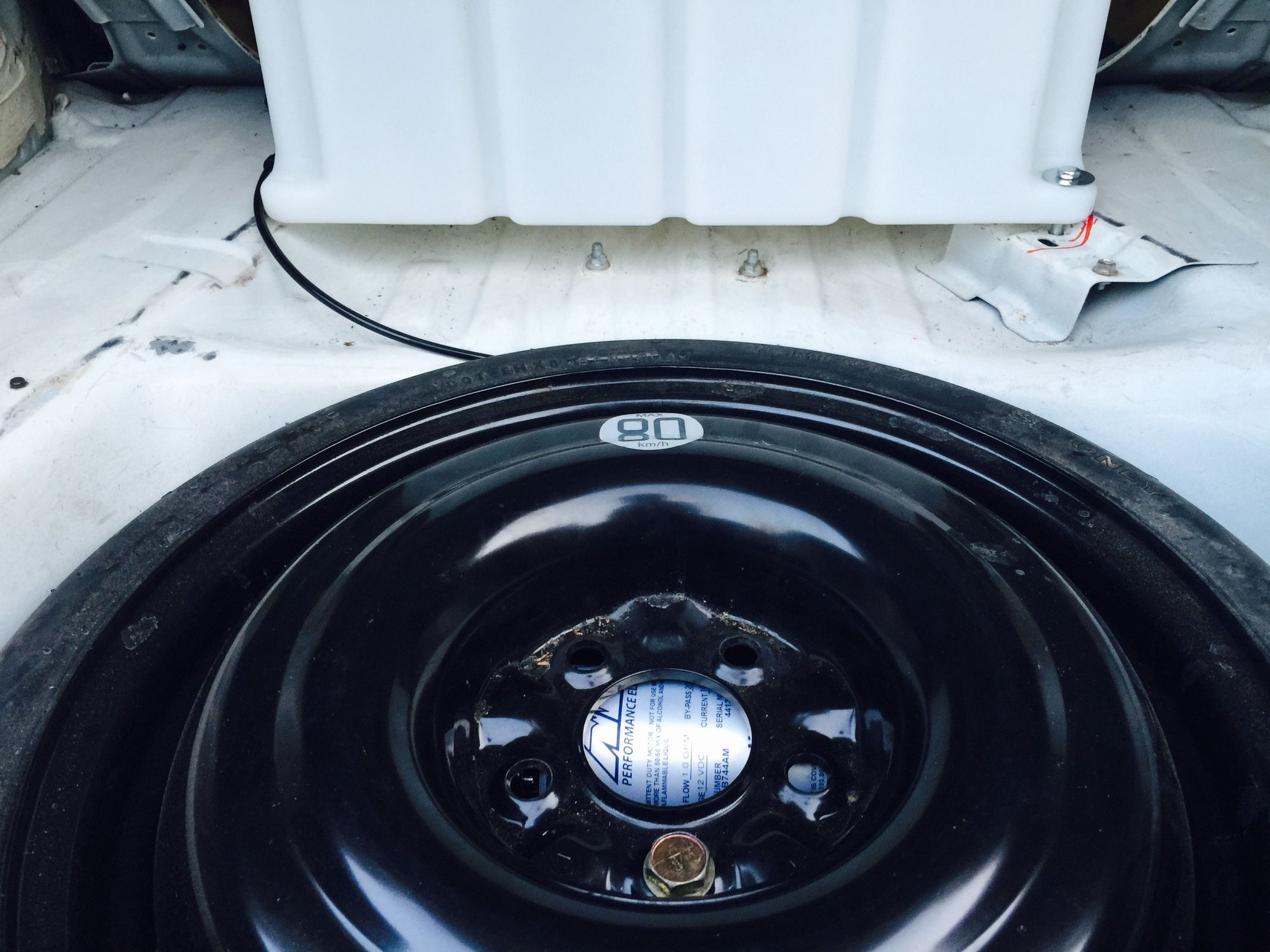

The kit is preinstalled in the rear trunk, need to do some bases for the tank. Wanted some machine billet spacers to add maybe 1/4 of an inch in the air between the tank and floor. If you know where I could get those let me know!!!
Pump has been installed inside the rear tire. I guessed that since we are doing a nice tuck it might as well go there, and since AEM wants it under the main line, well thats a win win. Need to make also some bases, thinking some wood to space up the tire after cleaning and before tightening so it does not move around.

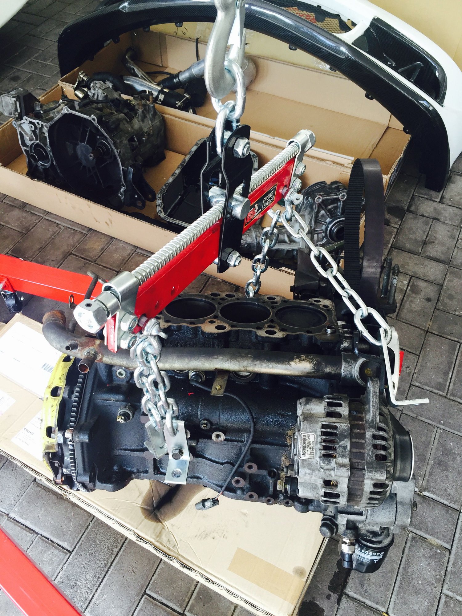

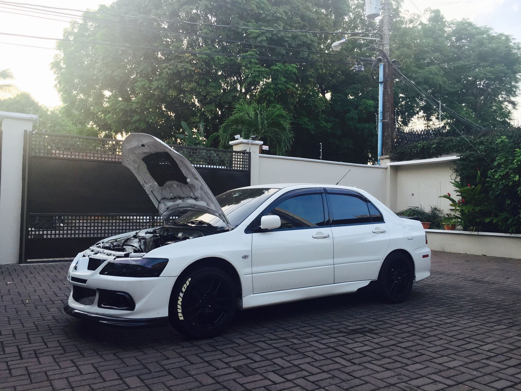

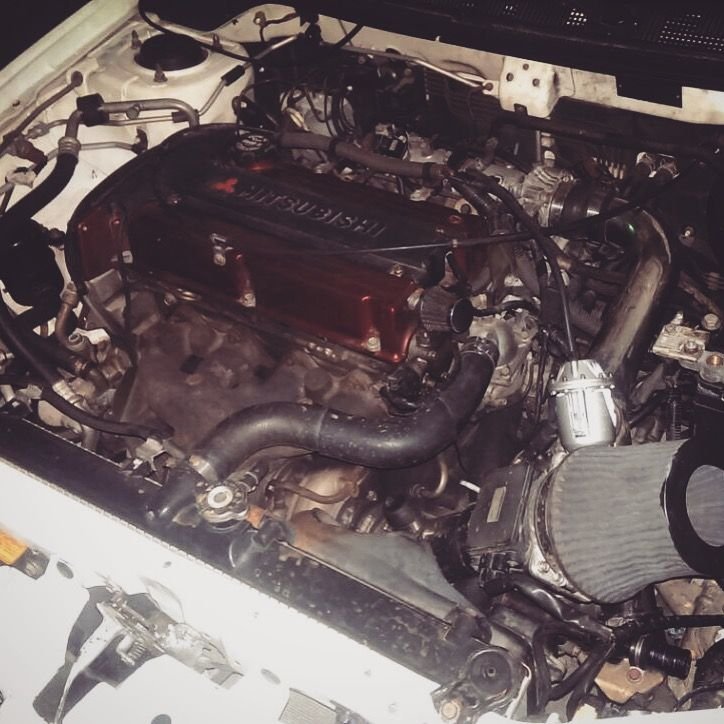

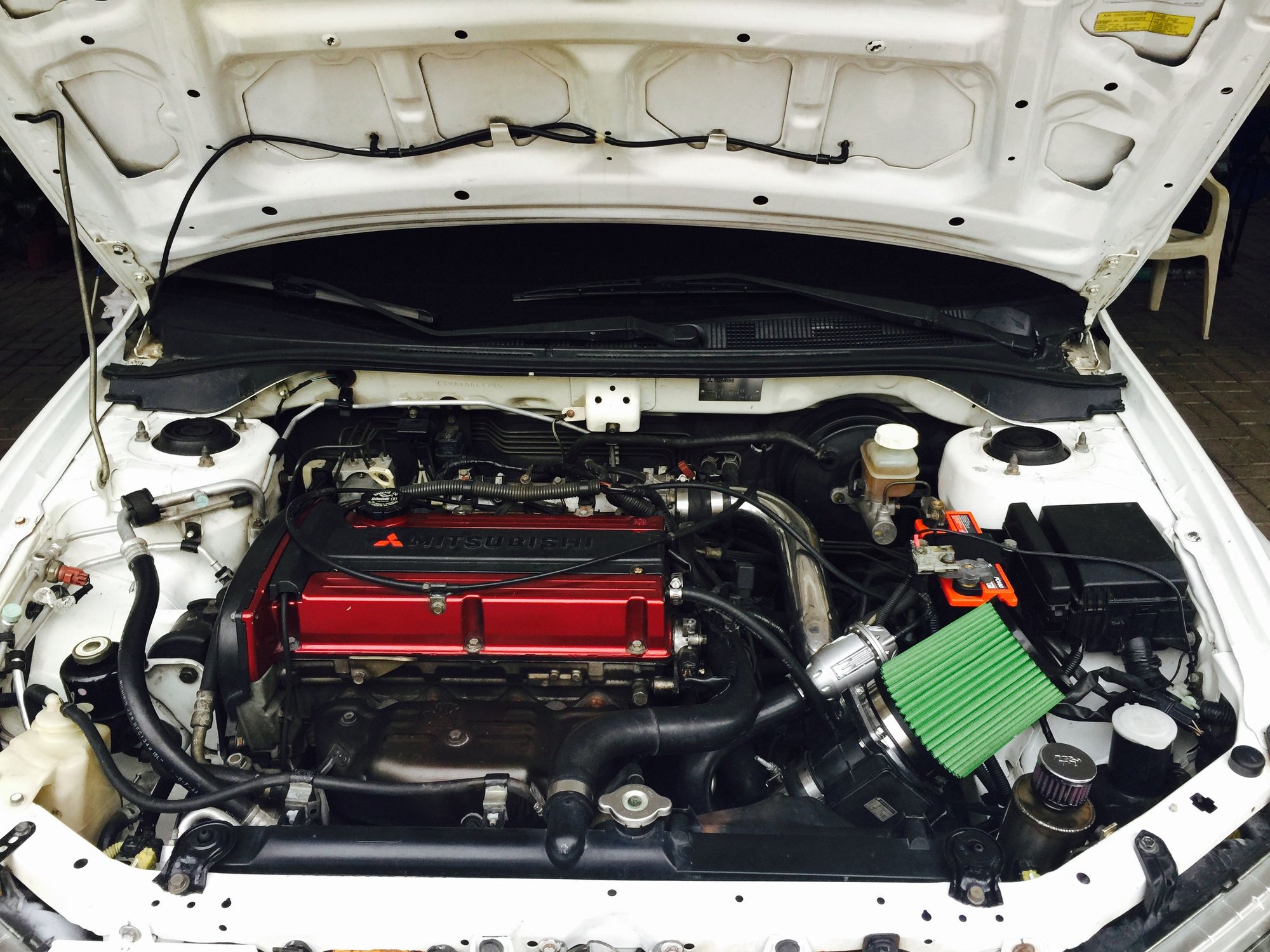

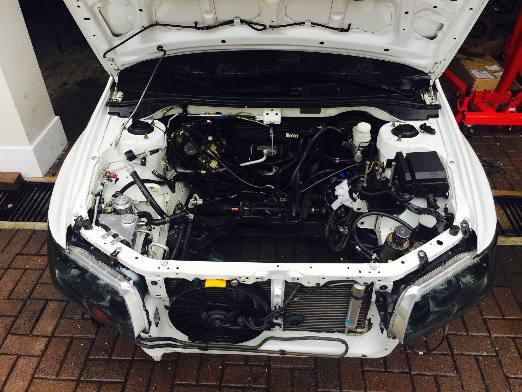

So engine was taken out a week or so ago. Did not had time to post anything so adding on old material. Head was disassembled like 2 months ago when the valve cover was taken off. It took me almost 2 - 3 months to only figure out what we kind of wanted with the build. Goals is hitting the 800whp with high comp and the 6466 with built internals and head. It will not be a drag car but a high hp toy for whenever I feel like ****ting myself hahaha.
Engine out
Engine bay cleaned up
