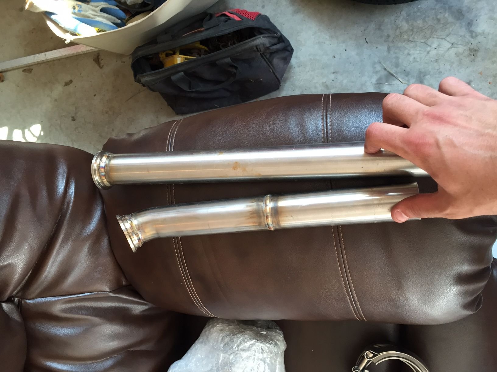

Swapped the curt Brown ported manifold and Tb for an AMS F1-I and Boomba 75mm
