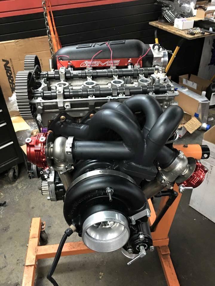

Figured id start a new thread and update my post with pics and the build list.
Shout out to The Shop in Norwalk CT and STM
Matte Black Wrap will be going on when its ready for spring.
So here it is:
2.3 Stroker Built by Godwin and Singer
The engine has the following machine work:
Line home mains
Surfaced deck
Magna fluxed
Bore/hone .020" over
Rotating assembly balanced to zero grams
Block clearanced for stroker installation
Pin fit
Parts:
Manley knife edge crank
FFWD vader aluminum rods
FFWD coated rod and main bearings (clevite)
Wiseco HD2 10.5:1 pistons with Armor Coating, .225" wall tool steel pins
OEM oil pump and gears
ARP mains
GMB water pump
OEM timing components
Buschur baffled drag oil pan
AMS zero balance, balance shaft
Curt Brown Built and ported head w/L19 arp studs
Cosworth High Rev Springs + Ti Retainers
GSC SS Valves
GSC S3 Billet Cams
OEM Lifters
OEM Rocker Arms
Aem Cam Gears
AMS F1-I intake manifold with MAP phenolic heat spacer
Boomba 75mm TB
Torque Solutions 4 Piece Race Mounts
RRT Trans
Exedy Triple
TRE Built Transfer Case
ATS/Carbonetics 1.5 Way Rear Diff
Buschur Moustache Bar
PST 1 Piece Carbon Fiber Driveshaft w/ Aluminum Yoke Upgrade
Full Race Forward Facing EFR 9180 turbo kit (Coated Black)
2 Tial MV-R Wastegates
Borg Warner EFR 9180 1.05 ar EW (1.45 on standby)
Full race Custom test pipe
STM Small battery Kit
Full-Race 3.5" DP
Full-Race 3.5" Test pipe
Custom STM 3.5" Dump Exhaust
STM Power Steering Reservoir (Black)
STM Coolant Overflow Reservoir (Black)
H&R Coilovers
Drag and Drift Performance Billet Rear Control Arms
STM Upper intercooler Piping 3" (Black) w/Tial 44mm BOV
STM Forward Facing Lower Intercooler Piping
ETS 4" intercooler
Borg Warner EBC
FIC 2150 Injectors
Aeromotive 15 gallon fuel cell with Eliminator Pump
Aeromotive Fuel Pump controller
Aeromotive Inline Fuel Filter
Aermotive Fuel Pressure regulator
Aem V2 EMS
Sparktech Sequential COP
Rexpeed Carbon Shift Knob
Bride Ergo II (Gradation) (Real Brides)
Buschur Quick Release Harness Bar (Black)
3" Corbeau Cam-lock Harnesses
Seibon CW Style Carbon Fiber Hood
C-West Front bumper
Aerocatch Hood pins (Carbon)
Rallytech LTD Custom Rear Seat Delete
Rallytech Custom Carbon Shifter Console
BeatRush Floor Brace
FSX Racing V mount Wing
FSX Racing Custom "Race" Splitter
FSX Racing Splitter End Plates
Carbon Fiber Dash w/ AEM Gauges
-Wideband
-Oil Pressure
-Boost
Personal Steering wheel w/ works bell hub
FSX Racing V Mount Spoiler
JDM Amber Side Markers
JDM Black door Handles
JDM Rear
JDM Evo 9 Tail Lights
DBA 4000 T3 Slotted Rotors
Hawk HP Plus Pads
Goodrich Stainless Brake Lines
Work M1R 18x9 Hyper Bronze w/ Nitto nt05 245/40/18
NRG Aluminum Lugs (Matte Black)
Koyo Half Rad
Heres the monster put together...

Old Oct 1, 2015 | 08:34 AM
d-bo's Avatar
Joined: Jun 2009
Posts: 371
From: 716NY
Haven't seen many 2.3 aluminum rod setups. Sounds interesting for sure
Old Oct 1, 2015 | 12:27 PM
03Roush2's Avatar
Joined: Oct 2014
Posts: 95
From: New York
updated pics!

Old Oct 13, 2015 | 03:31 PM
03Roush2's Avatar
Joined: Oct 2014
Posts: 95
From: New York
Engine is in!!!!
