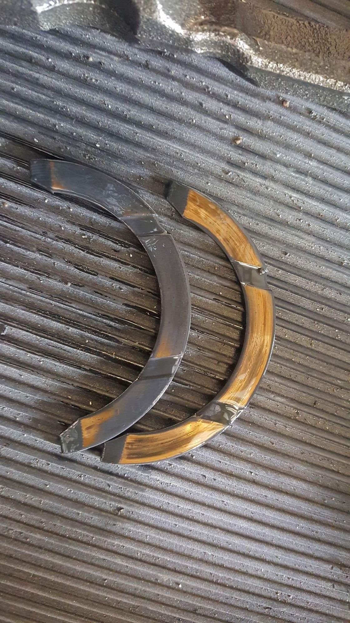

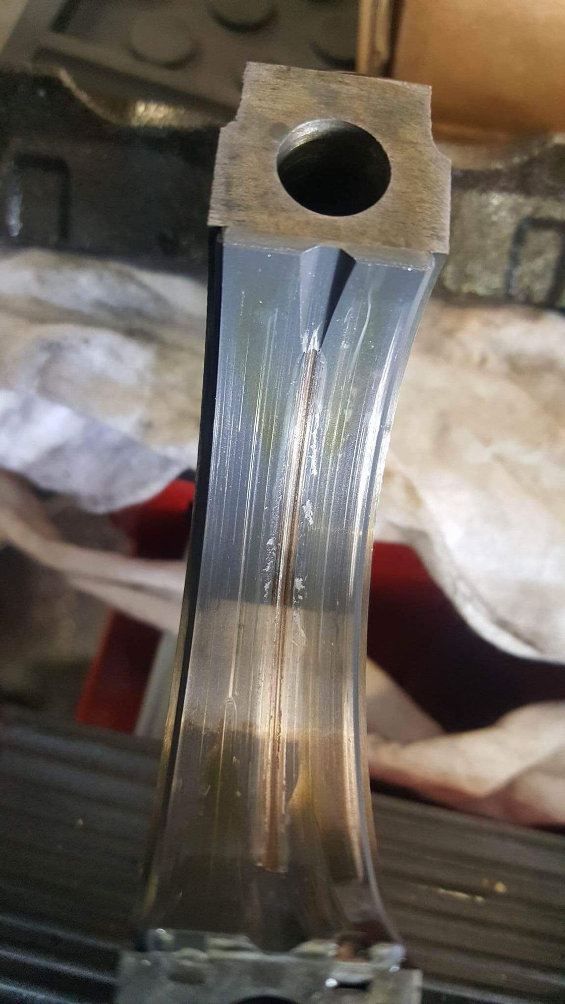

February of 2017 I wanted to build the head of the car through "Heads by Drew" here in Colorado. I was recommended to him from a well known evo builder out here. Turns out when everything was torn apart the bearings were ****ting out on me, found glitter in the oil pan. Said screw it, the motor hasn't been built in years so lets just go all out.

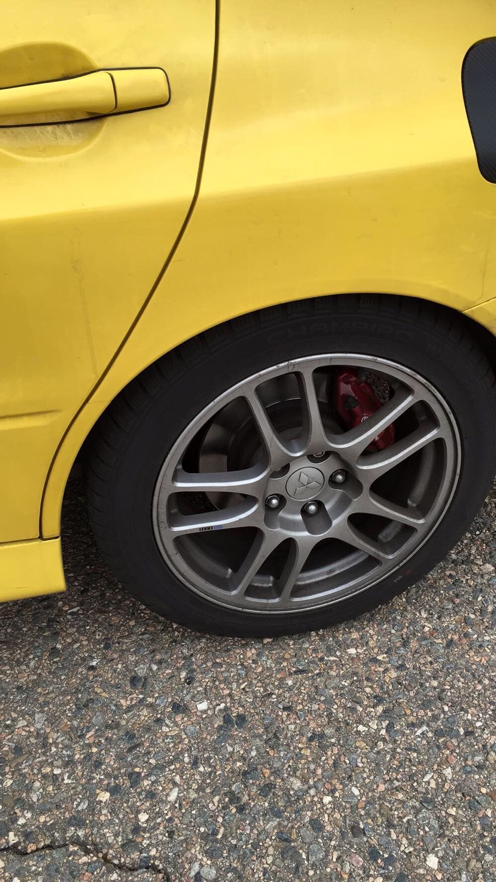

Wanted to grab different wheels before she got picked up, as well as swap out my trunk. The original trunk was just an RS painted one I wanted to wrap in carbon, but I got a great deal on an OEM seibon carbon fiber one so I figured why not. Also grabbed new wheels from a buddy which was cool

Found the bearings beat to the copper
Eh said screw it lets just rebuild the entire thing. It's time To freshen her up

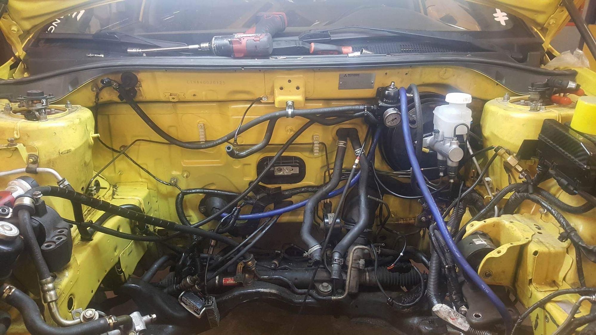

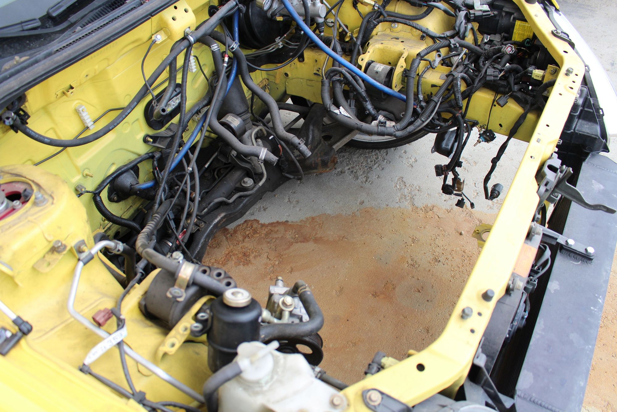

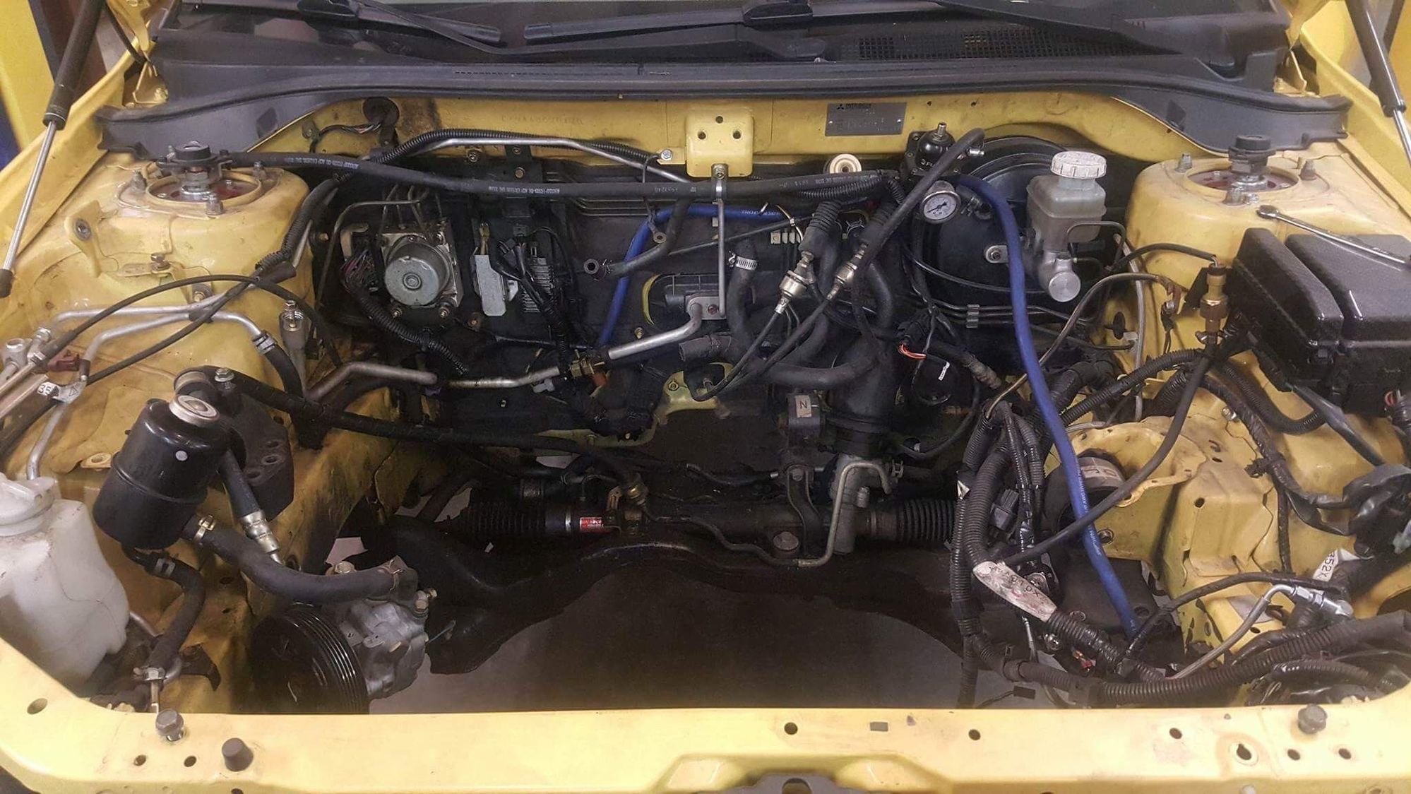

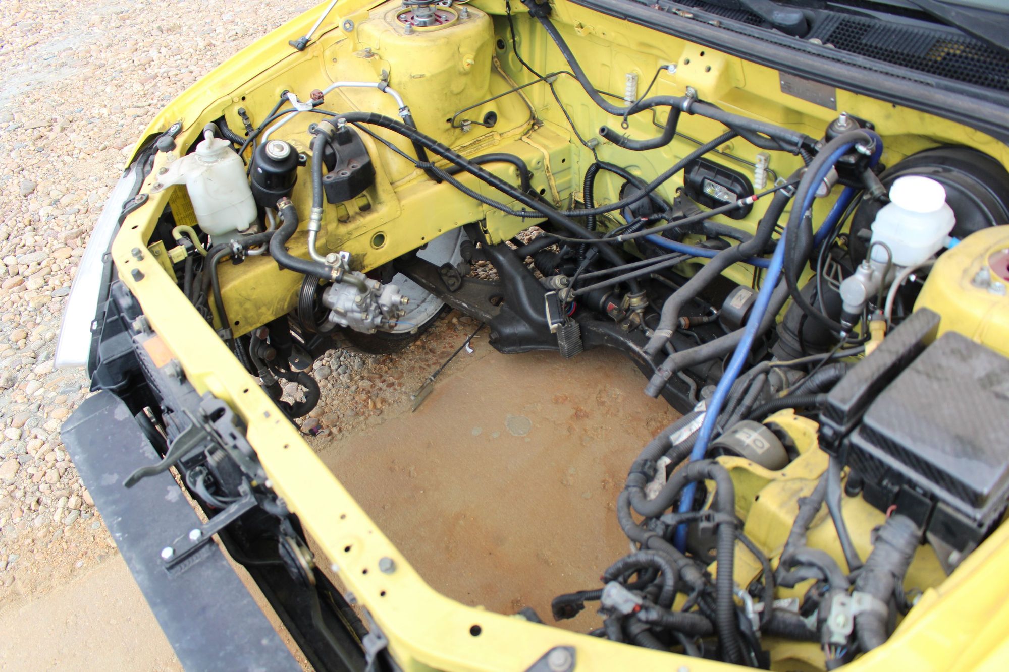

Sorry about so many replies. This mobile version was acting funny. But since the engine was pulled I needed to find other ways to lighten this turd up
Firewall material was pulled out. Figured I would lose the AC as well. Took out the ABS brakes, and was planning on pulling power steering
Thinking I would get new mounts as well so it's not so shaky in there. Although for an 04' it only has 50k miles so the mounts weren't in bad shape
Definitely does look better with the firewall material pulled. Now to tuck some wires
