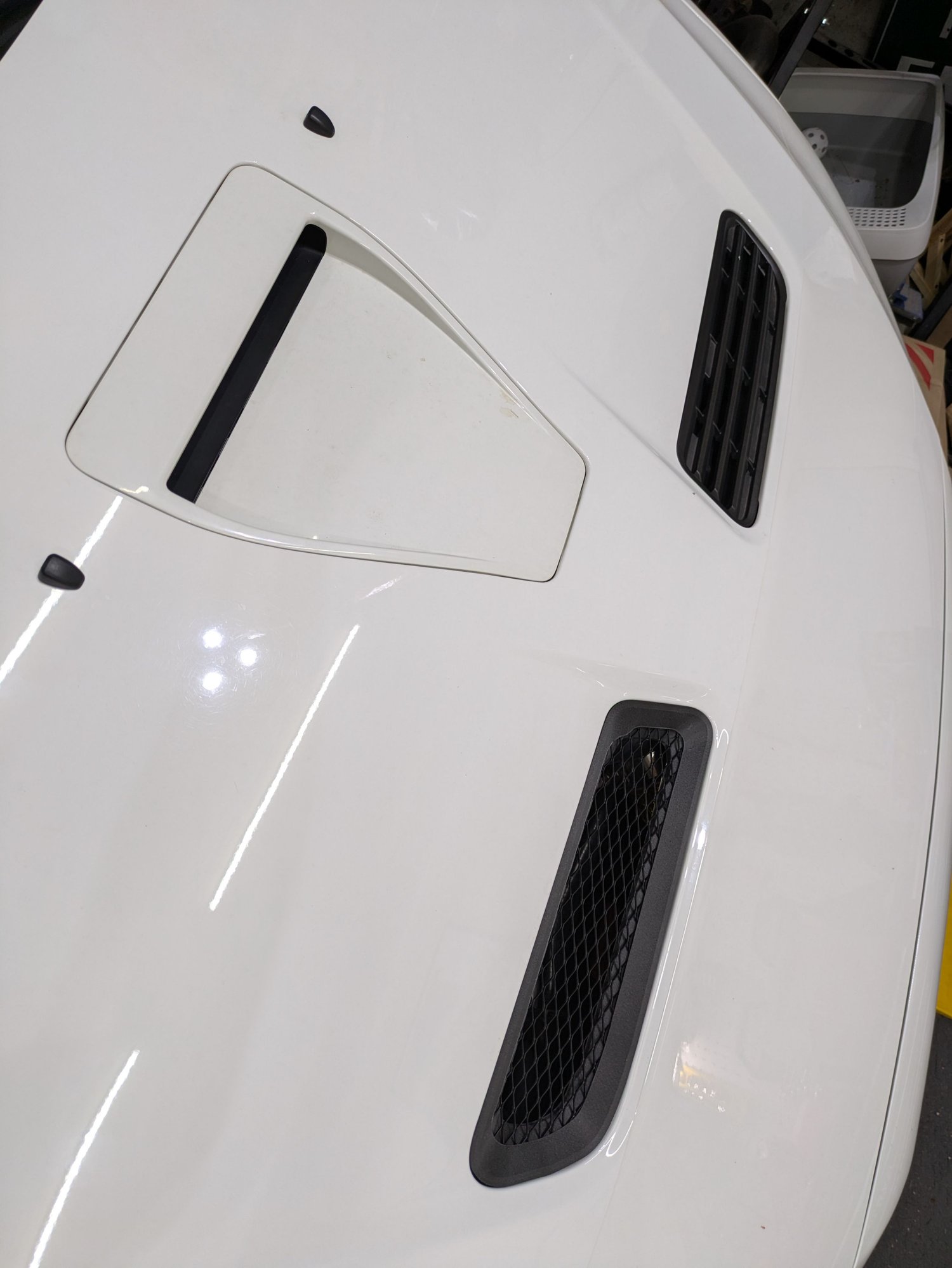

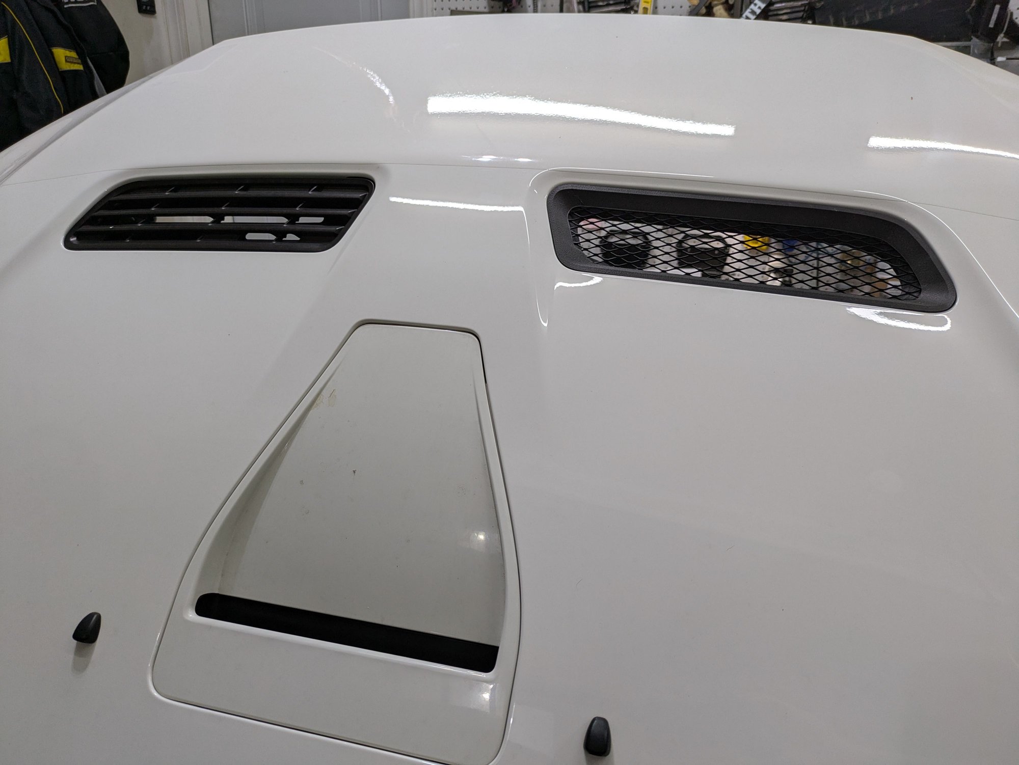

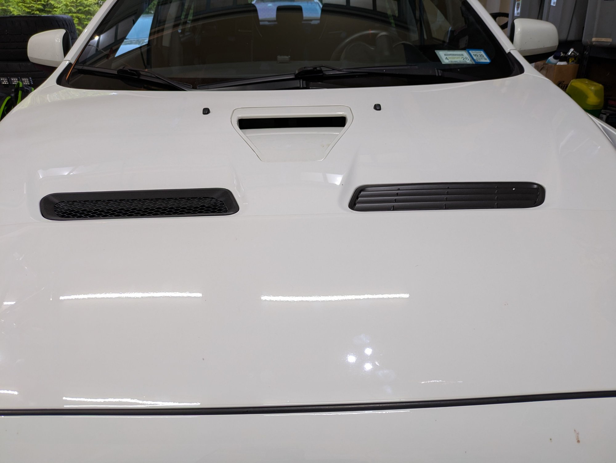

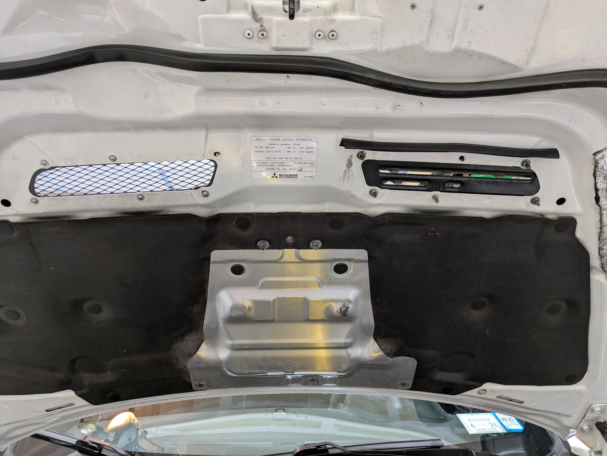

Hood vent project is wrapping up. Maybe I will list these on Etsy through my wife's store if there is interest.
yes I missed a screw!

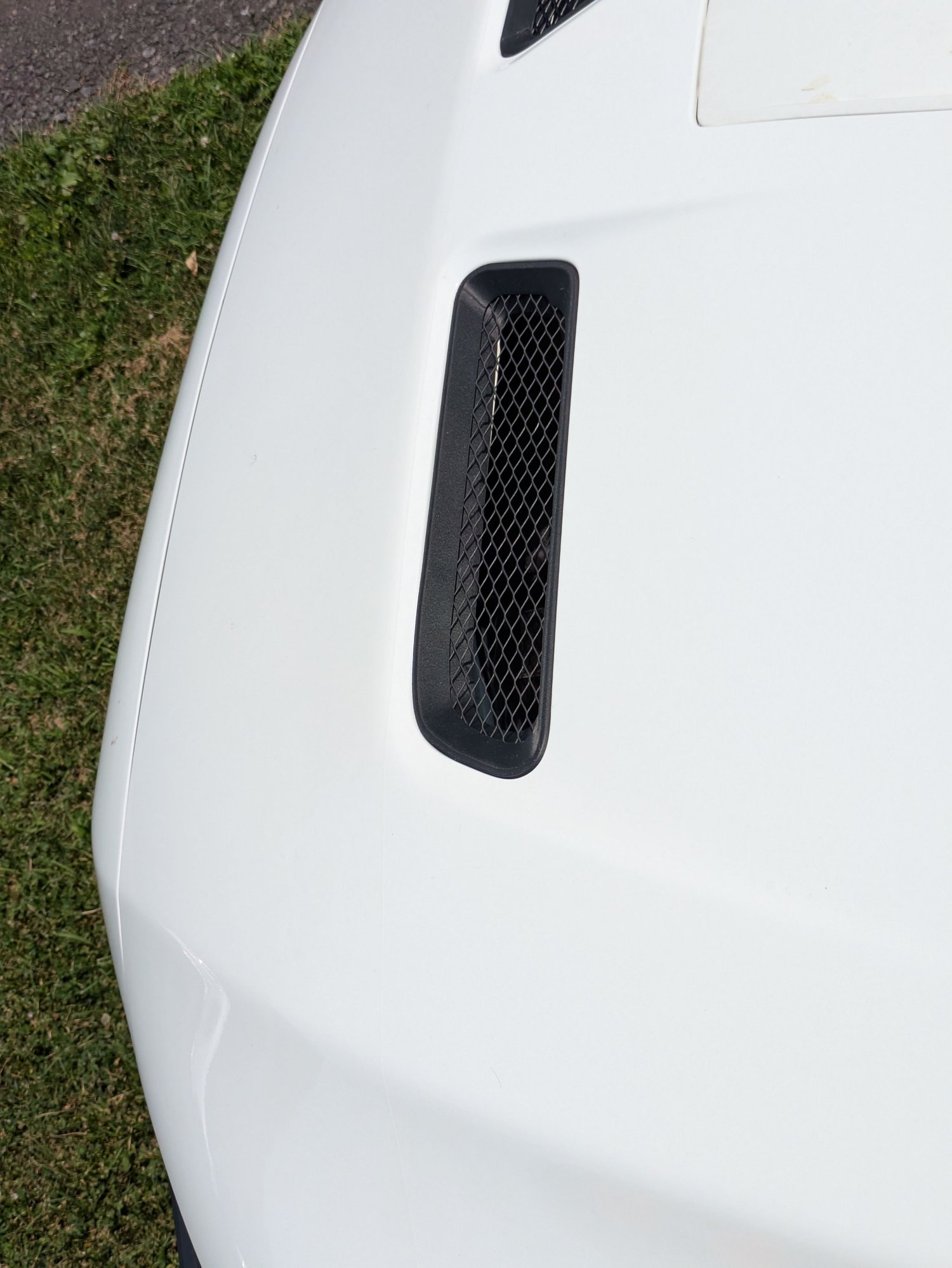

Porsche 992 GT3 hood vent:
My custom EVO X hood vent (based on that style);

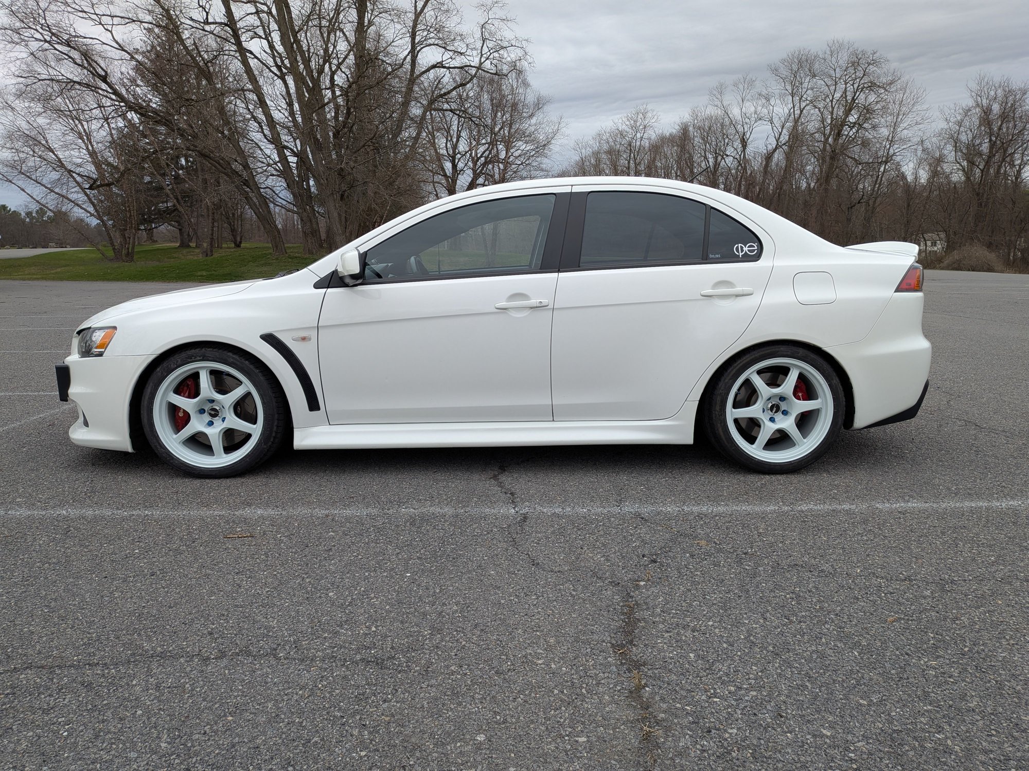

The WICKED WHITE MR is still alive! Before even taking her out of the garage, my son and I laser measured and adjusted each Ohlins R/T coilover. Mind the GAP!
The most offensive corner (drivers front) needed to drop 14mm. We used rear passenger as ZERO as that gap looked perfect and made everything match that.
We also swapped on white light weight Konig wheels with Pirelli P Zero tires (220 TW) so I am not just eating up the RE71-RS tires driving around. Those tires were SICK on the track, and I want to use them on the track exclusively. This might be the year of 650hp, if I can stomach the downtime..
