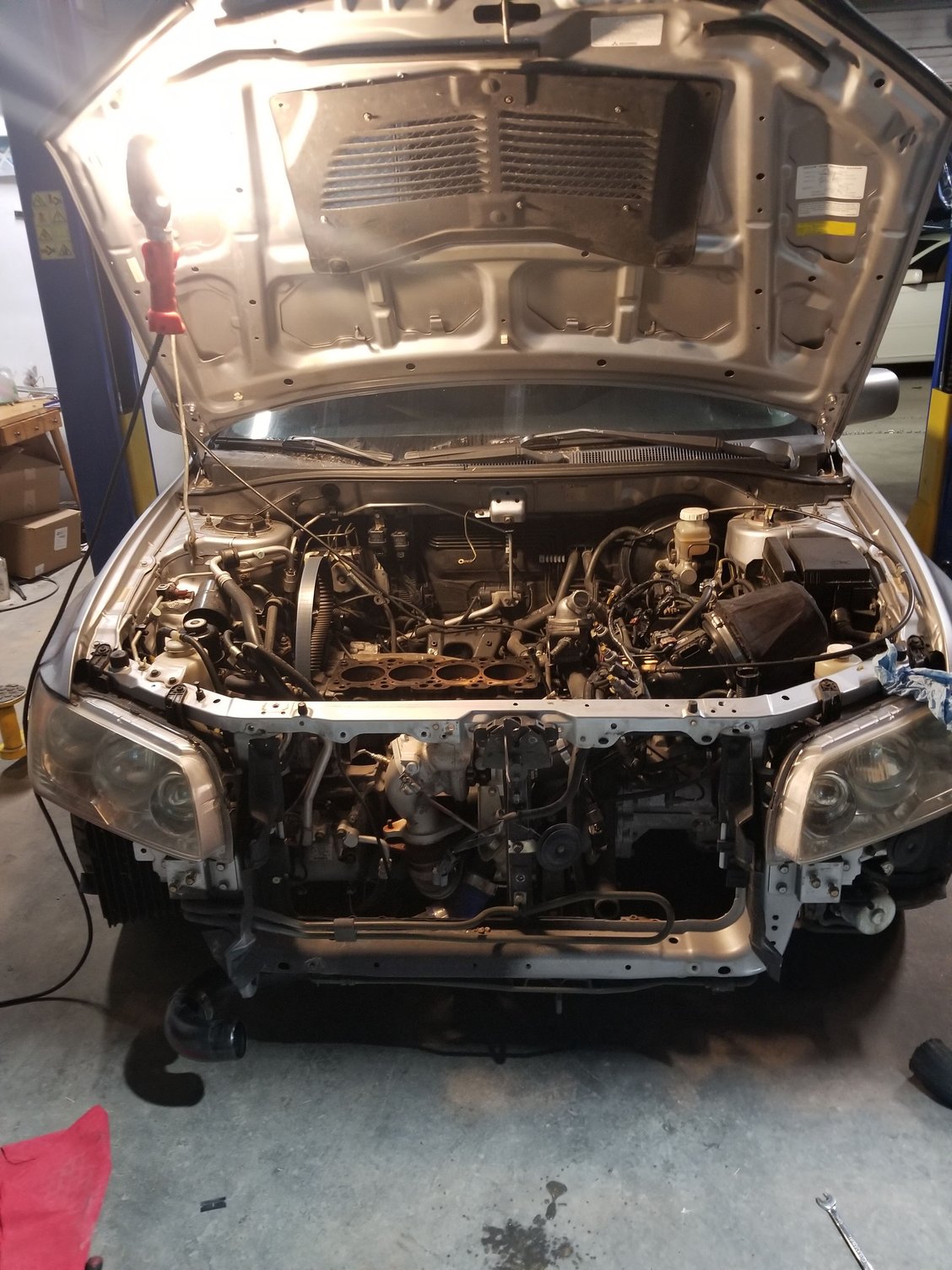

Started off bone stock , I traveled 14 hours from Texas to pick her up

Head comes off for full rebuild of the best parts to help get to 600hp

Some goodies for the head to help get me to the 600+hp range
Starfab stage 3 Port & Polished / Decked
Supertech Dual valve springs
Supertech Titanium retainers
Supertech +1mm over exhaust valves black nitride coated
Supertech +1mm over intake valves inconel
GSC zero tick lifters
Kelford 280 camshafts
Kiggly HLA
ARP 625+ head studs

Need to link up once I finish up ! I'm using a gen 2 PTE 6466

Just posted the head work mods

HKS cam gears
AMS f1-i intake manifols
Boomba 75mm tb
Koyo half sized radiator( because my car retains AC still )
Sheepey evo IC piping kit

Wait so you're spending all this money on the head, most of which isn't needed to get to 600whp, and you're not building the bottom end...

As for my fuel set up I went with the full blown double pumper
With 255lph pumps X2 .
AMS fuel rail
Precision 1000cc injectors
Magnus FPR
Currently working on this atm . Stock fuel lines being removed and
Running -8 feed and -6 e85 safe fuel line from tank to rail and FPR.
Also had to add an inline fuel filter.

I did all the head work so WHEN I do the bottom end I won't have to touch the head besides Injectors . Car will make over 800+ later. Was just short on time for tx2k

Spoolin COP
Tial 44mm bov
Tial mvr 44mm waste gate

1 off turbo mani FF V band
Gen 2 PTE 6466 V band
