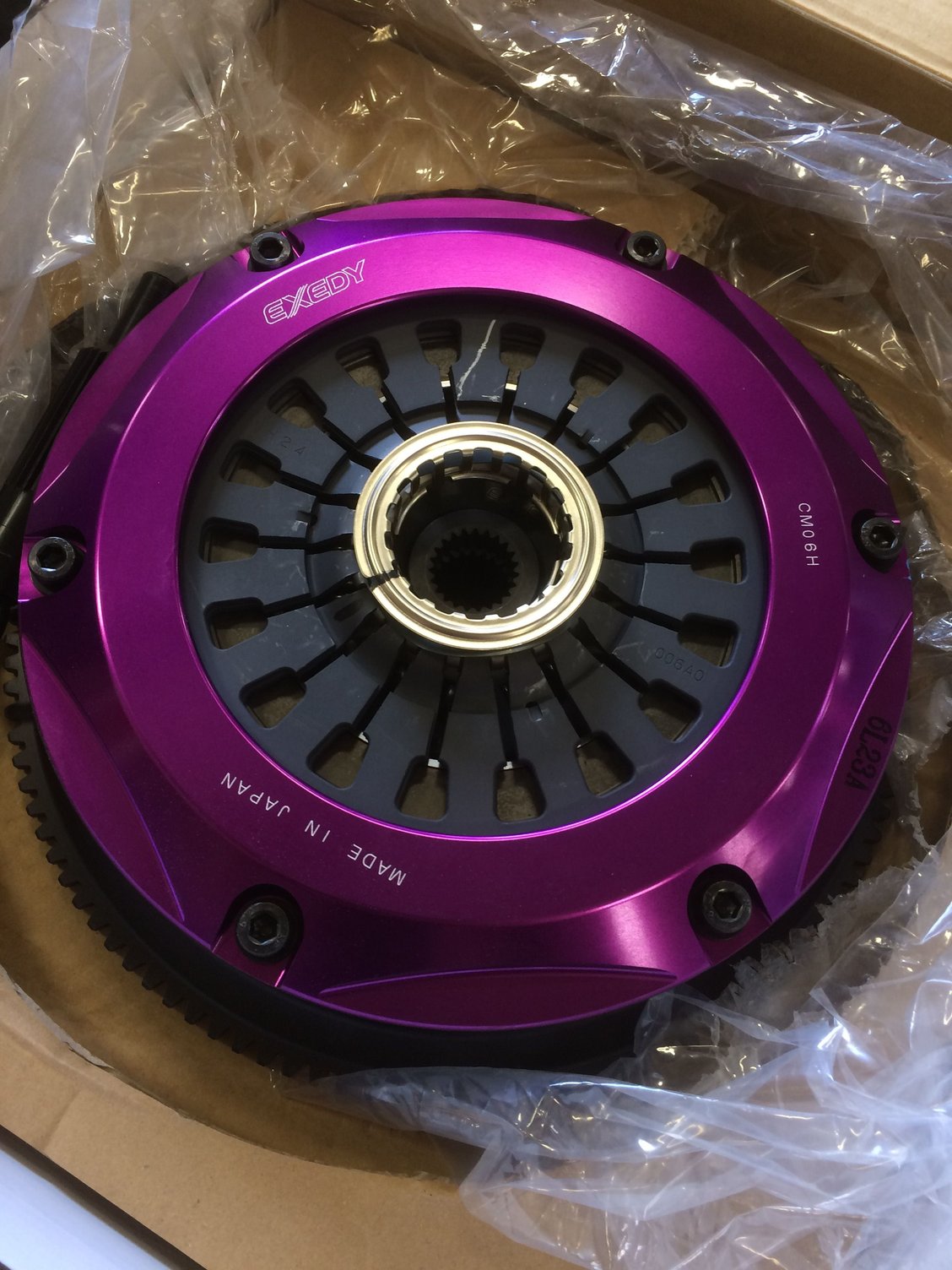

Shimming helps take some of the slack out of the gear set. Here's a DIY article on transmission rebuilds that has quite a bit of helpful information on it. Exedy twin disc HD definitely will help out quite a bit. In my opinion best clutch you can buy for these cars unless you're building something that's higher horsepower. Every exedy twin HD car I've driven feels like it's got a stock clutch with just a little heavier pressure plate on it.
thank you for that link , I should be getting the engine any day now , pretty excited haha , I hope the exedy twin isn't to awefully loud , another thing I wanted to ask fellow members on the forum is about lifters , a lot of people tell me to reuse mine but the engine had high mileage to begin with anyone have any input ? I know new there very expensive and Iv also herd that gsc's brake ? Could be false info but any advise on that would also be great
You will notice a little chatter when you press the pedal in from the disc vibrating on the floater plate but other than that its not noisy at all. Personally I love the twin hd, By far the most street friendly twin disc i have ever drive. I have the exedy triple in my car at the moment and for a triple disc clutch its honestly not bad at all either. I have read a lot of negative review on the GSC no tick lifters. Few people said that they are taller than the OEM ones and actually cause valves to stay open and not seal properly. I actually bought a set and sent them back because i didn't want to chance it with all the negative reviews I read. The OEM lifter are probably the best lifters you can use. If they are bleed properly you shouldn't have any issues at all. But they are rather spendy for a new set if you don't wanna reuse them. I actually run ITM revise lifters in my car. I have done so for 5 years now and they have been awesome lifters. They aren't overly expensive. you can get a new set of them for around $115 off ebay. (https://www.ebay.com/itm/ITM-REVISED...wAAOSwk-1aRxLj). There is a link to them if you'd like to check them out.
you have had good luck with those lifters? my clutch came in man is it a beauty . Hopefully the engine gets here Monday so I can start putting things back together and get this car started

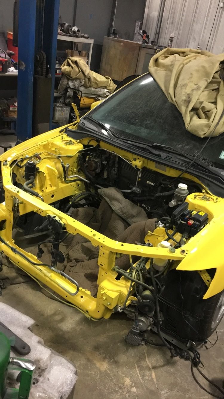

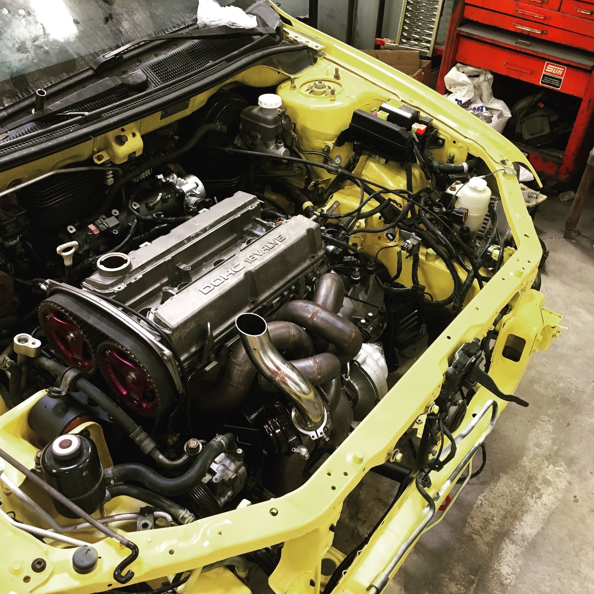

Sorry iv been so mia guys iv been so busy at my shop iv finally made some progress

I’m really excited to get the car going , to think October will be owning this car for two years and it was literally driven for less then a week , I can’t wait to hear it running

Thank you for the pics! Should be fun to crank that motor the first time!
