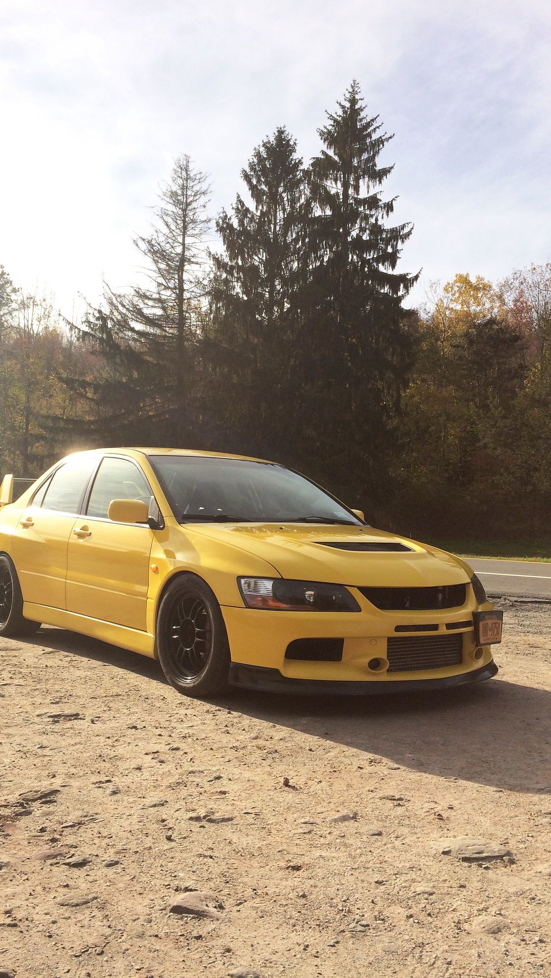

Thanks Jonathan
EvO looks great, especially that shot of the Enkei's

thanks ! I since have sold the rpf1's I really want to get a set of te37, advan rg2 or ray 57cr, I just don't know if I'm going to have to roll my quarters witch I don't want to do but I also want to stay 17 and possibly go with gtr face offset specs , but yes there's actually two peices of the piston missing , your going to call me crazy but I have a conspiracy theory that the piston broke before hand (big chunk) and it held compression they threw a new head on it and sent it and I think the guy who I got it from bought it cheap without knowing what was wrong and it ended up getting passed to me I'm guessing it just detonated and that small part broke off ? I'm not to sure because the head wasn't bad at all really had me baffled lol and that's correct that's a picture of the engine being sent
