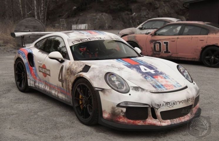

Originally Posted by DontStopMe
Yup, I have a family and full time gig, plus some side jobs. (Side jobs are the only reason i can afford this evo project)
The more i dig, the more i lean towards "Ugly/cheap/unique" evo. Maybe not so far as the example you've shown, but it will probably be something a bit different when all said and done. Leave the exterior rust, but fix rust where it matter. Maybe a retro rusty beater looking 500awhp monster
Patina-sytled Evo? Embrace the rust!

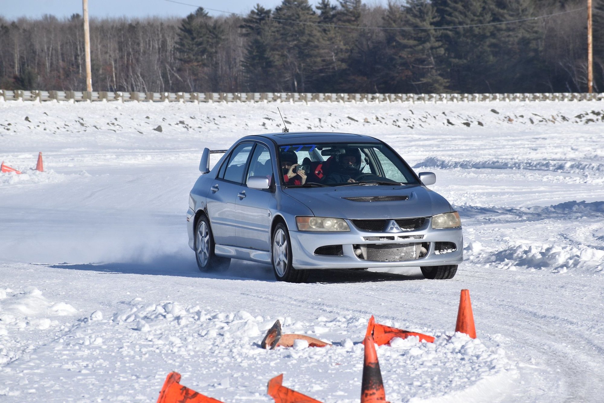

Old Jan 30, 2023 | 06:34 AM
DontStopMe's Avatar
Joined: Apr 2008
Posts: 750
Likes: 246
From: Wisconsin
Finally drove the rusty evo again at the first ice racing event of the season. It didn't see much action over the summer since the dirt spectator races are no longer a thing. But this rusty thing is still holding up!
