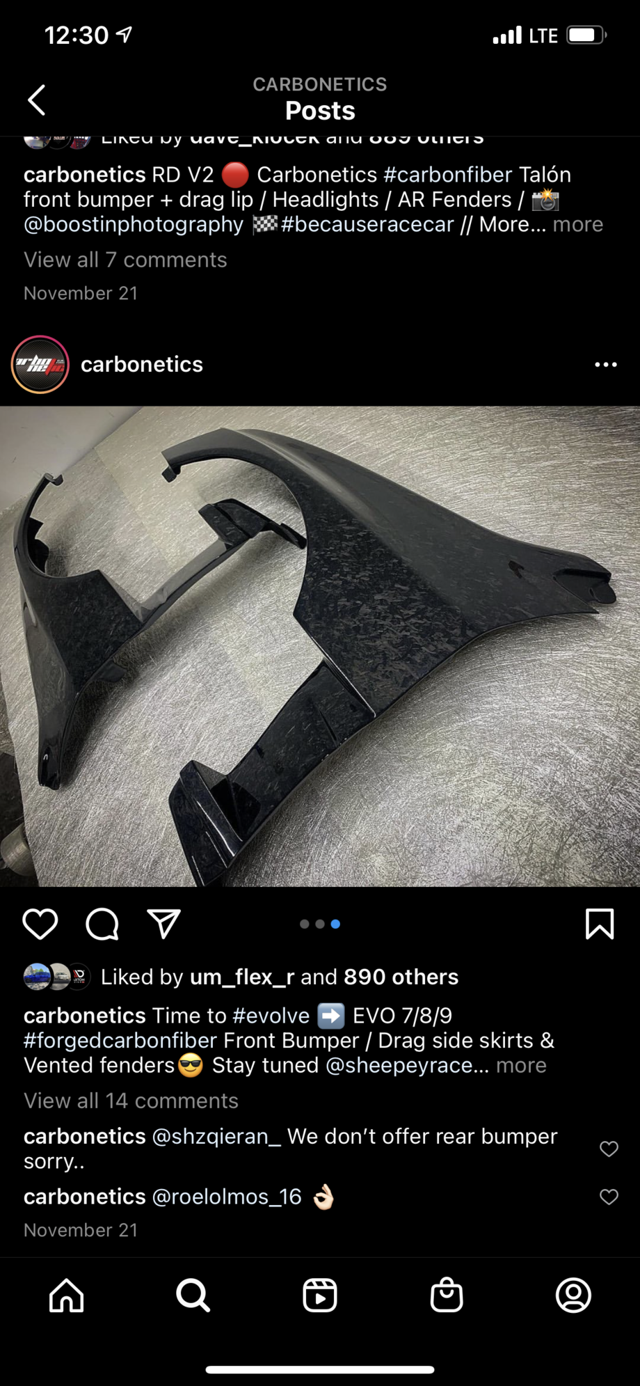

Carbonetics just shipped my Forged Carbon Fenders.
Really never been one for aesthetics but those really caught my eye.
sounds different, can you post up some pics when they come in?
These. Saw them on Sheepey Giveaway Car and fell in love.
