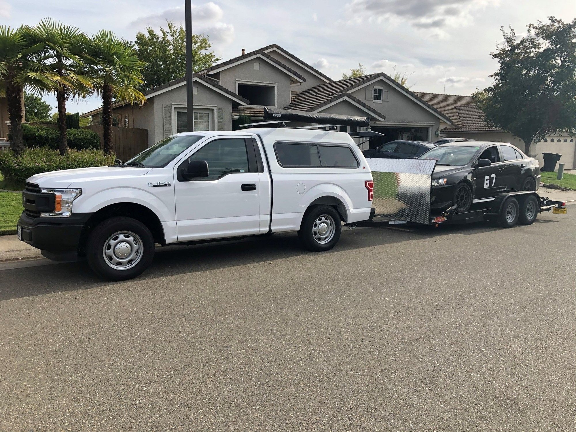

Now a little background. I bought an Evo X MR in Concord, CA on my 50th birthday in August 2011. I did my first HPDE at Thunder Hill six months later and was hooked. Over the next five years I did the requisite track mods and did about 40 track days before putting the X into the turn 9 wall as Sonoma in November 2016. Bought my current 2011 and had most of the parts transferred from the wrecked car. Kept the drive train and the Brembos. In 2018/2019 I suffered a series of unrelated mechanical failures and had to limp home early from a number of track days. After suffering catastrophic turbo failure at the track in mid 2019, I decided to take a brake from the track until I could get a proper tow rig.
Last year I bought a new 2019 F-150 that had been sitting on the lot for over a year. I also bought a new 16 foot Carson trailer. I got a camper top and air bags and an awning the goes on the side of the truck. I still need to build some tire racks in the back of the truck. The picture is before I got the air bags.

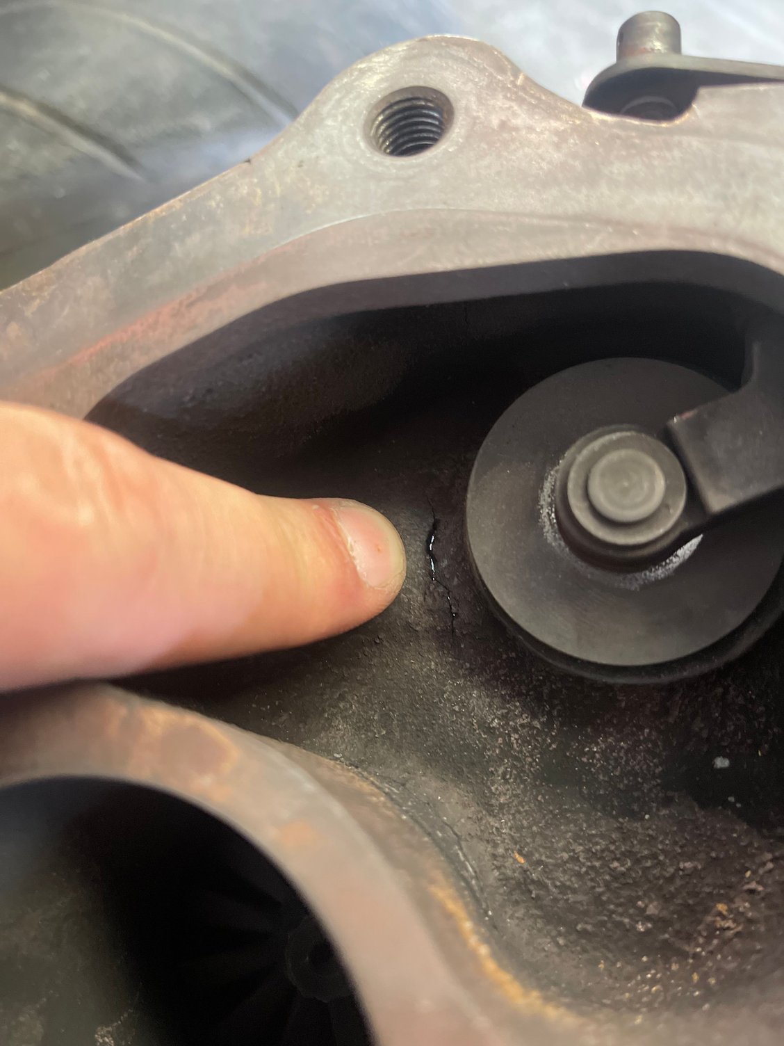

Jul 5, 2021 | 03:21 PM
Quote: Well I was supposed to pick the car up yesterday but got a call Friday afternoon that they were still chasing down a boost leak. The ruled out the new ETS stuff and now they think its at the manifold. Best case its just a gasket (for once maybe I'll get lucky).
MAP manifold is good, turbo not so much. Crack in the wastegate housing.

Jul 8, 2021 | 09:12 PM
Quote: Wastegate is easy to swap out and can be done in the engine bay.
Picture of said crack. Not going to repair because I'm looking for excuse to replace.
Reply 0
Jul 13, 2021 | 10:12 PM
Quote: Picture of said crack. Not going to repair because I'm looking for excuse to replace.
Oh I thought something related to the wastegate failed. This is on the turbo hotside. You can buy a replacement hotside on ebay, used turbo, or a new turbo. Definitely not a cheap fix like swapping in a new wastegate.
