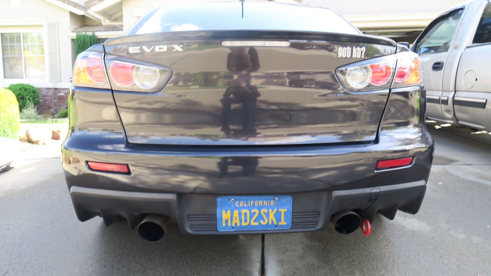

Got some new Torque Solutions motor and trans mounts installed and a couple of the problem bolts and went down to Sonoma and got in a full track day (actually I bailed on the sixth session). I could definitely feel the added power but I was also taking it pretty easy and was about 10 seconds off my PB. However, I was about 10 mph faster heading into turn 7 (one of only two straight sections of Sonoma). Here's some pics of some of the new goodies, including additional hood vents for those 100+ degree Thunderhill days.
The exhaust sounds marvelous. It finally sounds like a race car but should still be quiet enough to pass even the most onerous sound limits.
The end results with about 22 psi boost was about 40 whp over my prior tune at about 18 psi boost. AFR begins to lean out at about 7000 rpm.

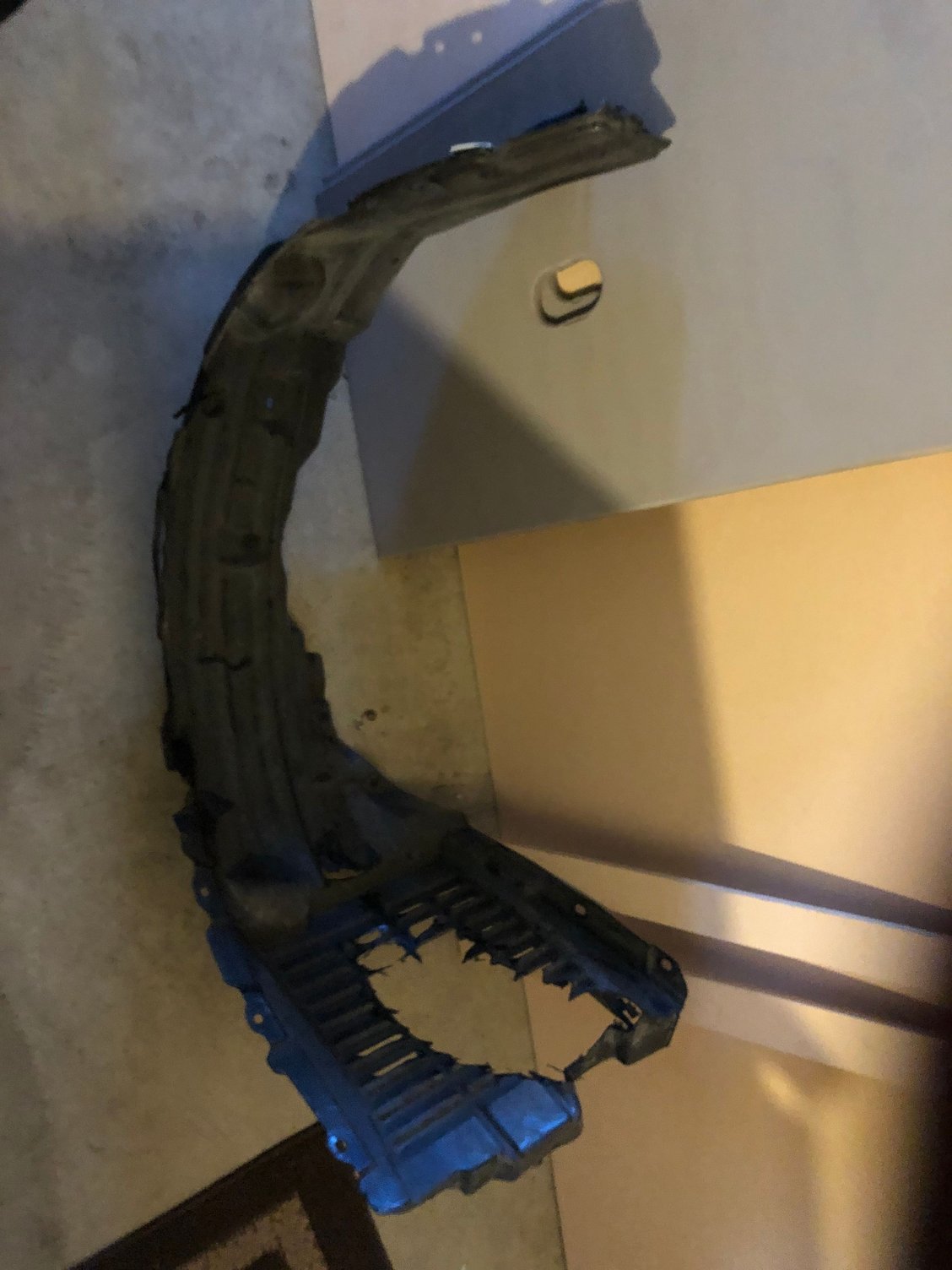

The only fail of the day was my left front wheel well liner.
I'm running 18x9.5 +25 Konig Hypergrams with 275/35R18 RE71s. I've run other tracks with these wheels and tires with no issues. My guess is that I was rubbing the left tire on the liner in the Turn 11 right hand hairpin. So I'm probably going to get some spacers and roll the fender as needed. This will be a bit of a PITA since I will also need to replace my ARP studs with longer ones.

260wtq/320whp with a GTX3017R? good lord. You need to find another tuner. I really do not understand why people are still going to doesn't works.
What kind of laps are you running at Thunderhill?
Spacers will make your issue worse. I run 18x10.5 with 275 and do not destroy fender liners like that.
Why? What might be my problem?
I think you are correct. Going to take a look at the other well to see it that's rubbing at full wheel lock.
