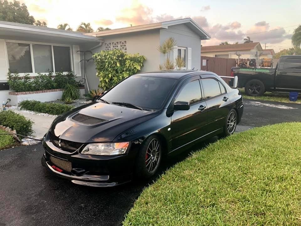

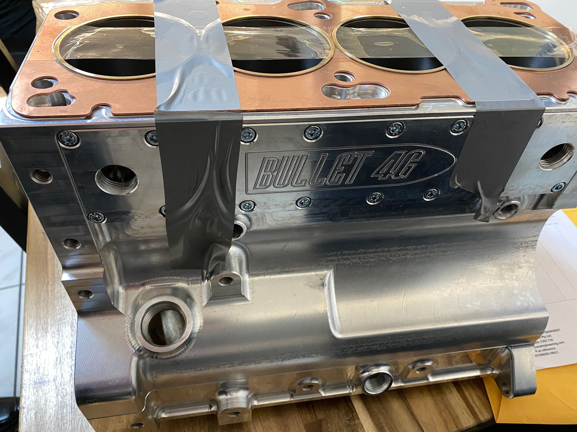

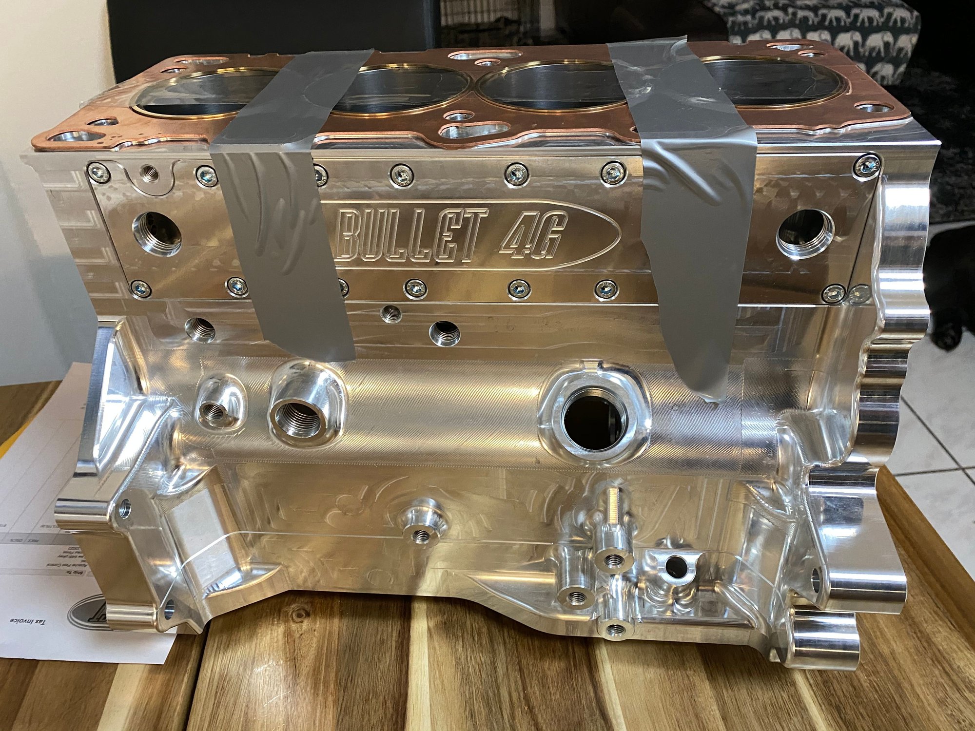

I’m in the process of rebuilding my Evo 9 with 1200hp as my goal. I was making 820 on 6466 for a while until I spun a bearing and sent a rod through the block. I’m building a 2.3 bullet billet dry deck block and as of now, I’m pretty sure I’m going with the xona 112-69. I love the ff kits with exhaust coming out the hood or side exit but I also love a oem look/sleeper. Cars about sprayed soon (I’m stuck between black again or interlagos metallic blue from 06 M3). Working on getting the head to the machine shop and getting the magnus billet t case and wheel and pinion. Already got custom cp pistons and aluminum rods, callies billet crank 100mm, haltech elite 2500 (upgrading from Aem v2). Still have so much to get done haha.
also, what are your thoughts on like a 100 shot? I’ve heard mixed feelings about on on the 4gs.
