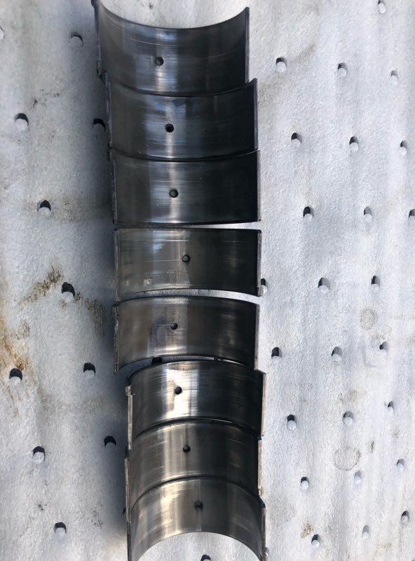

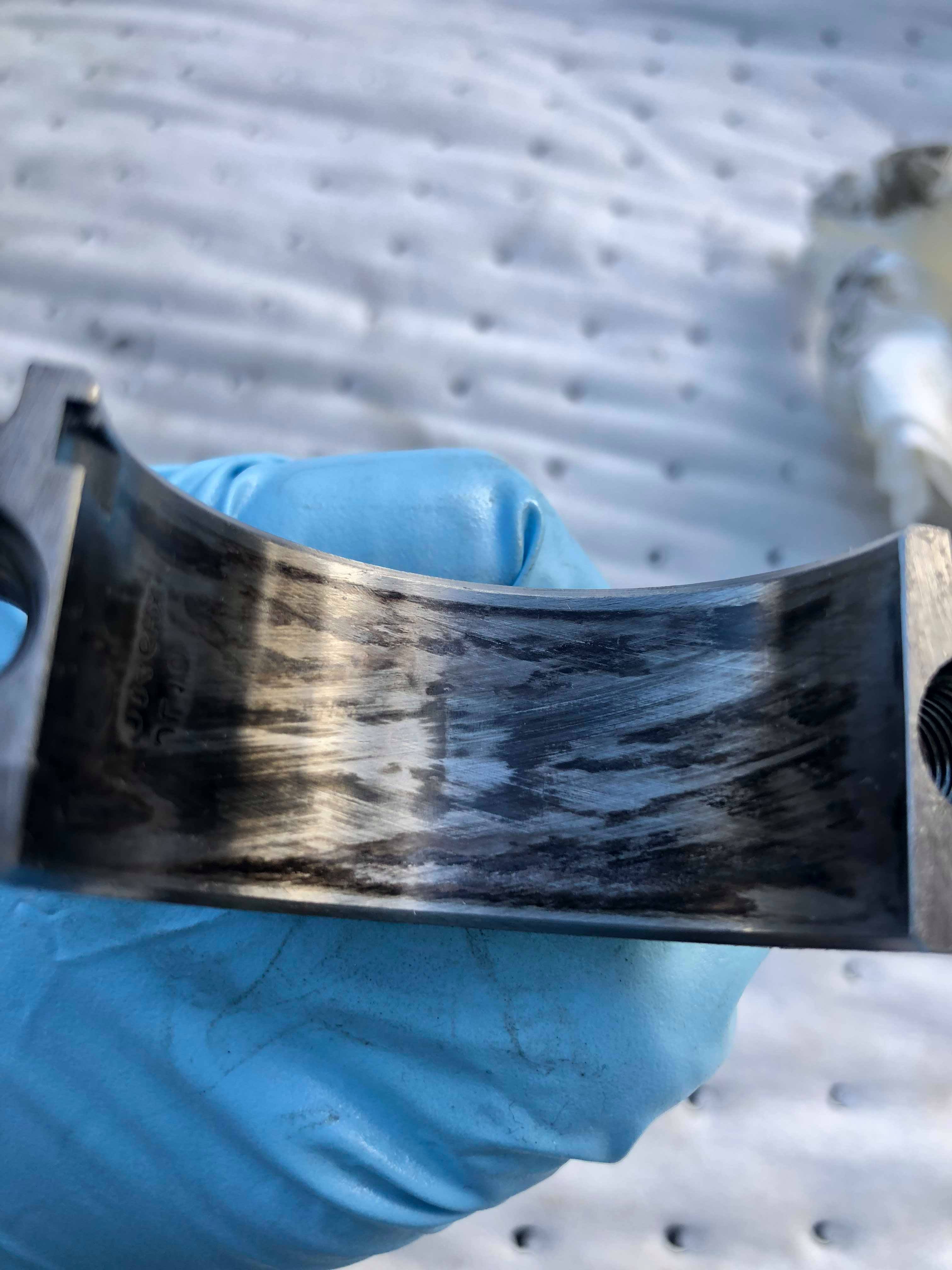

Hey everyone I've got a guy locally with a 4g64 stock crank, r&r steel rods and wiseco Pistons. I'm trying to decide if it is worth it to purchase as the price is good but the crank will not be used, and the Pistons likely can't be used either. Here are all pictures of the journals and the wear when removed from the block. In worried about what looks like heat marks on the rod journals below where the bearing would be. Please share your thoughts on if these would be usable.

A little follow up, I called Mike at R&R rods and he says that the rods dont look bad at all and the black marks are typical. I also took these pictures to the machine shop I will be using for the work and he reiterated that statement. Outside of measuring the current bore to ensure I can use the block, and measuring the rod length, is there anything else I should check prior to purchase? New Crank and Pistons will be purchased so the block and rods are all I am looking at utilizing.

Block and rods look OK to me. Like you have been told, the bearing bores of the rod look typical.

wow, those bearings are washed out (but im no expert)! from the pics, the bearing journals look good allthough the builder would likely line bore it if Im not mistaken. make sure to check the thrust bearing journal as well, make sure the bearing cant move around at all when its captured in there as thats one thing the shop cant fix.

You are talking to the engine builder and the machinist felt very comfortable using those rods again. The block ended up being no good and I returned this one in the pictures for a different one. The main bearings appeared to have been spun and ruined the block. Everything is dropped off with the machine shop and will be machined in 2-3 weeks.

That's weird, the main bores looked fine in pics. I guess its hard to tell until you measure stuff.

The mains definitely had a spun bearing, you could feel the material on the sides of the material where it squeezed itself out and to the side. Also there were high spots and low spots within the bores as well which is what we noticed first. New block is g2g.
