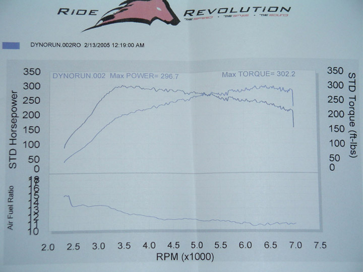

yea i may have to come down if you dont mind and hook the wideband up...i added 5% fuel, but after looking at 93civEJ1's a/f on that same day, it was around the same as mine @ 4000rpm...my graph just looked more skewed b/c it was such a small range
heres his dynosheet...you can see at around 4000 rpm he is what looks like in between 12-13:1 afr...i was around 13-13.5:1...i have no way of verifying it with no wideband however...
He needs to add alot of fuel up to about 4k rpms also, IMO. Air fuel looks fine above 4K rpm to me. The power is real jagged even in the begining. Mine is super smooth up to about 4500 RPM, then it become just slightly jagged. Oh BTW, how do you post a dyno sheet up like that. Mine are always to big to be loaded.
