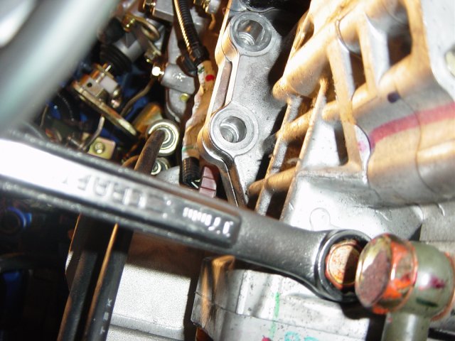

Anyways, it's similar to doing a clutch in pre 05's until you get to one of the TC bolts. The bolt that's the problem child is on the top side of the TC and is one of the harder bolts to get ahold of because of its position and because most of your access ot it is being blocked by the ACD line. Breaking the ACD line loose to get to the bolt will mean that your system will have to be bled after its put back together.
The trick that many attempt to do is to break the bolt loose behind the ACD Line/Banjo Bolt. You wont be able to unscrew the bolt connecting the tc & the trans all the way, so you will have to break it loose and then unscrew it slowly while seperating the transmission from the TC. Attempting to remove it in this way can be a bit of a pain as you're not working with much space and it's very hard to get leverage on that bolt to break it loose.
Hopefully the attached photo's will help people realize what they're up against.

Judging from this picture:
There is no way you're getting a socket with a flex head on there. A crowfoot would only help in breaking it loose but would be a pain to use for removal. I know a standard length ratcheting wrench won't fit in that area. My guess is use a crowfoot or stubby wrench modified to accept an extension and ratchet to break it lose, then use a stubby or flex ratcheting wrench to remove the both while sliding the tranny off.

I had a crowsfoot and I couldn't get hte leverage to get it off. I wound up pulling the ACD line and making a nice mess.

what I want to know is how on earth did you get a camera in there for those shots ! those bolts are a pain to reach through the wheel well with lots and lots of extension bars for the sockets ! so how did the camera get in there
Old Jun 8, 2006 | 01:20 PM
Brian's Avatar
iTrader: (16)
Joined: Mar 2005
Posts: 1,390
From: Internets
Just took the passenger side axle & downpipe off and it was easy.
