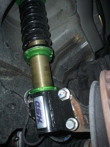

HSD Coilover Spring Rates
Model .................... Front Rate ....... Rear Rate ............ Damping ..................... Front/Rear Drop ................. Street Price
EVO 7,8,9 .................. 9.0 kg ........... 8.0 kg ................. 15-way ............................ Adjustable .................... $1334
EVO X ....................... 10.0 kg .......... 9.0 kg ................. 15-way............................ Adjustable .................... $1334
Ralliart / Lancer ........... TBA* ........ TBA* ...................... 15-way ............................. Adjustable .................... $1334
