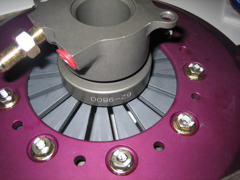

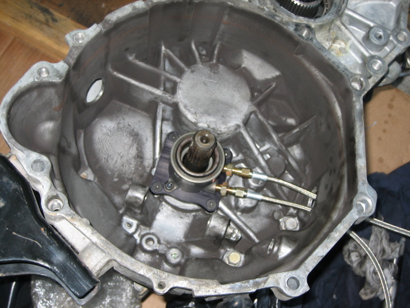

Just thought I would share... in my car over the past 6 years I've run Cusco Hyper Single, Exedy 3-paddle single, then once bolted on bigger turbo went for Exedy Twin HD. All these were good clutches and stood up to the abuse. The single paddle clutches were pain in the but to drive. The Exedy Twin was easy to drive.
Finally when drag racing the clutch slipped in 5th gear so I thought I better deal with that.
I upgraded my Exedy Twin to a Triple along with the AMS pull to push conversion. Immediately first thing I noticed was the pedal was half as light as my Exedy Twin, almost like a stock clutch pedal. Shifting so far is smoother then the Exedy Twin. We plan on visiting track soon so I will update this further when we do.
The reason I went with the push conversion is because Shep had mentioned it might make it easier to ride the Exedy clutch out of the hole when drag racing.
If the Exedy Triple holds up to the track abuse that is coming, and it feels like this on the road, all I can say is WOW!
Wish us luck at the track!

Is it true that this conversion makes the pedal a little lighter? Can anyone else with an exedy twin confirm this? That would be AWESOME! Lighter clutch pedal + not ever having to worry about that dumb clip popping off anymore = awesomeness!

ps: Eric did confirm the pedal will be softer than the twin HD and this is normal.

Yeah the push style seems to be a softer pedal feel....I have mine set up to where I only have to push the clutch a quarter of the way down for disengagement....quick and smooth shifts on an 80,000+ mile stock tranny that has seen many 11 sec. passes.

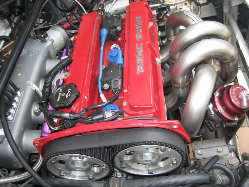

very nice pics of the engine bay.
