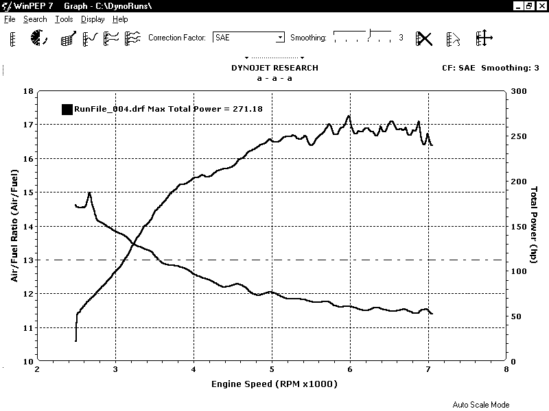

I got my car on the dyno. Here are the results. I am runing the subzero base map, with a 2.5 in test pipe. what do you think of my afr? The guy working there said it was lean between 3-5K.

its probably fairly meaningless until you look at dyno charts from other evo's on that exact same dyno with the same settings and the same conditions.

Are you reffering to the afr, hp numbers, or both?

HP probably. Shouldn't be too different than any other dynojet numbers, though.

Well, I hevent seen many subzero dyno charts, so I thought I would post mine. I was happy with the results.
Its not lean between 3-5K

Thanks for your reply, David. I feel better geting an answer from someone at Vishnu. I wasnt to sure of the people that ran the dyno. They tried to tell me that I had to get an aem standalone if I were to upgrade the cams. I guess they have never used an xede before.

That a nice improvement over stock!

What was your stock hp on that dyno?

I never had the stock car on the dyno, but some of the guys there said that stock evos were puting down around 230hp. They were suprised to see a car with a stock exhaust make that kind of power.
