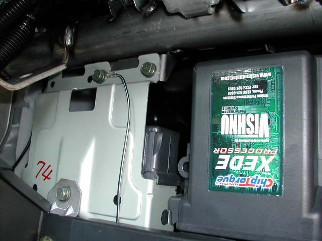

Will the piggy back system fit in the same location as the stock ECU or would I have to put it in the glove box instead? So when I get the Xede from you all I do is just plug it in with the required cables and thats it? Is it that easy or do I need to adjust some other stuff as well?

The Xede sits right next the the stock ECU behind the glove box. You just plug it in. No cutting or tapping into wires. If you want the Xede to control boost you relocated 1 wire from the ECU harness and replace it with one from the Xede harness. The install is relatively easy.
Here's where many have their Xedes located.
