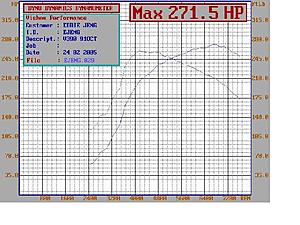

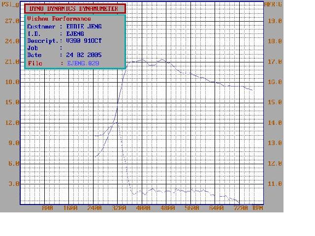

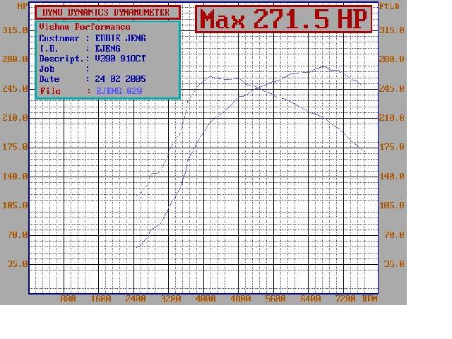

Just in case some of you out-of-staters done know what we do all day at the shop, here's a little synopsis of today's work load
02 WRX with upgraded turbo, fmic and injectors. Remove the UTEC (which was tuned by another dyno shop in AZ) and replace it with a reflash. Picked up 40whp, lots of torque and tons of drivability.
05 EV0. Installed v390 kit (cams, cam gears, downpipe, cat-back and fuel pump-- still stock cat). Tuned with v3-upgraded XEDE on 91oct. 272whp with the stock cat. Expect about 280 with free-flow cat and somewhere around 290 with test-pipe
04 STi. Installed v370 package (signature turbo back exhaust and reflashed ECU). Tuned on the dyno at 270whp and 280lb-ft of torque. Forgot to take the whp/torque graph home with me so below is only the afr/boost
