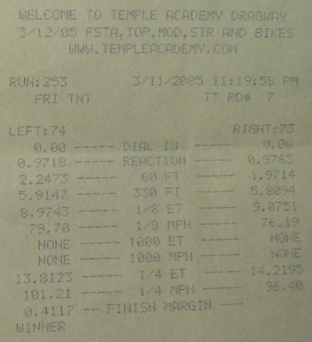

I wanted to ask these question in this part of the forum because I want to tune my Evo with Vishnu in the future and trust Vishnu performance.
I went to the track Friday night, it was my first time. After a few bad launches I got the hang of it with some decent reaction times. I am adding the pics of the slips. I am 73 and I am racing my buddy(74) in his stock 05 GSR. as you can see i beat him off the line and to 60ft, and once to 330ft. but after that he just drives right away from me.
I build boost at the start and launch at around 5500. I'm not missing any shifts or shifting slowly. My intercooler sprayer is not working, I have an aftermarket uic piping, a cone intake. no ecu tune.
Just looking for some feedback as to anyone's thought on what the problem is. I really feel with those RT/ 60ft times I should still be able to touch the 13's.
Is the lack of water sprayer and cone intake with no tune having that much of an effect?
I bought the car used with 23,000 miles and i am fresh of a complete fluid change that i did myself.
Thanks for any help
David

sorry for the bad pics i should have checked them, here are some new ones

I do understand that the 05 evo's have more hp/ft lb, but even though shouldn't i be able to touch 13's. i was running chevron 93 octane half a tank w/nos octane booster.

those are really low trap speeds man. Something is up with your car. do you have a boost gauge? if not, GET ONE. and put your stock air box back in if you have one.

No i'm not 73 haha. Yes i do have the stock mitsu crappy gauges and they are reading wrong thinking i have a leak. My boost gauges is reading at .8km/cm2 which i believe translates into 11psi. which i know isnt right because then i'd prolly run in the 15's. I am currently working a deal with another member for his old stock box and all parts for $50 shipped. I bought the car used with this cone filter and no piece of the stock assembly left behind. that would be funny if a 73 year old guy owned and dragged an evo though huh
