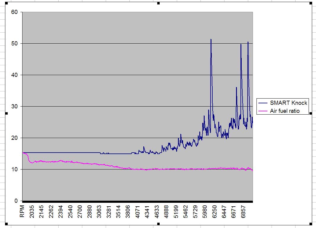

Here are my crazy *** graphs
I have yet to get rid of this knock. I dont have a single datalog without it.
What do i need to do? you can see my AFRs arent crazy, even on the rich side. I've tried pulling out some timing, maybe just not enough. The knock moves around RPM ranges too. Maybe i have too much boost?

How much boost? What gas?
Can you post your exact set up (including mods, base map, and octane)?

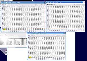

91 octane, pretty much always 76.
As for maps, I ran the 03-04 basemaps converted to smart for awhile, but tuned the fuel maps myself. This run should have been on a 05 map from the boards here, the only one that vishnu had given out before they updated their website. that map was rich on my car too and i leaned it out bit by bit, but still not enough. I have been tuning my own maps. mostly just leaning out afrs bit by bit, and removing timing bit by bit in the affected RPM ranges. I think i've just been making too small of changes.
As for boost, this is an 05 MR without the passive emulator. It hits 1.5 bar on the stock mitsu gauge. 100% on the upper rpms in smart boost.
as for mods, this run may have been with an AEM intake and a Type-RS BOV. Hold off on giving me crap for that, they will probably be coming off soon. AND YES, datalogs from before the intake/bov install are very similar, including the knock events. Only difference i can tell is that since the intake install i have lost a bit of boost according to the mitsu gauge (1.4 bar now or so) but the gauge also reads just below 0 when off, so the gauge may be off a bit. new Defi gauges coming soon.
so, aside from removing the intake and bov, anything else you would recommend? in two days i'll have a full turboback and go on to the stage 1 v360 map. hopefully that is closer to what i need.

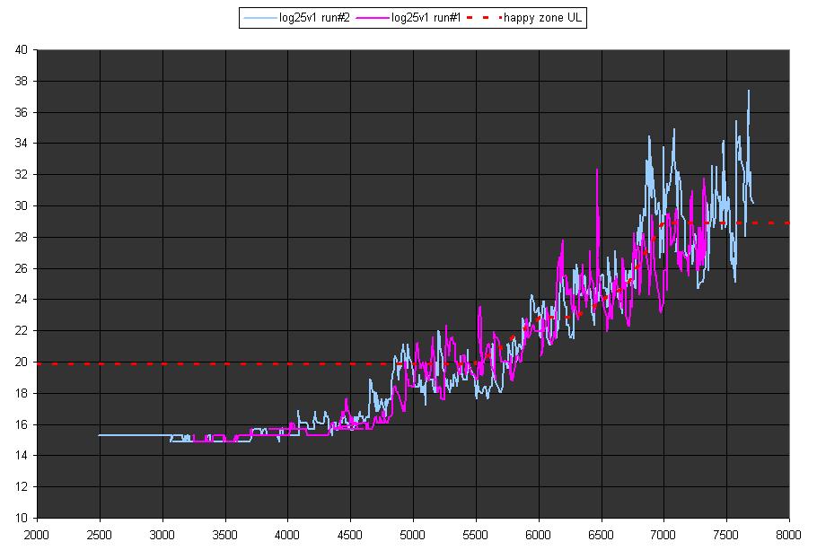

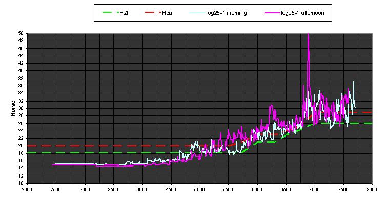

More logs from today, used strategy that Ludi mentions and took out timing in the knock prone areas.
first graph the 2 logs where done on the same stretch of road in the AM today.
On second graph is comparing second AM run with one late afternoon today after driving in rush hour traffic, using same map.
I took out more timing but the engine felt flat in the upper range
I'm at -1@5k to -2.7@7k rpm
Attached Thumbnails Engine Noise or Knock?-log-same-map1.jpg   Engine Noise or Knock?-logs-same-map2.jpg

Especially you current maps for fuel, timing, smart timing, smart fuel. You should not be getting that kind of knock activity at what looks to be about a 10.0-10.3 AFR unless the timing and boost are out of line. That being said, there do seem to be some rather knock prone Evo's out there. My theory has to do with the head casting, I have seen a picture that Propellerhead put on EvoM a while back that had HORRIBLE casting flash in the number four cylinder, but when I took my own head off it was very good all of the way across the board. The head that propellerhead aquired came off of nastea's car after he wrecked it (karma is a b!tch) and he had always had problems with knock activity. Just a theory, but your maps and boost will tell a lot...

I just saw the data you put up while I was typing, it looks like you have a lot of timing, you may try to pull some. I say this after looking at some of the base maps that Vishnu has. I am by no means a "tuner" though, so this is purely my take on things..

The new 91 oct v360 maps i will be loading have even more than that, up to -4.1@7000. so my timing may just be that far off. we'll see...
