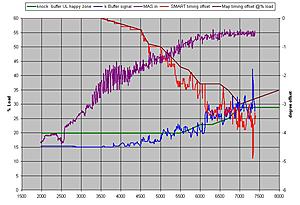

Here are my crazy *** graphs
I have yet to get rid of this knock. I dont have a single datalog without it.
What do i need to do? you can see my AFRs arent crazy, even on the rich side. I've tried pulling out some timing, maybe just not enough. The knock moves around RPM ranges too. Maybe i have too much boost?
1.) your initial knock event seems to happen at the same place where your timing goes up to -1.4 again (6300rpm). That column looks like it should be -1.6, dunno why you have it going -1.6, -1.4, -1.6... For reference purposes, my old stage1+ V2 map was at -1.7 at that point (6300 and up) - although that was for 93 Octane, not 91.
2.) When I look at the old V2 stage 1 91 Octane map, the boost map dips at 5500 rpms (looks like: 93.3, 91.4, 94.9, 96.9...). If it's not like that already, then you may want to mimick that in your map setup. Seems to me like that might be just enough to keep your turbo from overboosting on 91 craptane in the upper rpms.
I'd probably go the route of pulling out some boost (in small increments across the board) and formatting your boost map to mimick item 2 above and fix the timing map per item 1.

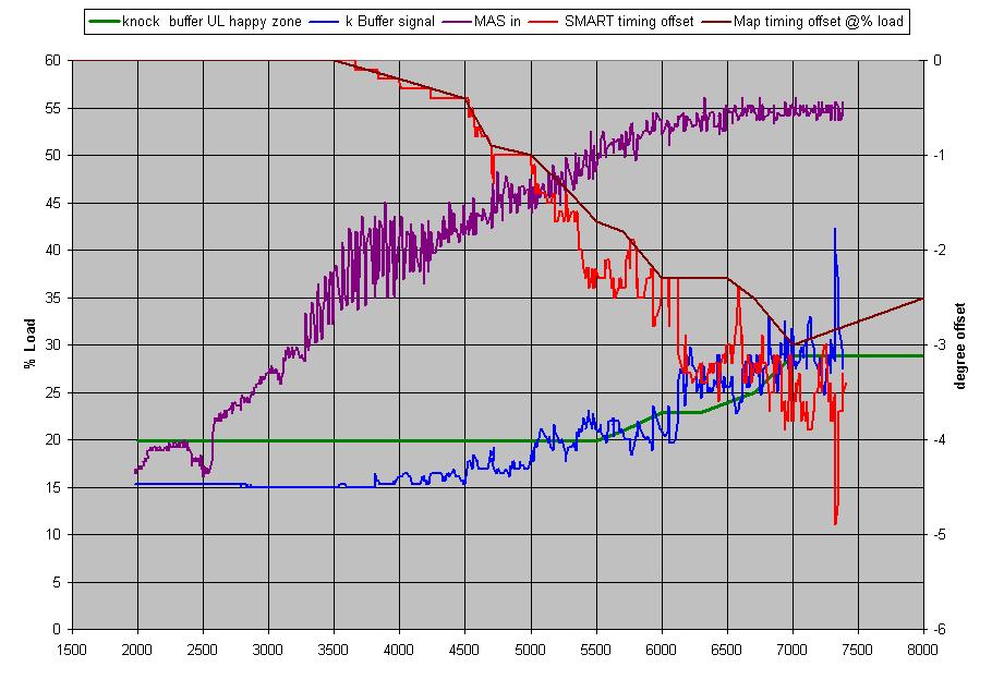

I have been datalogging with smart turned off, this weekend I turned on smart timing.(i'm a slow learner)
Looks like i have to do a better job of interpolating my timing offset after 6k rpm. but it looks like SMART works when it needs to.
Also it looks like the -2.2 smart timing offset got maxed out at the knock event that ocurred 7.3k rpm. This may well be happening to some of you guys as well. Does the range need to be increased?

Don't be afraid to yank out another 0.5-1 deg of timing above 6000rpm. 05s run very aggressive ignition curves. That coupled with 91oct and other VE-bumping mods can result in some audible high-rpm knock events. Back off a degree and see if the problem goes away. If not, dump in some 100oct as suggested, and see if it goes away. If it's STILL there, what you are hearing is normal engine noise.
