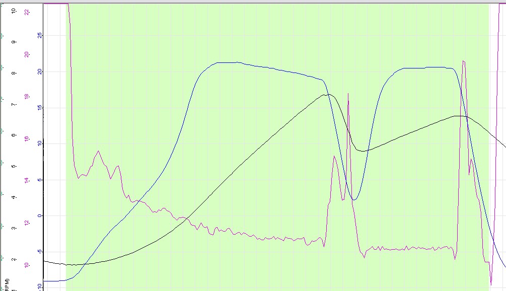

Finally got the LMA-3 and LC-1 hooked up at it works awesome. now I can correlate w/rpm logs from the xede (commslog6)and from the LC-1 using logworks. The LMA-3 has a built in 3bar map sensor.
AFR from LC-1 vs XEDE output converted to AFR=((22.39-7.35)*AN1/255)+7.35
This difference is nothing to worry about since the AFR equals the 21-22 value in the SMART Fuel table.
*Note: Logworks LC-1 output is 105 data points and XEDE high speed logging(commslog6) is 805 data points. Resolution what?
