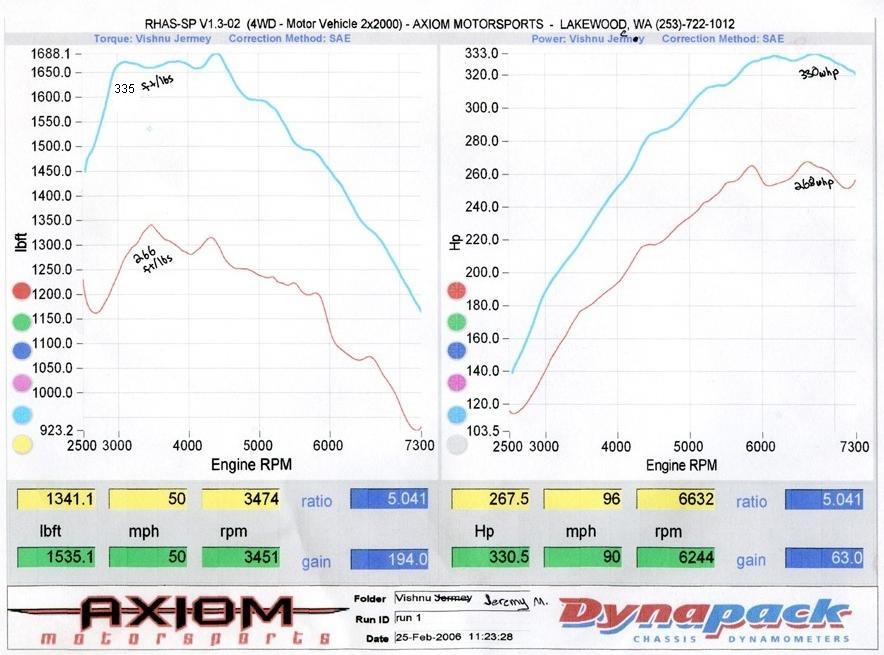

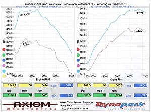

Uhhh I know for a fact the V400 is good for at least 65WHP and about the same for torque. The car is completely changed. Even faster than my Stage 1+ 03 Evo. Check dyno sheet... baseline was with exhaust already installed.
For the poster who said his stock SE was as fast as his friends V380 IX, there has to be something wrong with his friends car.
Best $750 I ever gave Shiv =)

I believe that it was installed by Shiv himself, and it's been running this way since it was done. I don't know if they took it for a test drive afterwards.
Is that your dyno? Is that the same flash with the same maps that is used for a car that is stock?
EDIT: Btw, you do know that a substantial part of the gain is from the removal of the pill in the vacuum line which increases boost by ~2psi. I can tell you from my car, removing the pill probably gives the biggest gains.
It would be interesting to see a dyno of the following:
1) Completely stock
2) With flash
3) With flash and pill removal
4) With flash and passive boost emulator
