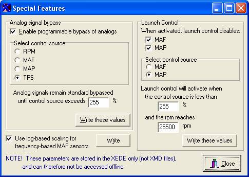

XMap v3 Beta
Still working out the functional details. But here's a look at what the new "Special Features" screen looks like :

holy ****. good thing i didn't waste all that money on a EMS huh?

damn! This xede thingamajiggy gets better every month! Do you think with the launch control feature, it will be easier on the drivetrain? So we dont go blowin' diffs?

What is launch control?

Definitely NOT. Since you have your throttle open more than you would without a stutterbox, you will let more boost into the intake manifold. I usually see around 6psi in the manifold with the stutterbox on and the throttle wide open. If I turn on antilag, I get 16psi, but I've never launched like that. I get too much wheelspin as it is.
Note that you don't have to launch at wide open throttle. In fact, I'd suggest trying 1/2 throttle at first. Then adjust as needed.
