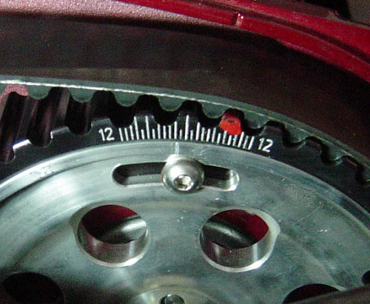

Those are the Fidanza gears. n00dle, I assume you mean those two holes are used to differentiate the different 4G63's? Judging from the pic of Vishnu's gears, it looks like the top hole is used for the Evo, and the left one would be used for older 4G63's.. I think.
Also, as for TDC, would I be able to line up the Fidanza gears exactly like the Visnhu ones as shown in this picture?

Yeah, those two small holes. From the pic it looks like the left hole with the EVO label next to it would be for the Evo.

well maybe its a vishnu design manufactured by fidanza. until vishnu had the resources to manufacture their own. i really can't remember. ask shiv. i could be wrong. the hole on the left is for the evo since they need to be 7.5* to the left of the 0*/tdc marks. this could get confusing again.
