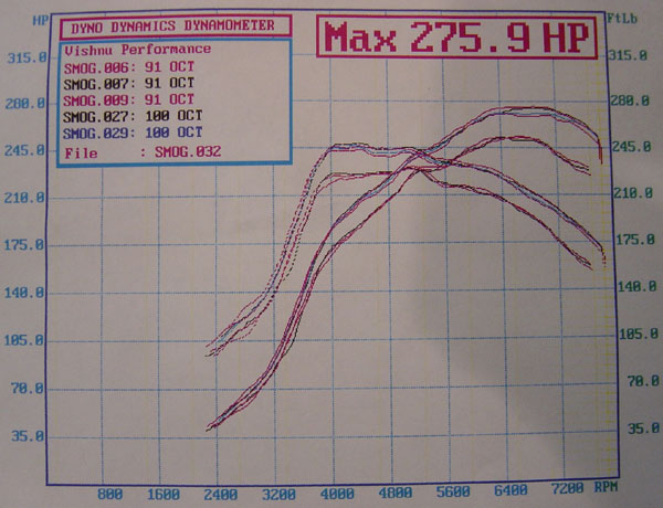

With cams, you get more power at earlier rpms. The drivability is pretty much just as good as stage 1s, but is a weeeee bit rougher. Here, take a look at my dyno pulls with the stage 1 followed by my dynoed Stage 1+ (done a few months later):
As you can see, 91 vs. 91 octane torque is 220 at 4000rpm on the Stage 1 vs. 245 at 3700rpm on the 1+. That advantage has a very big "feel" when it hits compared to the stage 1. The 1+ also makes about 35 more peak horspower than the Stage 1 when running race gas.

Nice dyno #'s Well I most likely will go with the Xede, Cams, Fuel Pump and Cam Gears. Vishnu is only a little over an hour away so thats cool for me. Does Vishnu do installs on cams etc? If so I will just take my acr there and let them do everything at once.
How often do you run race gas? I dont plan on running any most of the time, around here its pretty hard to find. If I could get some decent #'s with 91 I would be very happy
