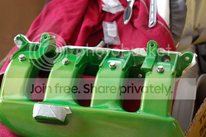

If inlet tract cooling and even cylinder distribution is important, then placong the jet as far away from the TB will achieve the result easier.
Long path promotes better induction cooling and at the same time, droplet size gets smaller as evaporation takes place.
I would rather suggest placing two jets about 6" apart soon after the intercooler for one large jet after the intercooler and four small jets for each runner for in-cylinder cooling.
If you have problems finding a hard pipe to put the jets, here are a few options:

Those solutions for installing the jet look very clean. Where can I buy those fittings? Also, if you install the nozzle near the exit of the intercooler; will some meth be recirculated through the turbo through the bov (assuming recirculated) when you shift?
