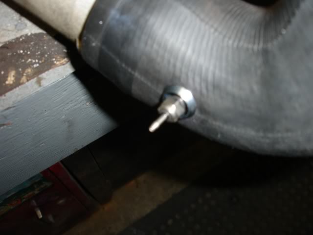

IC exit tank jet and soft pipe install

Soft pipe adapter if drilling a IC is not an option
