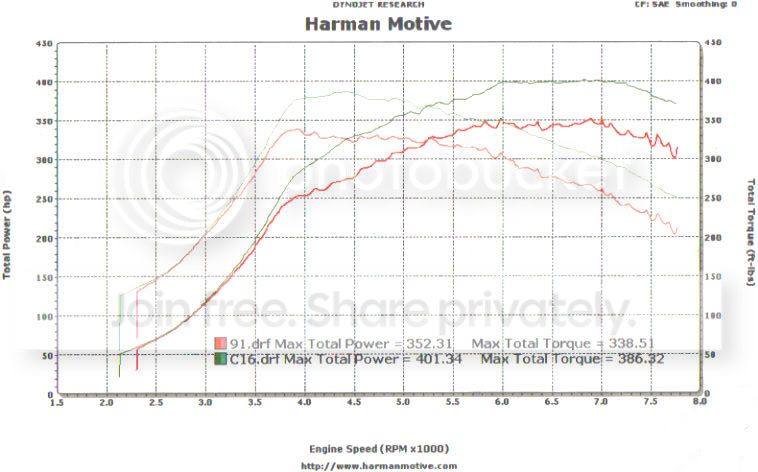

Hey Mike, the 8 turbo can take 30+ if you want it to. The problem is that the stock turbo runs out of air just about 29-32lbs. The other problem runing 30+psi is your stock wastegate. It wont hold much pressure. Heres my old graph from back in the days. It was my 91octane map on 22lbs and my c16 map on 29lbs but fell to 27 because of my stock wastegate.
