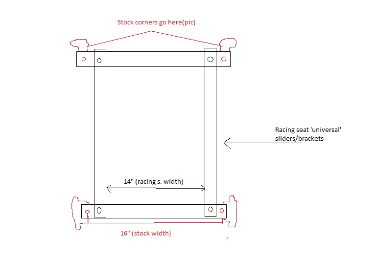

Alright so i started to make some brackets for my seats. Didnt really feel like paying 200 for brackets.
I bought two lancer seats at a junkyard for $50 and im going to buy some metal and bolts tomorrow maybe $10-15. So around $70ish for some nice homemade brackets
I cut each corner piece off the stock seats and im going to run two crossbars under the racing seats and attach the corners in the correct spot
Heres a diagram and ill probably post a how-to later with more pics
