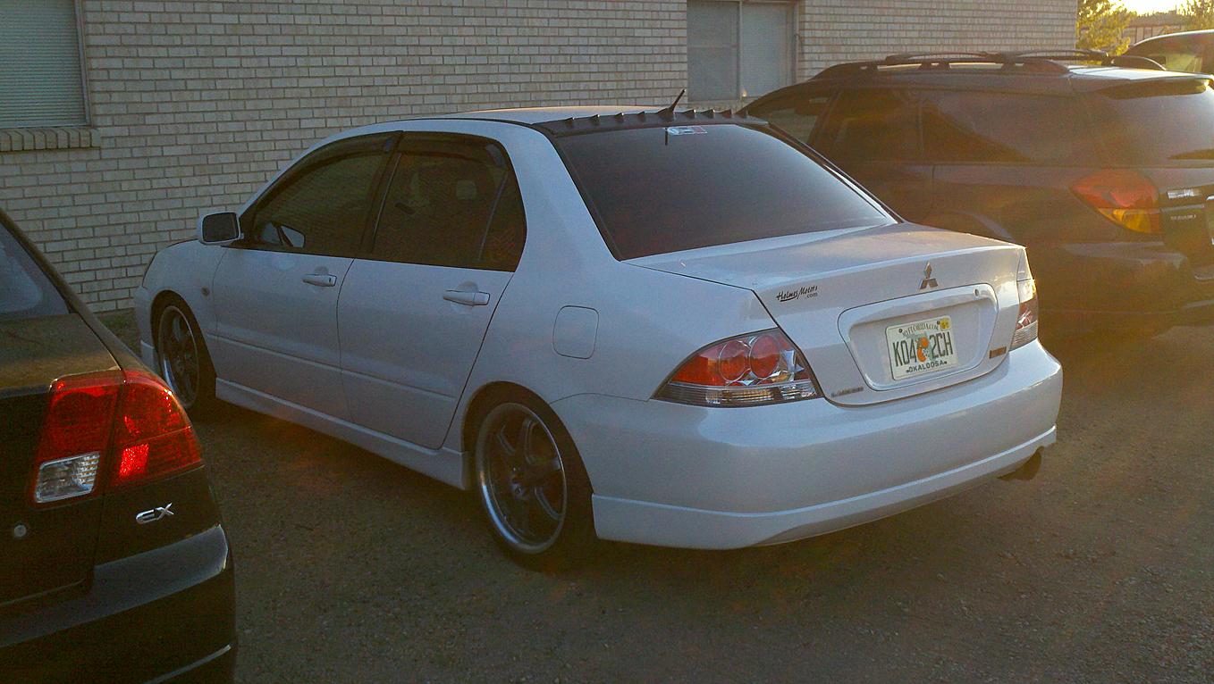

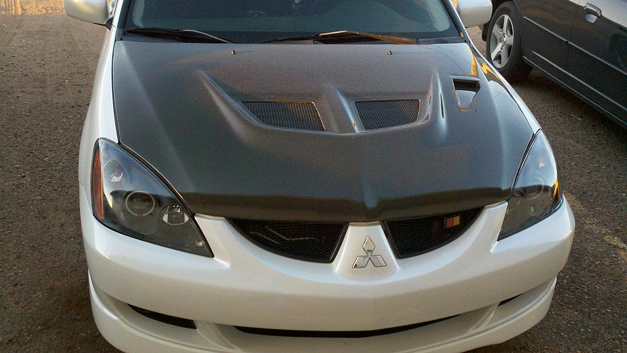

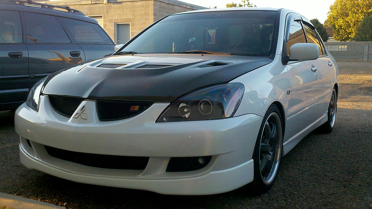

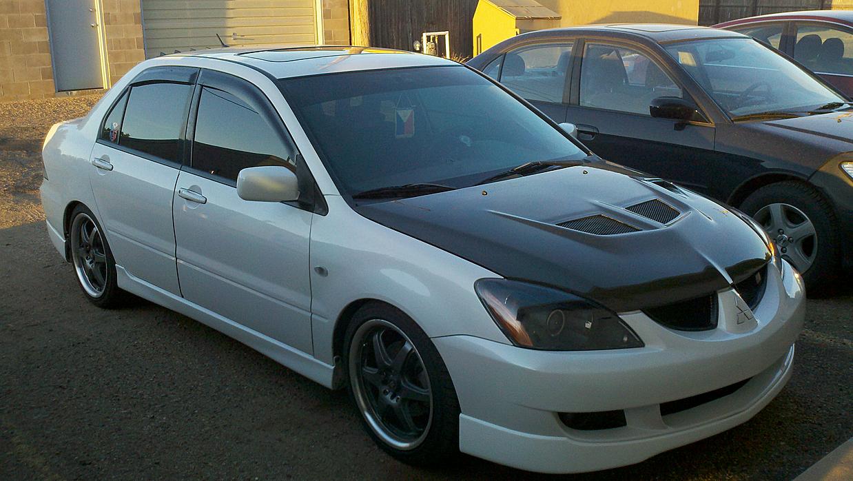

cf hood, projectors, 6000k HID's
some new ones
-Flip

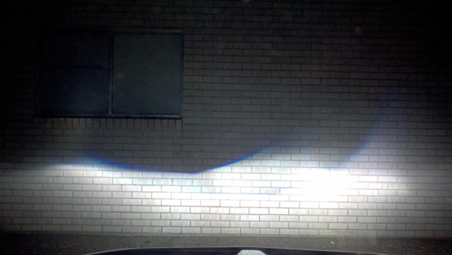

the HID pics, these are giving me a hard time. im trying to align them straight but as you can see in the pics the passenger side light is really high on the right side. and the driver side light is kinda low, and not as bright,
the way the light appears out of the projector (saying if you just had one headlight turned on) it goes low and to the left, then steadily goes higher to the right. ill try and take some pics of what im talking about later on and post them.
here are some pics.
after i installed them
after first attempt correcting the alignment, the right side isnt so high like before but still is higher then the far left side. i want to correct it because i keep lighting up houses, fences, and other cars i pass by. i feel kinda bad cause it lights up there whole inside of there car lol
if you have any ideas on how i could correct this or just let me know if this is normal.
-Flip

anyway when it comes to your projectors, thats kind of how mine look like however your right one is litle high. mine when i installed them actually lined up pretty well with each other. not really sure how to help with yours

damn, maybe just this set of projectors then? or maybe just set the right one down more. pm me a pic of your hids against a wall just so i can see if its my set or just a normal thing.

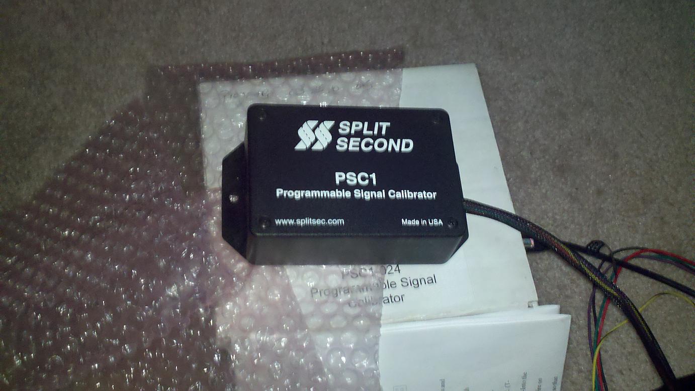

piggy came in today
just arrived today, but i dont think ill install it untill i get my header/dp combo (in the mail) and AEM CAI installed (purchasing next week), maybe a pulley( next week too prob) as well. but im excited to get it all hooked up
-Flip

As for the projectors that's the way they come. There is really nothing wrong with them they are just made to a different standard than the U.S. I'll look an see if I can find the article to help clarify what I'm saying. The _/_/ put out is normal. You can fix it but it's a bit of a pain in the ***. You would have to take the clear plastic covering off of the light and make a flat blockoff plate. Then reseal the light. Ooo that reminds me , be sire to reseal the the projectors regardless off you do this or not, they come with a very minimal amount of sealer and usually leak and then short out.
