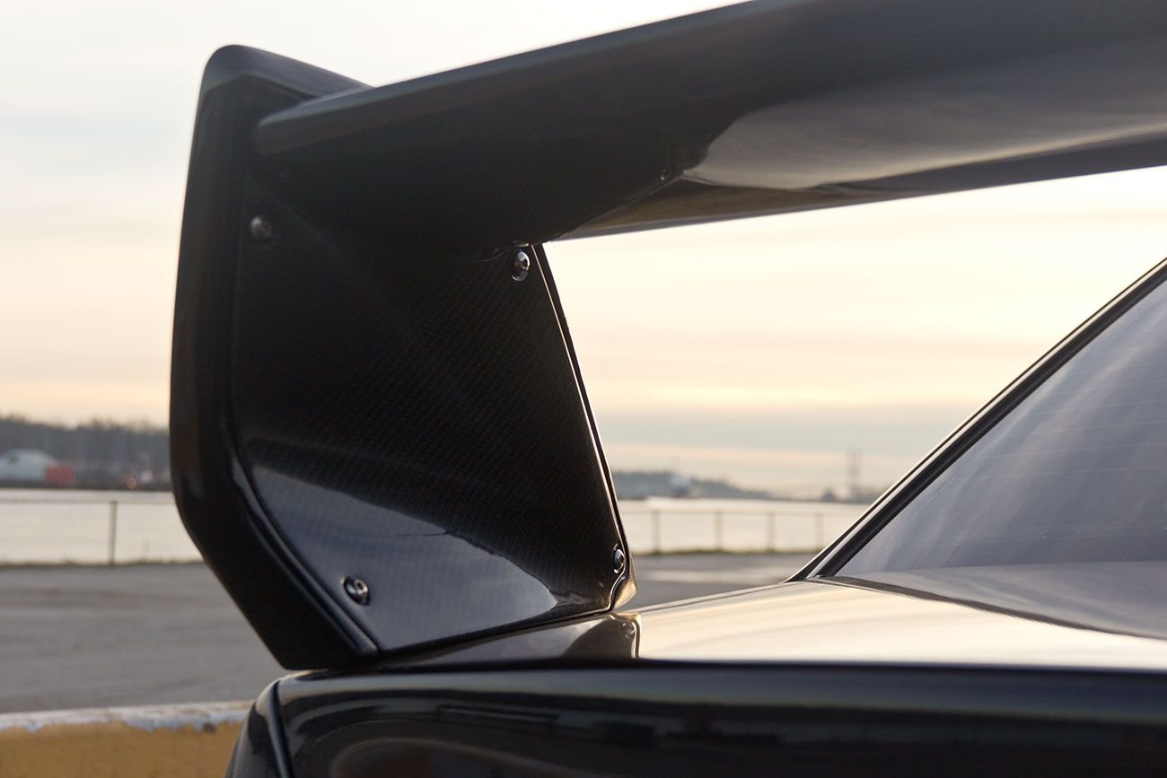

It was a sunny day out so I went out and took some photos at the local pier. Frankly, I find the car to be a bit too low since it scrapes and rubs. Anywho, I hope you all enjoy these shots!

Gorgeous! Really loving the Evo wheel and wing!

Nice to see the Evo wing on, really makes the car look that much sportier.

Thanks guys!! I had to put on the Evo wing. Imo it makes the proportions of the car look so much better.

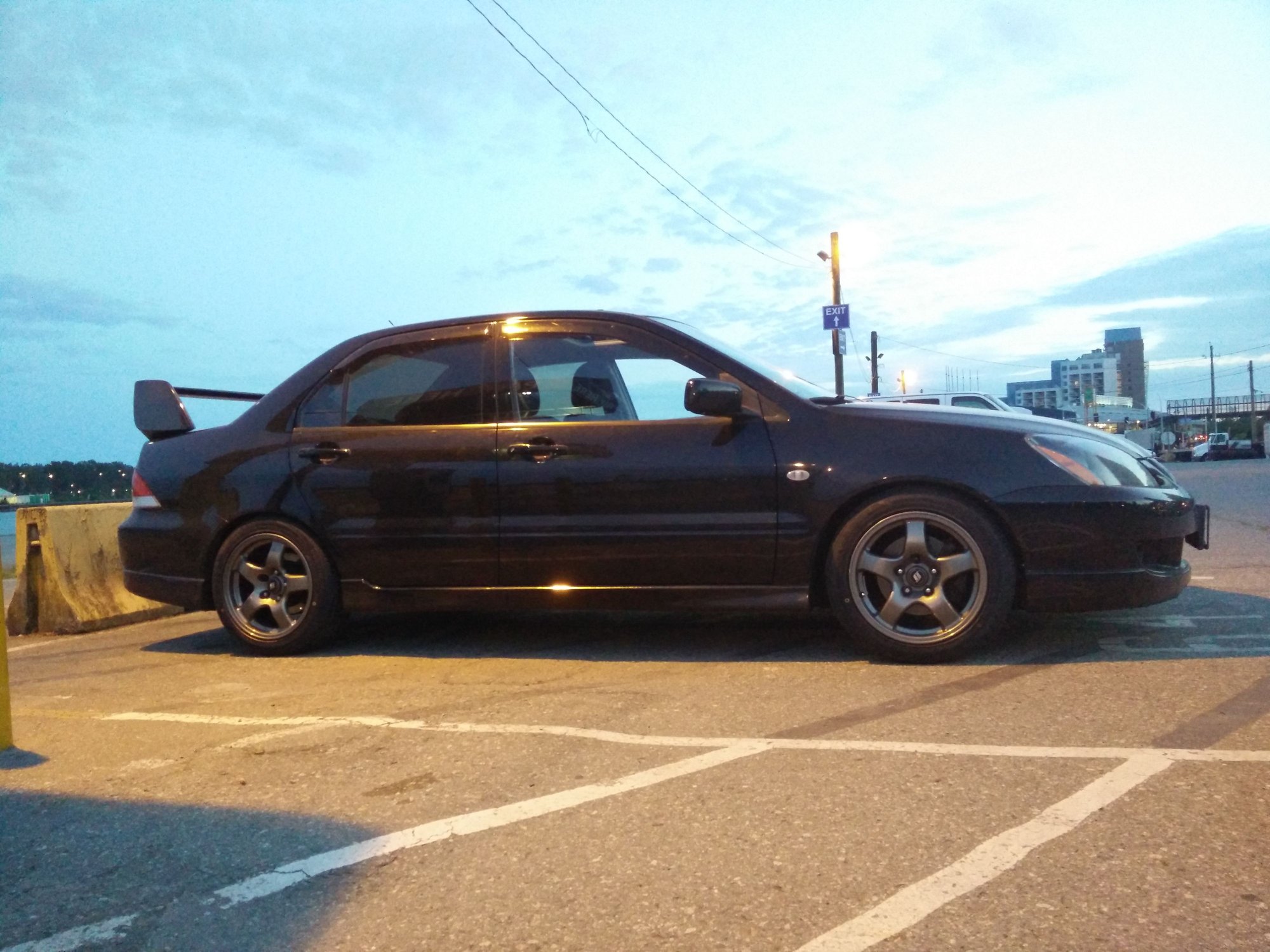

I picked up a set of Skyline R32 GTR wheels over the weekend. It was fun times rolling these wheels and tires on BC Ferries. Two rims came with 225/50/16 Yokohama S Drive tires and two were bare. Overall condition is a 7/10. There are some curbing and what not, but good deal none the less.
Just FYI, these 16x8 and weigh around 15.6 pounds per rim. 5x114.3 but centre bore is 66.1mm. Our Ralliarts have a 67.1mm hub. The front hub is smaller than 66.1mm so it is possible to fit them on, but the rears do not fit. I haven't tested whether it rubs in the front since OEM Mitsubishi lug nuts do not fit with these rims. I think I am using stock suspension settings.
Test fit time!
These rims look pretty darn good on our cars.
Front fitment. You can see that there an inch of poke.
Rear fitment. The rim is not flush against the hub, so the wheel is pushed out even more.
So the plan now is to find a set of 205/50/16 or 205/55/16 tires on Craigslist or from the States. Also, I will need to enlarge the centre bore on the rims. A local wheel shop can do it for me for $25 per.

And they are on! They are R32 GTR 16x8 wheels with centre bore enlarged from 66.1mm to 67.1mm, running Hankook Ventus V2 tires 205/50/16. I estimate that with this wheel/tire combo, I shaved off a minimum of 8 pounds per corner.
Compared to my stock wheels with 225/50/16 Continental DWS tires, this new set has less cushioning, but steering response has increased. It is much bumpier with this setup, but the car accelerates much better; perhaps it is due to the lightweight wheel/tire combo. These are my initial impressions after driving around for 10 minutes or so.
