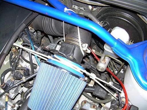

I have since switched to a short ram design, but you get the basics from that thread. If you use the stock maf sensor mount you won't have any leaks there. The short ram gives much better throttle response. I will not be going back to CAI. I will instead be running some tubing up into the engine bay and making a heat shield for my new design. DIY for that to come as well.

our maf or yours? Cutting the adapter off the stock airbox is free. If I wanted to waste my money on my car I would have bought an evo and left it stock. This is not just to make my car faster, but to make myself better. Life is about experience man, if you buy retail all of your stuff then you don't learn anything except how to turn a wrench. I am the guy who guys like you ask for help when the wrench won't turn.

Right now it's being held up with heavy duty zip ties. I did it the night before the 24hr autocross here to get my low end back. I didn't think it would be that big of a difference so I only spent 5 minutes to move the filter. If I would have known it would be such a drastic difference I would have never put the CAI on at all. My low end is so much stronger and quicker to respond now. Definitely lot's of heat soak though. Next week I go to the dyno so I think I am going to finish the intake this weekend. MORE POWER BWUHAHAHAHAHAHA!!!!!
Old Sep 13, 2006 | 10:27 AM
DangerousDan's Avatar
Posts: 4,015
From: Charlotte, NC
Chipped the paint on my strut tower brace I was in such a hurry. I did this right after my shifter bushings because I ran under my alotted time for that install. Figured I might as well do the intake since I had wanted to see the difference. Like I said, I'm glad I did.

Hey Dan did you fixed your intake or it's still hanging with zip ties???
Post a pic when you do it because i am planning the same thing but had no time to think how to prevent it to move a lot
