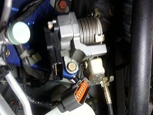

We got 2-3 customers that brings their car to the garage for that. To fix this concern, I just put some electrical grease in the connector of the app sensor. It seems like a bad contact between the pin connector. Thoses guy never come back for this after...
Is this something I can do on my own? I also need to do this but I have no idea on how to.

auto parts stores sell electrical grease.
can you do this?
I sure hope so
