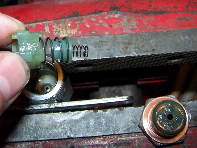

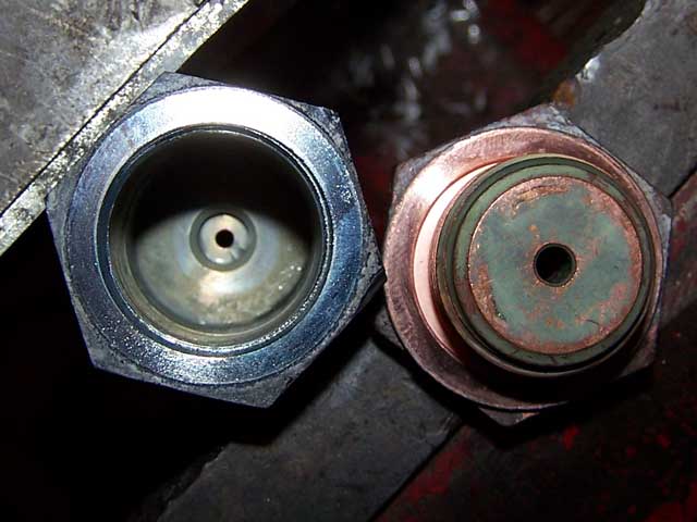

After I installed my RRM clutch line, I decided to take apart the stock restrictor and see if there's something in there you could remove to get the same effect.
Looks like there is.
I removed both fluid lines from it, and clamped it in my vise. A 27mm socket and a pretty good whack later, the copper plug end of it came loose. Inside, I found a couple plastic pieces and a couple springs.
I removed the springs and plastic bits, and washed away all the green goo (don't know what that's about ) and what's left is just a hollow cylinder with decent-sized holes on either end.
Not quite as good as the RRM braided stainless line, but much cheaper.
Carry on.
