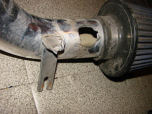

My Cai is broked, I'm from Quebec, soo what can I do ??
Our intake? What broke? Doubt it is ours.

Thumbs down
No fortunately it's not RRM's one...
I have Injen CAI ! !!
I'm soo MAD

I just know we have virtually 100% reliable intakes. INJEN and AEMs seem to break the most.
