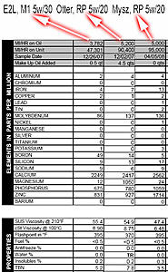

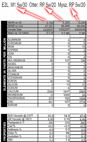

Got my results, and put them side-by-side with otter's and E2L's. I'm not sure if it was because my sample was run in winter, but after 5000 miles, mine was definitely more used up than otter's.
They still said it looked good, and that I should try again after 6000 miles.

Nice....thanks for the side by side. I am coming up on another change.....gonna try 5k miles this time and see what they say.
BTW --- I use PureOne filters...Otter uses OEM.....what does Mys use?

eclipse2lancer why does it say mitsubishi 2.3L on your oil report. shouldnt it be 2.4L

otter... just wondering why you had to add 4.5qts of make up oil over the course of 5200 miles on this oil change interval?

I didn't have to, it was an error on my part, I misunderstood the question on the original form. Between oil changes I usually have to add between .5-1 qt at various intervals.

yep...they must have mis-typed it.
Unless I got hosed with -.1 of a Liter.

I use Pure-One.
