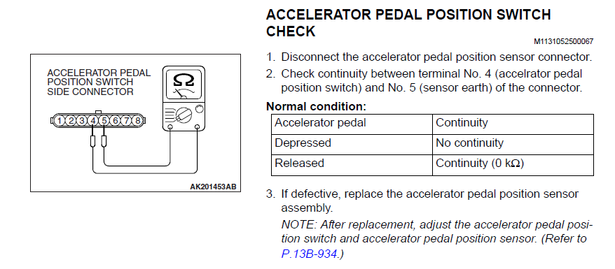

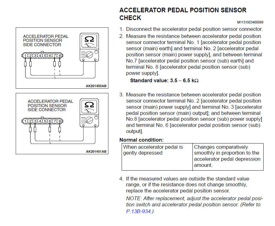

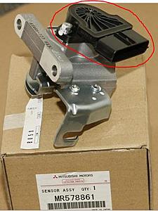

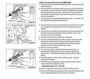

EDIT: Solved my own problem. I figured to make this thread not completely useless I will add information regarding my experience with the APPS for anyone who comes across this in the future since it seems to be such a prevalent problem across many cars and makers including ours. I will also attach the pages from the service manual in regard to installing/testing the new sensor. For reference, pin 1 on the APPS plug is the pin closest to the pavement on my car.

The part number for the new sensor is: MR578861

I installed the new sensor via the service manual guidelines and tested it. Resistance check is good. Voltage at full closed is 0.7501; voltage at full open is 4.998 - both well within spec. I did "calibrate" the sensor's rotational position using the feeler gauge and everything.

I have the shop manual and i have performed the tests and it could be the connector pin 7 of my apps harness since i have a abnormal resistance. I still have some tests to make but i hope its not the computer.
I still have to test between pin 7 of the apps harness to pin 96 of the computers harness.

17 ohm on terminal 7 to ground on the harness side of the apps
Pin 96 on the computer is ground so i still need to check the harness side of the ecm
