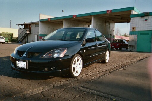

Alright for those who care, I did a little more homework and tested my theory out on my car, and I found that all the lowering springs for the OZ will work just fine on the Ralliart. I bought a set of the progress springs for an OZ and installed just the front springs to see how it looks and it came out PERFECT!! The ride is perfect, and the drop is perfect! Hope that helps every one out.

first, I am not going to lower the rear of the car. I didnt lower the front to see how it would drive, I lowered the front to even the gap in my wheels. Now it looks like it should have looked stock.
second, the drop is probably a little less than 2" in the front which was about what I was hoping for.
third, the ride is still good. I am not bouncy or anything. the car still rides almost stock. I dont want to say it is EXACTLY like stock because someone else MIGHT do a mod like this and have a LITTLE different opinion. But for the most part the car drives GREAT!
Finally, I talked to Rob at Road Race before I tried this, and he said that the spring rate is a little different between the RA and the OZ. But he also said in the same breathe that when they first got their Ralliart for testing they had installed OZ springs for months and he never had anything negative to say about that setup. So far I have had them on the car for a little less than a week and I LOVE IT! Car looks and drives the way I wanted it to since I bought it.

spyderx, according to Rob, all springs that are made for the OZ Lancer WILL FIT on the Ralliart without problems. That should be the case ranging from Progress to Eibach to Drop Zone!! And I think the Progress is 1.8" drop to be specific, so to answer the alignment question, NO I dont need one. No I dont think I have ANY camber problem and no it doesnt look weird. Yes I do have a set of rear springs just sitting in my trunk. IF and this is a BIG IF there is ANY camber issue with wear on the tires, it is so minimal that I dont care. I cant see any but I know that isnt everything. As far as pics go, I would have done it already but at the last Lancer club meet at Road Race, I managed to lose my girlfriends camera. I had a TON of pics for you guys too, ranging from the rear strut tower to the MAS and intake stuff. I am going to buy a disposable camera here in about 30 min and I will take all those pics again for you.

sorry about not posting here guys. I will but I also posted pics in show and shine under "dropped?" thread. Check all of em out.
