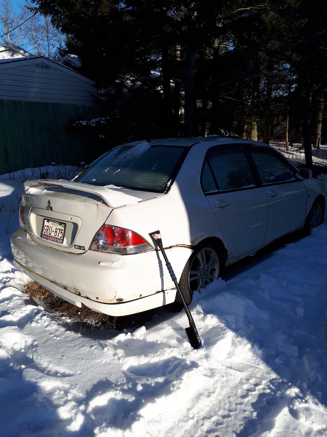

Hi all, I'm new to the forum, I recently bought myself a 2006 Ralliart 5 speed, it needs some work but for 400 dollars its worth it, I have one particular problem, my hood wont open, my friend thinks its frozen shut ( I'm Canadian and its like -35 here) but I'm positive the cable is seized, so how would one get the hood opened? my trunk latch wont move either and same with the gas door latch too....., but aside from that, its a good car
Here is some pictures of my lil project, What it needs is: A parking brake cable,Windshield,Muffler rewelded on (its a cannon ), front motor mount, starter,hole in the front right wheel well patched, front bumper, side skirt put back on, and love in genereal
