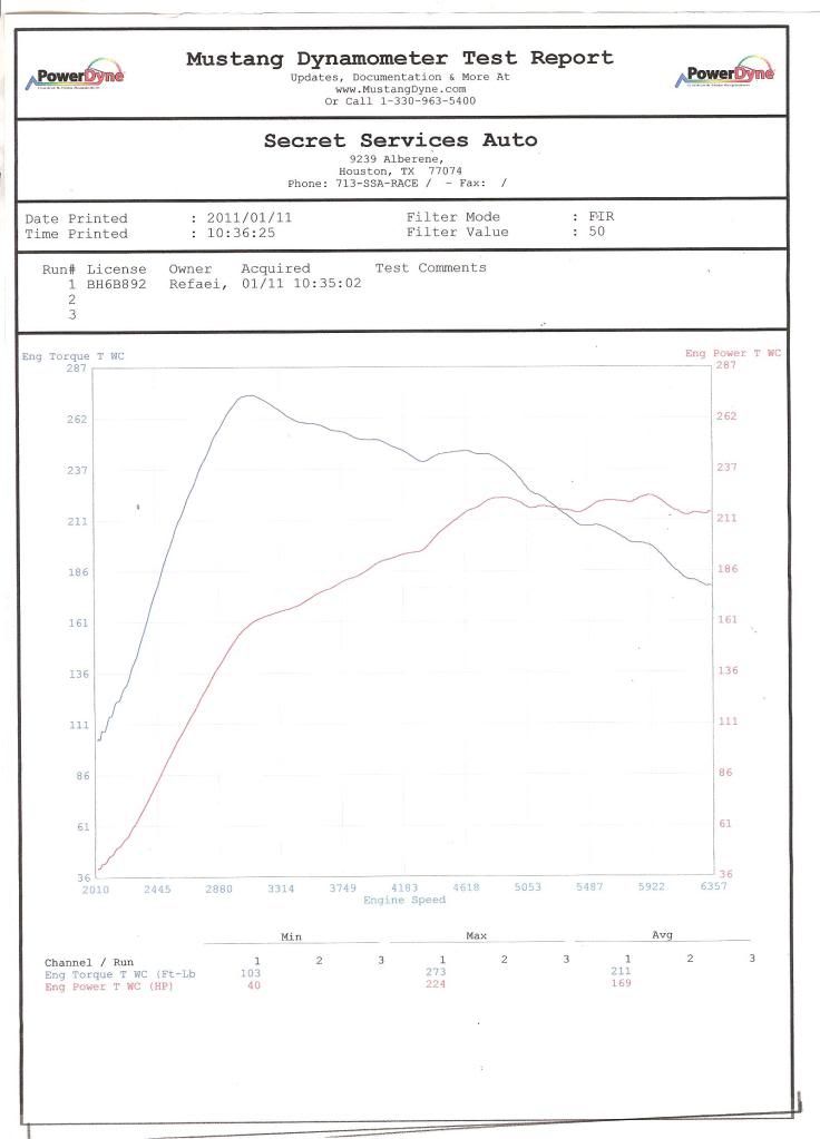

heres the sheet

Don't feel bad my evo ix only made 245/277 (mustange 4280 ft elav) lol.

I think you would feel better if you had the baseline to compare to. I think your numbers are right around where they should be at.

Like I said my stock numbers were 193 whp / 215 wtq
