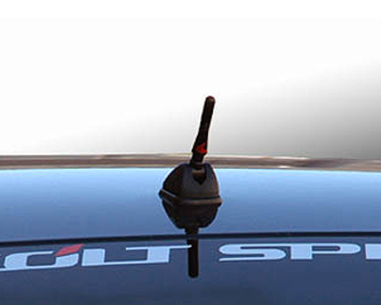

Ok kids, another update, not a big one, but it's as JDM as it gets!
Colt speed wipers and a colt speed shorty antenna>
gonna fit em right now and post pics yo
Old Oct 10, 2013 | 06:31 AM
RawrlliArt's Avatar
Joined: May 2012
Posts: 22
From: Perth, Australia
Ok heres them fitted.
I thought it needed to be screwed on more, but nope: http://image.nengun.com/catalogue/35...ro_antenna.png
