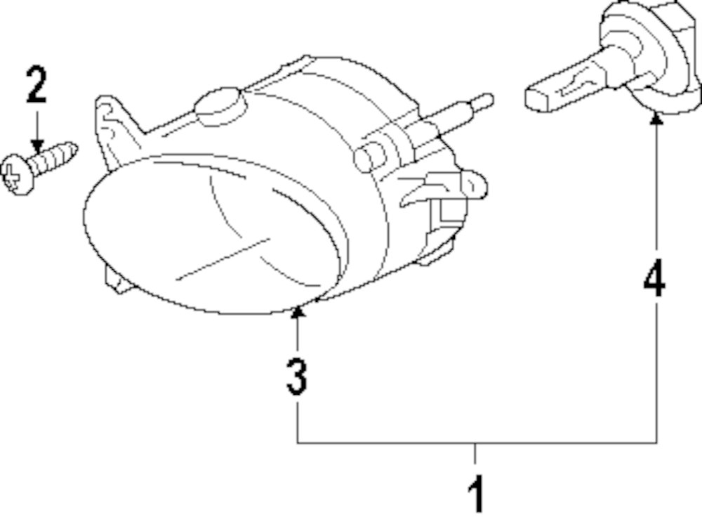

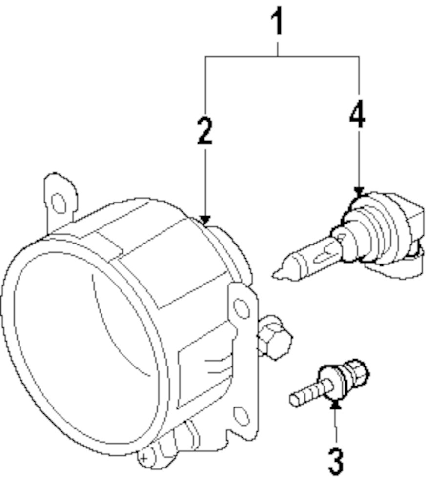

You can use foglights from just ordinary Lancers that are not evos as well.. just as long as they are from 2008 or newer. Call any "pull and safe" and ask if they have any lancers from 2008 and higher then go hunting for parts!!
They have a different black trim piece that fits in the bumper cutout, and the lens itself is actually contoured to one side.
Also the mounting screws do not line up at all.
Ordinary fog:
RA/EVO fog:
